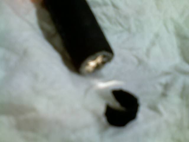

Then I drove it all day yesterday, and on my way home about 9:30pm the friggen fuel pump seemed to have went out. While I was waiting on my buddy that was using my trailer could come and get me, I made a make shift test light from one of my front fender marker lights, and checked all of my fuses and circuit's all seemed well, you could still hear the pump running, but just no fuel out of the shrader valve on the rail.  So I knew there was a problem in the tank.  I ended up pulling the bed ( I just filled the darn thing! ) tonight, and found that the Aeroquip hose I used on my sending unit crystallized and let the pump slide down.  Going to do an external pump now, don't want this issue again!

well on closer inspection, it did not "crystalize"  It seems the clamp I had on the pump side worked loose allowing the pump to slide, my assumption, is that on its way off, the pump seperated the insde of the hose apart from pressure.
I plan to put on another piece of hose and use better clamps, and try again.

yes was the high pressure hose that went between the pump and the sending unit.
I used plain old hose clamps.  Should have used my head and got Fuel Injection clamps.
