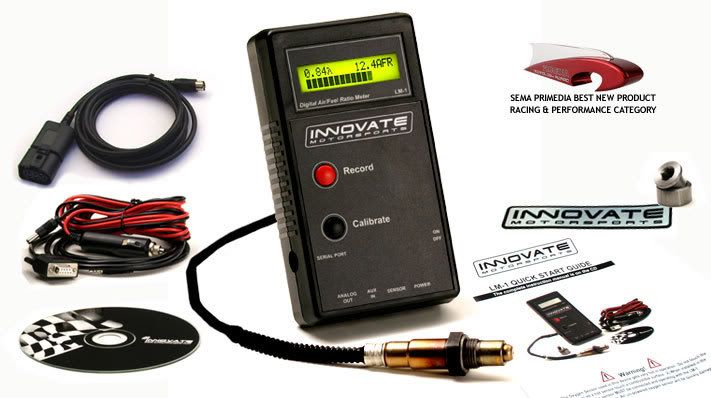

I am weak when it comes to q-jets or carburators in general.  I've read books and the subject is still clear as mud (at best).  I understand the basics.  Now for the question.  When I finish my wiring, I'll be ready to start her for the first time....  When it comes to tuning the 4bbl Q-jet can I use this wide band O2 sensor?
I used it for data logging so my local programmer can tune my chip in my Expedition.   know it can be used on carb applications, but is it really worth it?  I was considering taking the truck to a dyno to adjust it spot on.  If I can use this O2 sensor, it would save me dyno charges.

Do you have an O2 connector on the truck?
They aren't that complicated though.  If it has been rebuilt, just run the adjustment screws out 2-2.5 turns, I personally would fill the bowl with gas so it will crank, break everything in and then worry about adjusting it.  I would adjust it with a vacuum gauge and adjust it till you get the highest vacuum reading.

Thanks Chris - No I was going to weld on an O2 bung in the exhaust.
The Q-jet is a new "rebuilt" one that is supposidly set to manufacturers specs from the company that rebuilt it (I forgot the Co name - I could get it though)  I know which screw is the idle screw, but which one is the air/fuel screw?  I like the idea of using the vacuum method.

Jeff, I have/use that Innovate unit also. I find it works well. I also have Doug Roe's book, however I feel you should pick up Cliff Ruggles' Q-Jet book, it is newer & has lots of good pictures with arrows, ect. The great thing about Q-Jets is that you can tune them fairly well after a little understanding. I have my unit temporary/perminate in my truck. Going down the road, at cruise it varies just slightly between 14.5-14.8 when I'm at a steady cruise. One thing that you will find (I have discussed this with others also) you will find upon deceleration the carb goes rich. I can't make this go away & couldn't find anyone could either. I have used the Innovate on many different set-ups, Q-Jets,Holley's, tunnel ram set-ups, ect. & have found it to be a good tool, Good Luck & Have Fun, Lorne

Jeff, I'm not running any Emission stuff on mine. I just weld an O2 bung in the headpipe & screw in a plug when I'm done in most cases. I also made a 3 bolt collector welded to a  1 1/2" piece of pipe w/ a O2 sensor bung & another 3 bolt collector to insert in the exhaust system & then remove it when done. On a friend's streetrod I got a 8" long piece of 3 1/2" pipe (welded in a bung) with a swedged end to slide over the header & put the turnout back on. If you use your imagination you can check the reading without having a hole left in you pipe. Good Luck, Lorne
