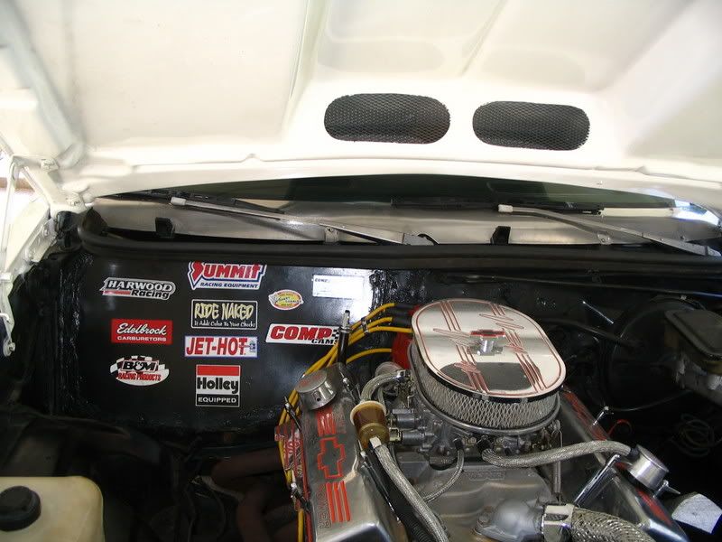

Well guys I got alot of comments on the tiny air cleaner we got thrown on our 84 to get by, and I kept mentioning another one for it, so I wanted to post a pic and see if everyone thought it be a better choice.
Now for a refresher here's what's on the truck now....
Yup, bigger is better, the more surface-area you've got to pull the intake air through the better off you'll be :)
Air restriction eats power, and that pretty little thing you've got now is going to load up *quick* :'(
I'm going with a stock-type on my '76, mostly for the thermac control, but I'm going to jump on it if I stumble across a 'tall boy' housing like the tonners or diesels have ;D

that's the one I have on my monte carlo, shown in the picture.
funny thing is I threw away one of the tall ones off an 86 k10 we had, all stock but like 4 inches tall or so.

Looks like a fat little pancake!!!! LOL.  I have the small triangle shaped cleaner on mine, its about to get replaced to.

I just replace mine to a 18inch by 5 inch ......Altho im gonna remake my hood scoop tray this summer....Fiber glass cracked..Anyways i like the other one much better..Stick the other one ware it belongs....Push mower...Weed wacker....so on lol

And these trucks have quite a bit of room underneath to the hood so a tall air cleaner should fit with no problem. A 14x3 with a K&N-type filter will flow quite a bit of air for most small blocks. If it's got something like over 400 HP, I'd go with a 4" tall filter.
I remember my 81 Jimmy with 305 2bbl had this dual-type stock filter on it. Had the usual replaceable paper filter and then a permanent smaller filter. I never figured out why it had 2 and what kind of restrictions that might have caused. Not like the weak 140 HP 305 needed a lot of filter anyway. It wasn't exactly a deep-breathing motor  lol
