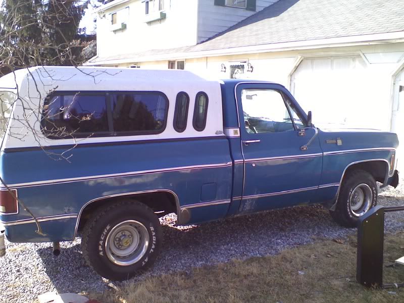

with the olds swap. converted from diesel, big headache. i was told it had a 350 and do to some unreliable opinions, got it, and found out it was an olds 260 in the thing. so it's olds crap, but i got an olds 350 to bolt up it's just gotta get cleaned and buttoned up before we drop it in.
anyone have anything like this?
i'll have better pics shortly. i ditched teh dang cap.

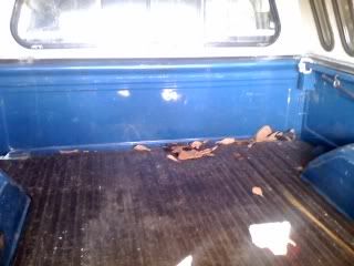

all in all, i got the truck which didn't have as bad a rust damage at everythign else i looked at, spent a buncha money trying to keep the 260 from dying, but bought the 360 that has 66k miles on it for 1400.00 total. interior's pretty mint just got some stuff on the dash pad but it's getting painted and whatnot shortly so that's all coming out...

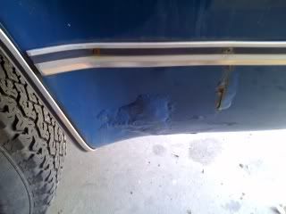

it was a nightmare. the guy i bought it from sold it to me before he physically had the title in hand from penndot. he bought it and thought he'd make a quick buck. i gave him 800 for it. then had offers up to 2k for it but been adamant about keeping it. my grandfather has a 77 in mint condition with 45k miles on it, and i want a matching one. or rather, one like it, just with my own shoot on it.
took over a month to get it, during that time that 260 was dying the whole time. left me stranded at least 3 times that i can think of, one night having to have the thing towed, the tow truck broke down as well on the way home with my truck on the back. so yeah, i'm keeping the $#*() now that it's caused me so much grief. it hardly had any rust that i could see, there's just a few spots where the paints bubbling up from probably bad rust repair but it doesn't look to be THAT serious. i just can't wait to drop in the other motor i been stalkign the mail man since wednesday. my carb was coming from ny, and shoulda only take 2 days at the most to get here...
