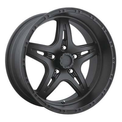

so im in on the buy of some 20" rims, preferably one of these
Rim Width (in): 9.00 in.
Backspacing (in): 4.750 in.
Offset (mm): -6.00mm
Rim Width (in): 8.50 in.
Backspacing (in): 5.671 in.
Offset (mm): +25.00mm
so will both work? im 5/6 dropped and am sure i need the right backspacing to tuck rims, any0one know what i may expect for spaces on either or both?

They should work, most people run 5"-5.5" BS. What size tire are you running? And It is best to look and do all the numbers your self be fore buying wheels..
