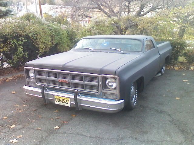

just chop it man, you wont regret it if you can complete the project. check out my bosses 79, lowered about a foot and chopped 9":
stock really sucks

Man that looks so wierd to me. Don't get me wrong, I truly admire the workmanship. It just takes some getting used to.

I think its camera angle. Mines not chopped as much though, so maybe????

Yeah, I like your's better. But, hey, whatever. That's what is great about this hobby. You guys are doing some amazing things.

chop top, how much is yours chopped and whys it look like it angles back?

« Reply #14 on: June 14, 2008, 02:44:47 pm »
