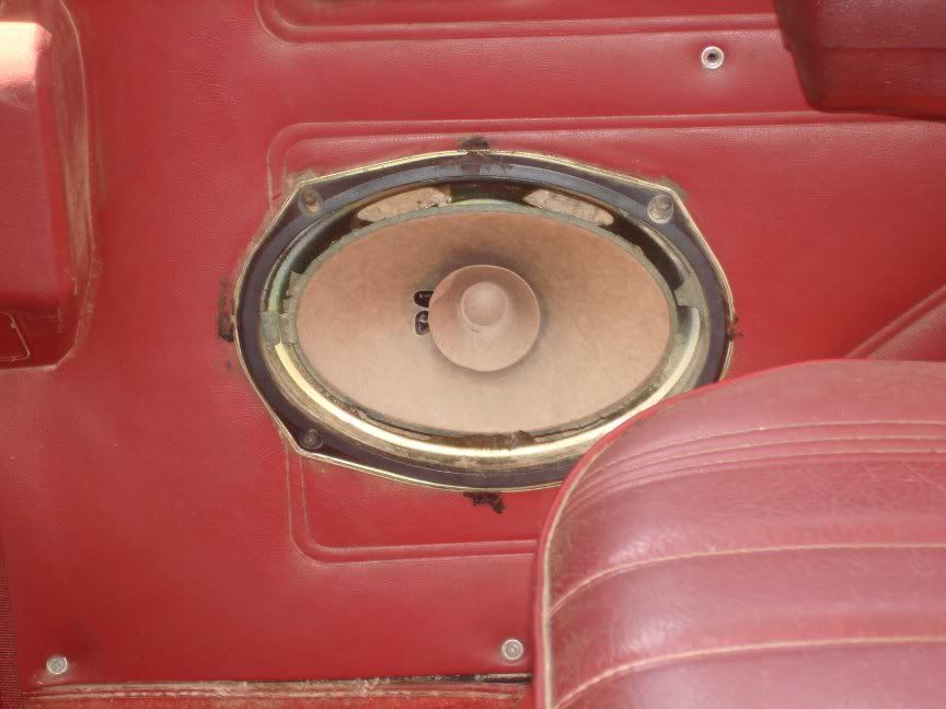

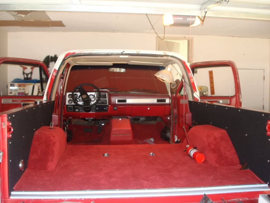

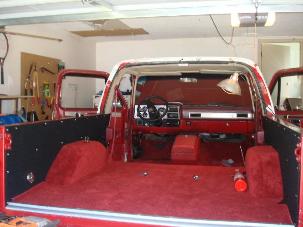

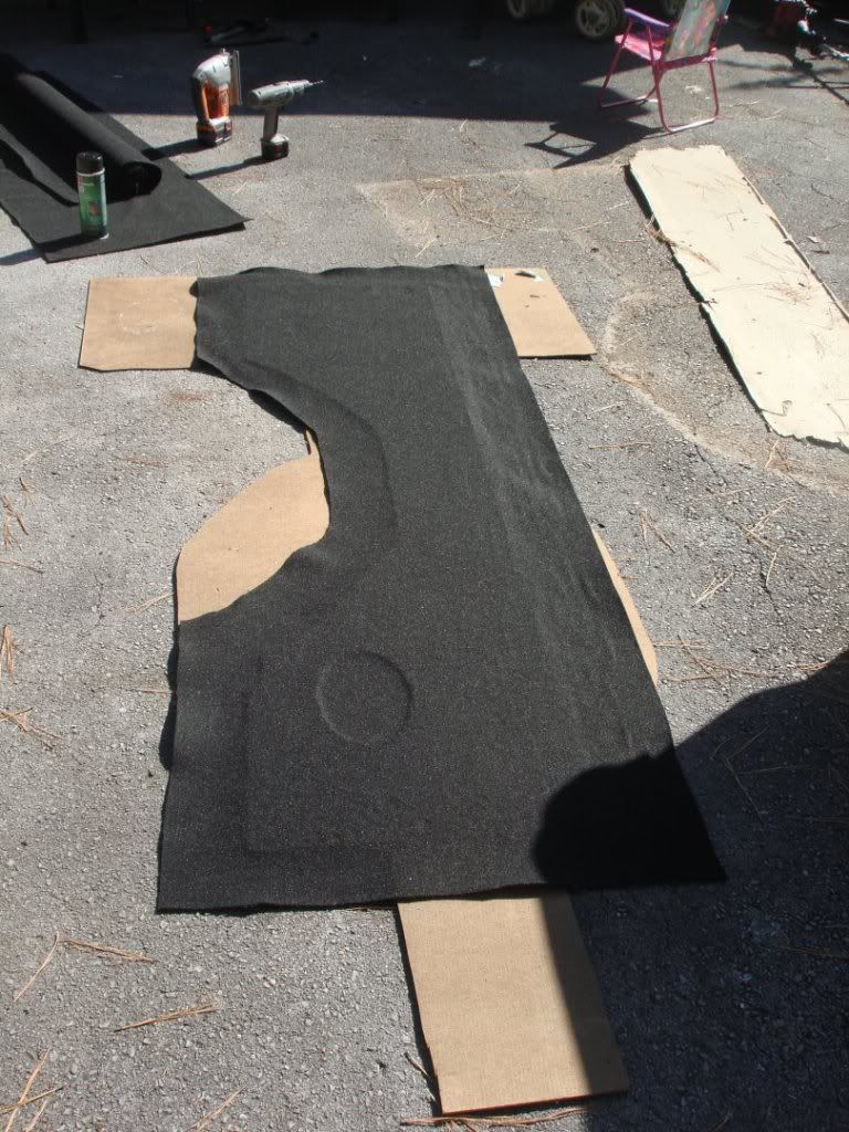

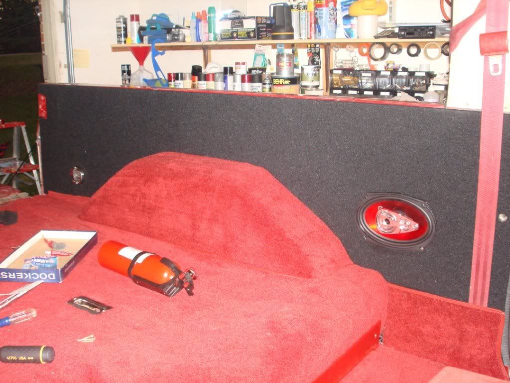

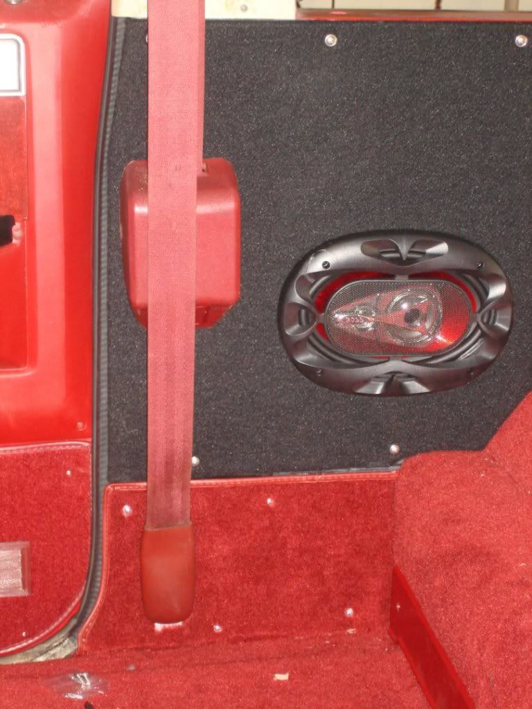

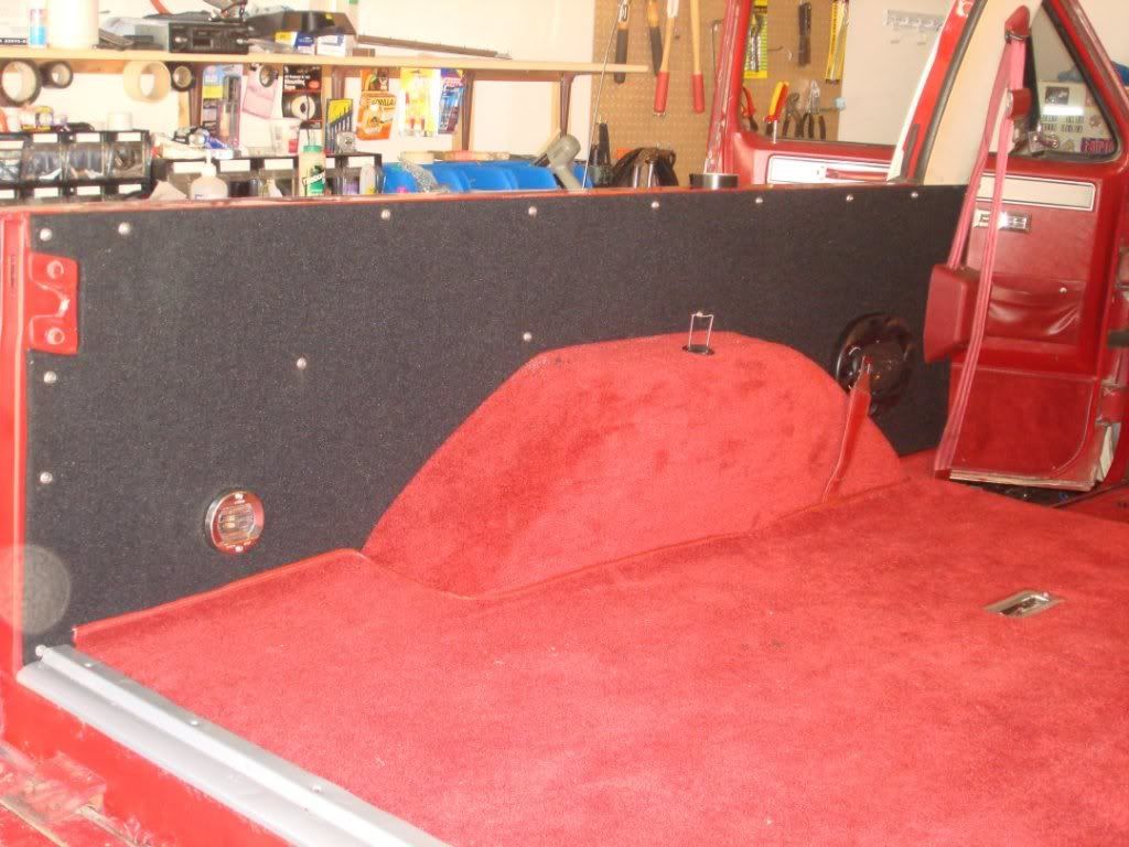

It was time to move on to making new bed side panels.  For this, I ordered some black speaker carpet/trunk liner from http://www.yourautotrim.com/black8.html  I had to have a carpet that was ultra thin.  The way the tailgate closes over that side panel on a K5 doesn't give you much room for a thick carpet.  I went with black because I figured I'd never get a red that matched the red of the ACC carpet.

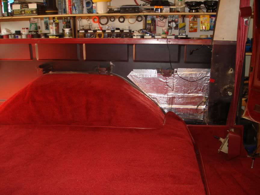

I went ahead and put some sound deadener behind where my 6x9 speakers would eventually go.

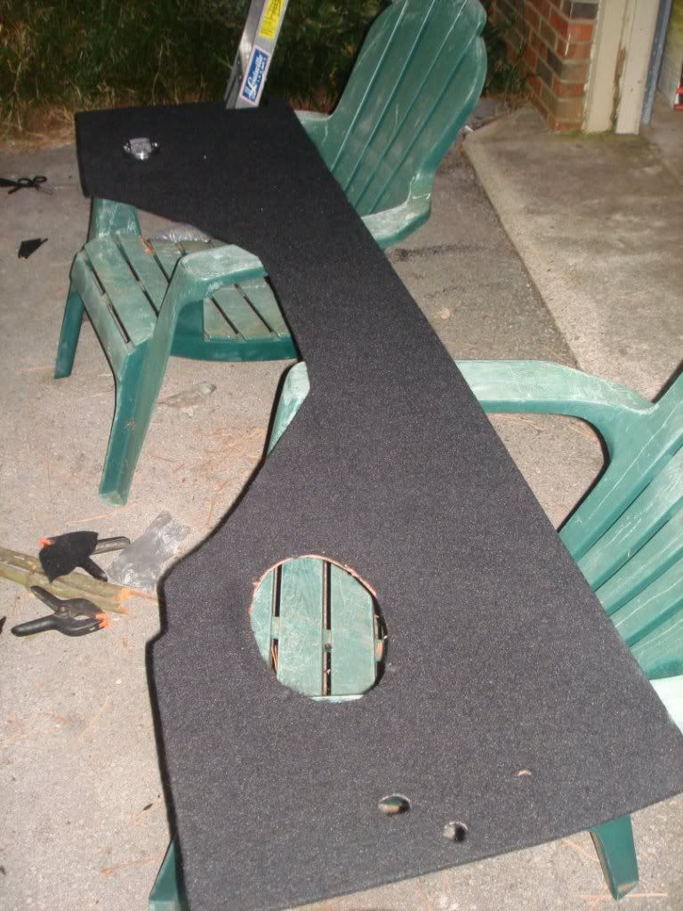

I got a sheet of thin Eucaboard and used my existing ratty panels to trace as an outline.  Then I cut the outline, trimmed it about a thousand times and made sure once the carpet was installed it was going to have the right clearance for the carpet to meet at the exact top of the bed.
I laid the panel down and sprayed it with 3M glue -- then slowly rolled the carpet out on top of it being sure to get all the wrinkles out.
Next I made sure to poke all the holes in the carpet!  That's probably the most important thing NOT to forget to do.  After I had my holes marked, I folded the extra carpet over, then glued it to the back.  For good measure I put about 400 1/4" stainless steel staples in the back of either panel -- in case the glue fails the staples should hold it forever.
I fitted the panel in the bed and it fit perfectly!

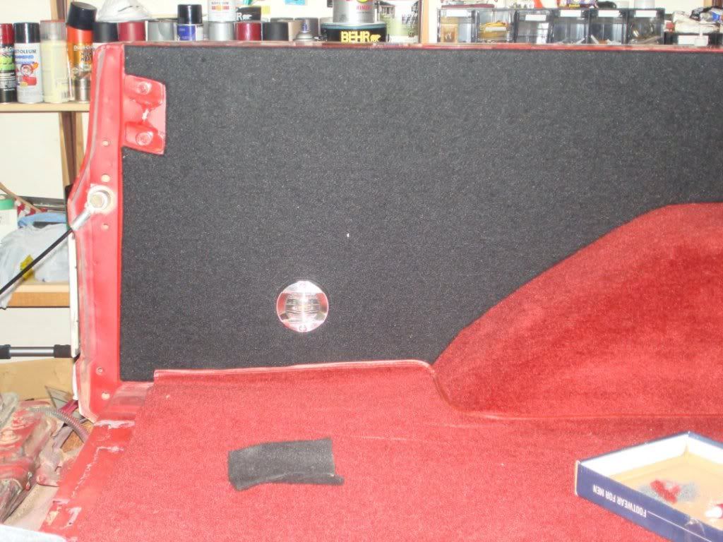

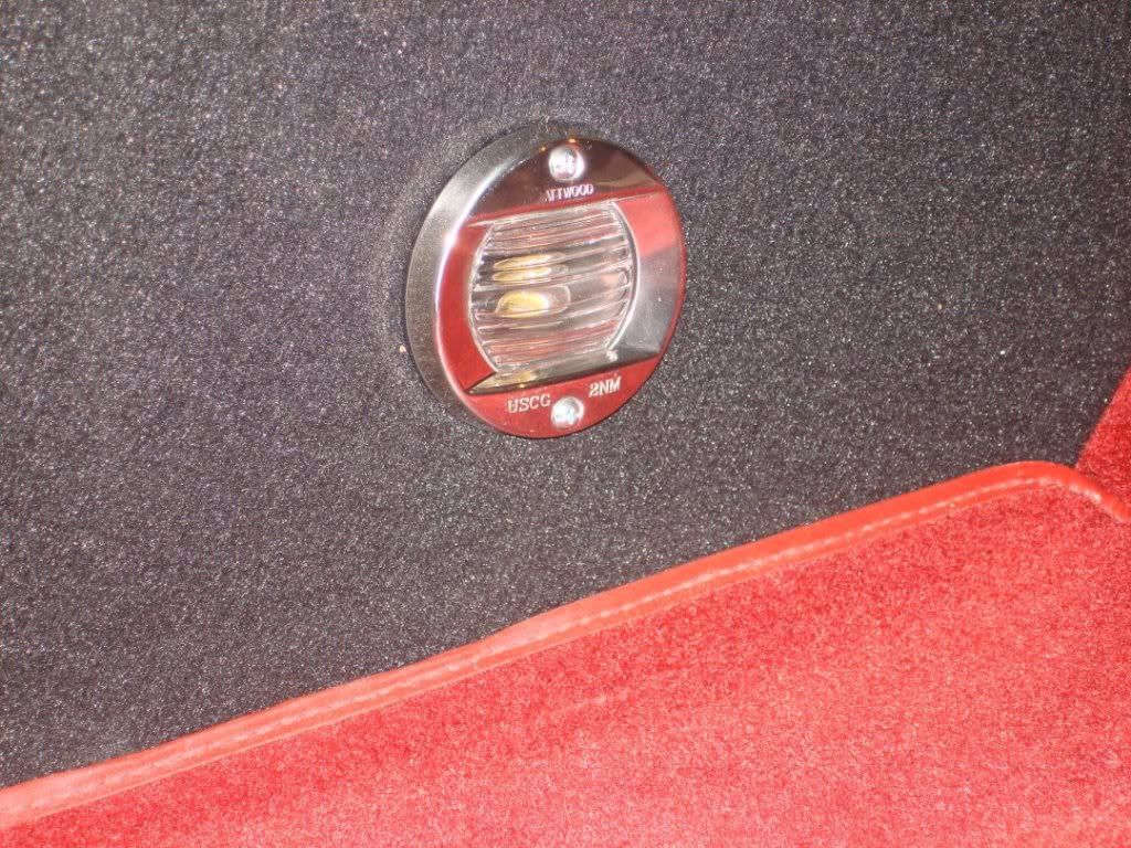

I also installed this boat light to use as a courtesy light.  I wanted to have a little extra light in the bed side I'm gonna be running it most of the time without the top on it.
Here's a close-up of the light.
So I bolted everything down using #10 finishing washers and stainless screws.

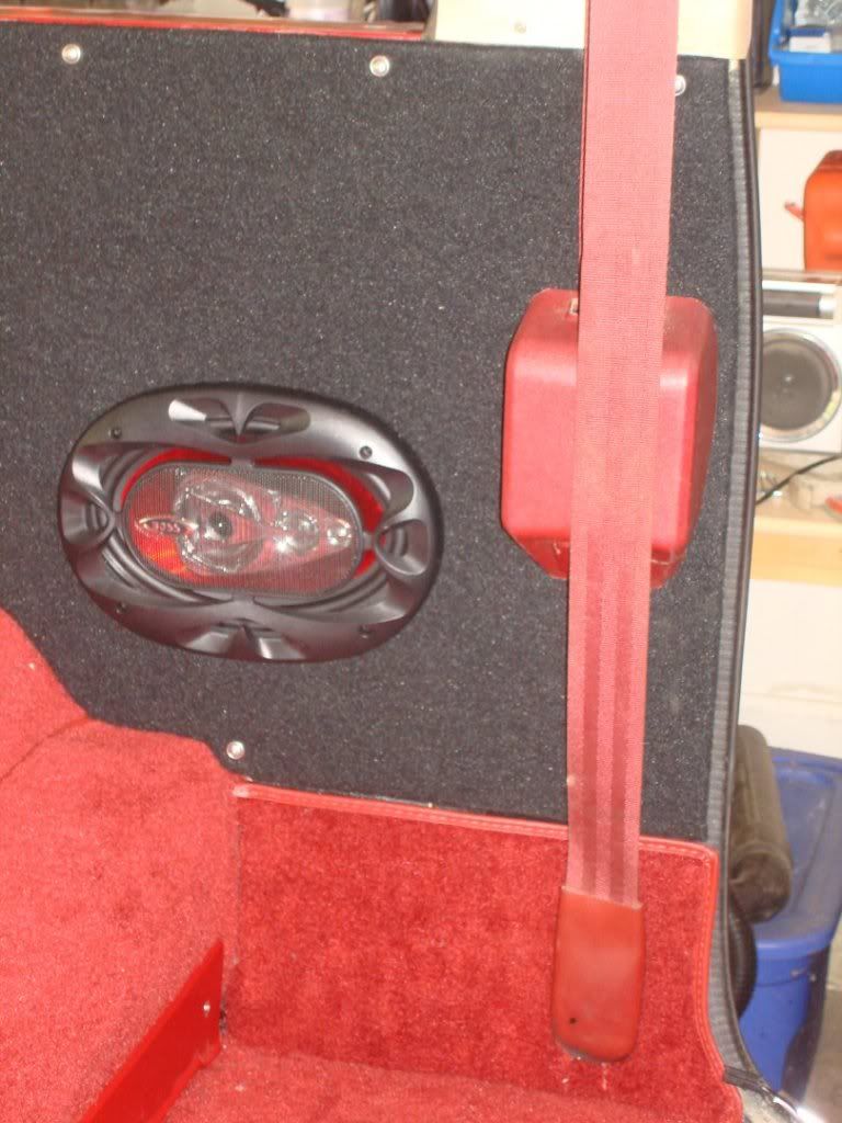

Here's how the speaker turned out.
Looks a lot better than the old rotten one!

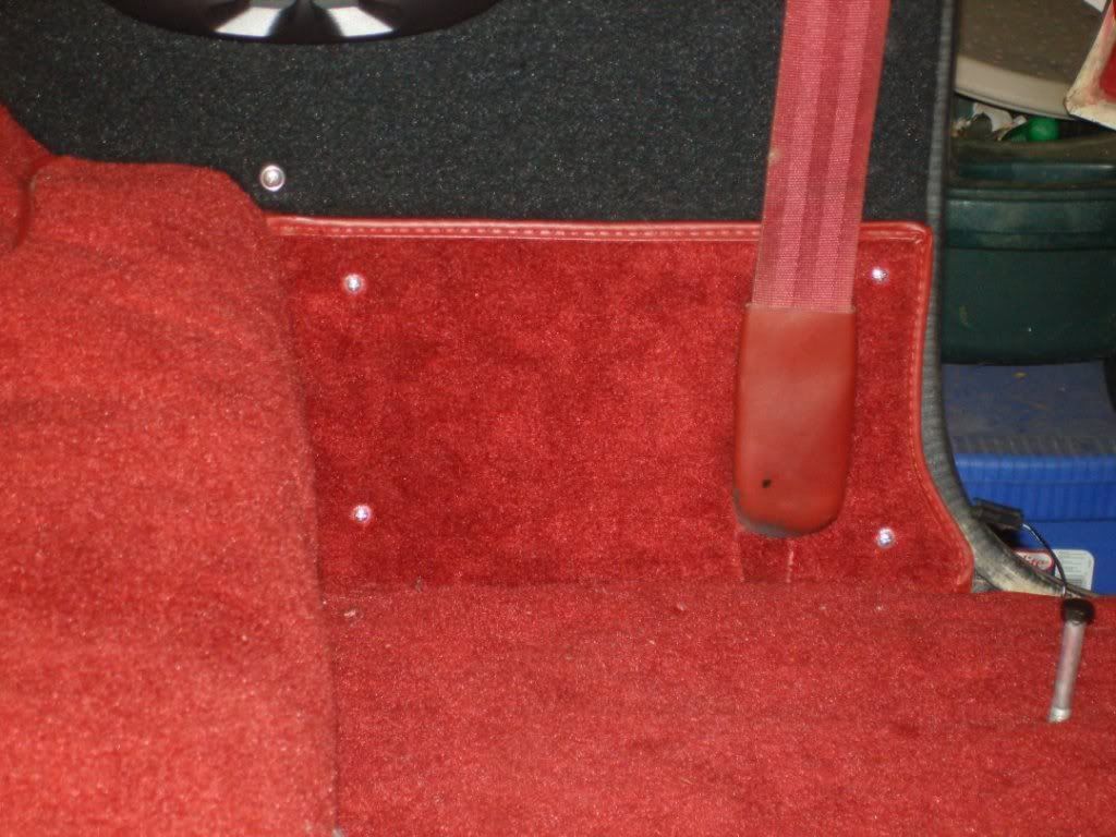

I got the small pillars installed.
Here's a better picture of the pillar.
Full view.
And another.
