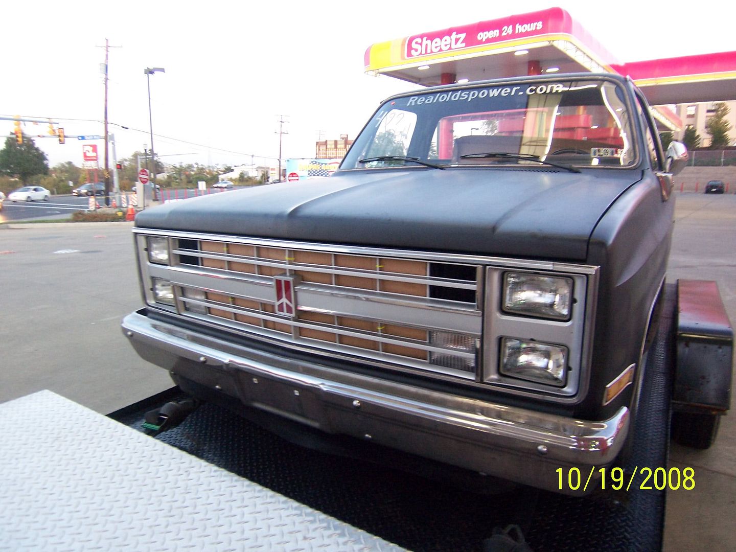

I spent Saturday & Sunday at the racetrack. One thing I tried was blocking off the grille....As close as I can tell it was good for a repeatable several hundredths & a full 1 mph. Thought I would share, Lorne

How was you cooling?
Offline HAULIN IT
  • Posts: 1542
Re: Here's One for Stewart
« Reply #2 on: October 20, 2008, 08:53:55 pm »
No problem at all, I'm sure sitting in rush hour traffic in August would be a different story ;) The track guys do a good job keeping things moving & it was cool, about 60*. My truck stays right around 160* all the time. Lorne

This is awesome!  This was actually going to be one of the next things i did, but i havent got around to it;  My main car (the cavalier) is back on line.
i think maybe you should next try the tonneau cover and possibly get a fiberglass tailgate.
Of course what would really be awesome, and, actually may be even a larger payoff for your application is to completely seal/make it flush, the underside with light gauge sheetmetal.  Since you're racing, you're probably not too concerned with drilling or welding on to the frame.  i do want to drill or weld on the frame so i'm trying to come up with some sort of clamp type system to fasten the sheetmetal to the frame.
There also appears to be a special front air dam which appears to have been available on some limited edition 73-87's, specifically the 76 models, the could also help aerodynamics.  i will try to find a link if there's time.
But yeah a grill is generally not needed for drag racing if you have a fan.  This also applies to street/strip cars when racing.

Man Lorne, That thing just looks right with that Rocketship on the Grille 8)  Looks like it would be one of the Rare Oddities I would see in Canuck Land(Hey if MercuryCA could get pickem'ups, why couldn't Oldsmobile ??? ):D
Stewy look a little closer at Lorne's Pic Bro, Looks like he already has the dam ;)
As for the '73-80's Getting them, everything I have seen, points to them being more of a Blazer/Suburban Option, but also available on the 2WD Pickups/Vans as well...   I have been wanting to add one to my '77 for a while now.....

 As for the air deflector, the one on there now is a 2wd '81up piece. I originally had a 4x4 one on it before I lowered it, then it drug on everything so I got this one. After getting used to seeing it at it's height, it's hard to believe how it sat before, a real unassuming 12.80 quarter mile ride. Lorne

NP Lorne! :D  Generally things iwll look either Doctored or Really Cheezy in Pics, but your Rocket Badge Looks Dead-on for a Factory Piece :o  My Family made a Regular Trek to CanuckLand every other weekend, from when I was 2, till I was 19.....  I always Loved seeing the Automotive Oddities that was there, and also heard Plenty of stories about the different kinds as well.....  The Kool thing was hearing all of the Oldtimers talk about their Meteors(Canadian Ford's of the 50's), and their Pontiac's.....  My Favorites were about the guys that Had either a Pontiac or a Meteor, and Various Pieces or trim was from the other manufacter(Yep Factory Installed Ford Pieces in a Pontiac, or Vice Versus)....  I absolutely Love the Canadian Acadian Beaumont's, and Canso's!  Yes they were Chevelle(Beaumont) and Nova(Canso) Bodies, with different Front Fenders,Grille, and Tail lamps, but they weren't actually Pontiac's originally......  GM wanted to Create an All New Canadian Brand(Acadian), yet it didn't think the Brand was ready to stand on it's own at the time....  So GM decided the Acadian Model line up would be sold through Canada's Pontiac Dealerships....  Eventually the Acadian Brand would fade away in the late '60's early 70's, but GM did allow the name to return in the Late '70's till the Early 90's as Pontiac's Canadian Chevette ::)

 I've got a "few" hours in the grille. I started with the space between the moldings & used an Oldsmobile hubcap to scale the length. The border is a piece of 1/4" aluminum that I cut out the four shapes (so the Red would sit flush) & polished it, then cut the red areas from a broken 2005 Impala tail lamp. I made a mold for the base from a girlscout cookie box & poured Fusor heat-set plastic repair adhesive with drywall mesh in layers from the backside. A "little" sanding, some leftover paint = One of a kind grille ;D

Back to Lorne's truck, I have that same air dam on mine. It's getting ragged though as it scapes my driveway everytime I come in or out. I like the look of it and will replace it at some point with another I'm sure.

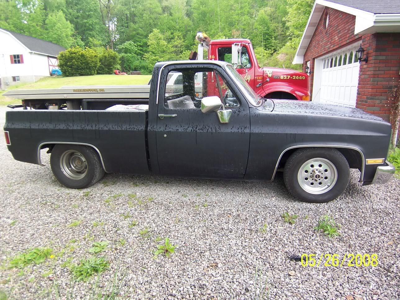

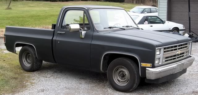

 I found a couple pictures in my photobucket. The day after I finished the body drop, I came home from work, looking at the truck (which when I left for work, thought it was still a little high in the back) comming up the driveway I thought..."That's sitting pretty right". It was RIGHT, right on the snubbers! The wife had put 18 or more 60lb bags of peetmoss & mulch in it. I ended up taking out a few bags & measuring the truck as a reference on how much more it needed lowered. :) Lorne

Great In Progress Story and Pics Btw Lorne! 8) Leave it to Wifey to come up with a way to correct the stance, without you having to change anything right away! :D
