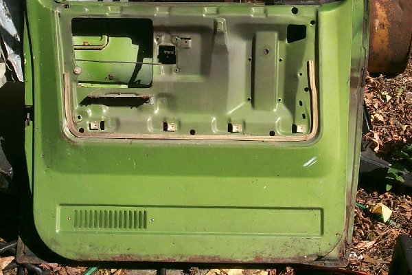

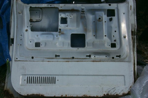

GM doors from 73-76 were not available with power windows and they have short door panels and the window cranks are shorter.  Starting in 1977 power windows and locks were available and the inner door skin was change to accomplish this.  Below are the differences in the door panels

1973-76 Front Door shells
1977-87(91)Front Door shells
This is a 73-76
This is a 77-91

1973-76 – No provision for power windows, short door panels covering only the upper portion, requires short stalk regulators.
1977-91 – Power window provisions, extra holes for mounting power regulator, full door panels with lower carpeting, long stalk regulators.

The 73-76 door panels can only be used on 73-76 doors unless you don't mind drilling new holes and filling in all the old holes.
The biggest being the large 2 at the bottom where the power motor bolts down (see above link)
