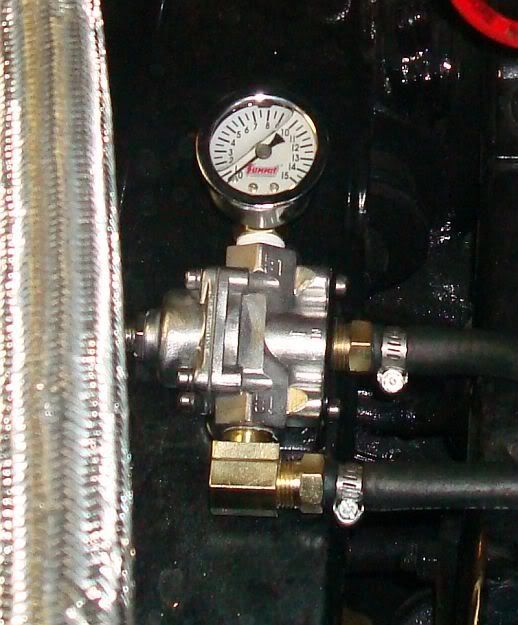

i'm running a red holley electric (97gph, 7psi) with no return line and it seems to be running pretty rich, i do smell gas sometimes so i could imagine i would benefit from hooking mine back up...
You should be running a fuel pressure regulator. Something like this

ya i've been looking for one but no one seems to carry them around here, i might have to order one off the net.
