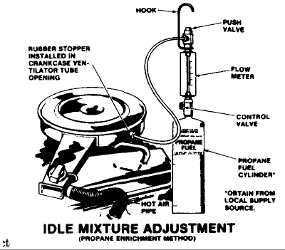

Fig. 61 - Propane Enrichment Tool Installation
NOTE: Idle mixture adjustment requires artificial propane enrichment using tool-26911 , or equivalent--Fig 61.
NOTE: Air cleaner must remain in place, and A/C control, if equipped, must be in OFF position--except where noted.
Disconnect and plug vacuum hoses as directed by Emission Control Information Label.
Connect tachometer to engine following manufacturer's instructions. Start engine and run at fast idle until it reaches normal operating temperature.
Place transmission in drive (manual transmission in neutral) and adjust curb idle speed to specifications:
On carburetors with a throttle stop solenoid, turn solenoid plunger screw.
On carburetors without a solenoid, and on models with an A/C speed-up solenoid, turn throttle stop screw on carburetor.
Disconnect crankcase ventilation (PCV) tube from air cleaner. insert hose with rubber stopper from propane valve into opening in air cleaner. NOTE: Propane cylinder must be adequately filled and remain upright during adjustment to insure correct propane flow.
Slowly open propane metering valve while observing tachometer. Continue opening valve until engine rpm begins to drop and note maximum enriched rpm.

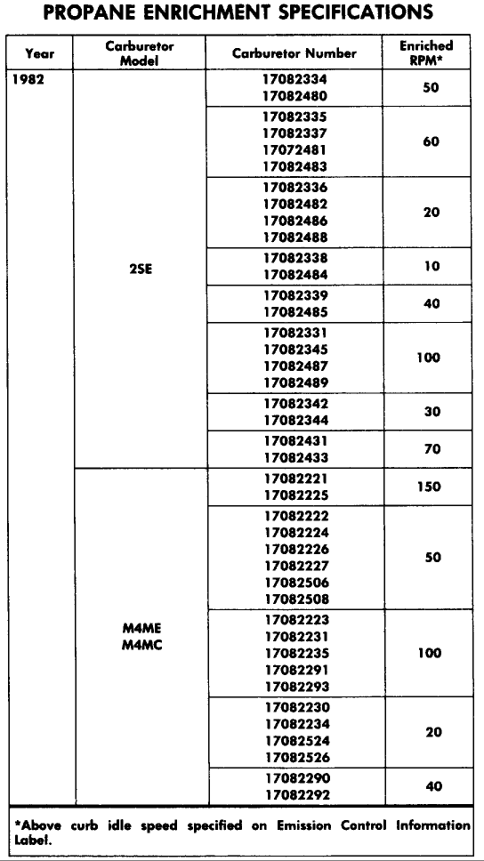

Fig. 62 - Propane Enrichment Specifications
Fig. 63 - Propane Enrichment Specifications
If enriched rpm is within specifications, Figs. 62 and 63, turn OFF propane flow and proceed to step 15.
Adjust idle speed to specified enriched rpm, Figs. 62 and 63, following procedure in step 3.
