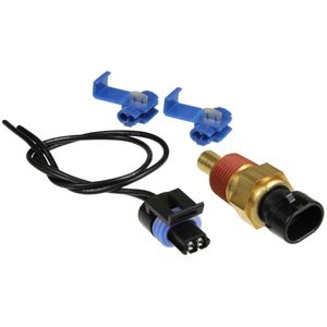

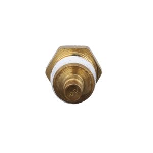

Re: Where is the tempature sensor located
« Reply #7 on: June 15, 2009, 11:53:38 pm »
like vile said the sending unit is what you need or temp switch it looks like this one
part number should be TU66  at the zone
the sensor thats for ecm looks like this one you don't need it is in the intake
