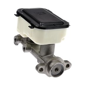

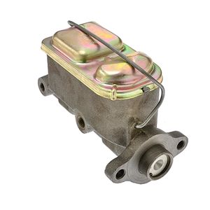

what i was getting at is if you ask a parts store probably autozone for rear shoes then there question what style breaks do you have they will give you a measurement of the rear shoes and you go by that that should tell you what style breaks you have but since you don't want to do it that way does your master cylinder look like any of these top two are for jd6 and jd6 bottom is for the 7
or you can look at the caliper not the location and angle of the break line fitting
"7"
"6"
this parts a guess but it makes sense since the style 7 seams to be the bigger style than the rear shoes should be the 13" ones while the 6 style should be the 11" ones and there are more than two diffrent styles just all that matters for this app is if its 6 or 7
