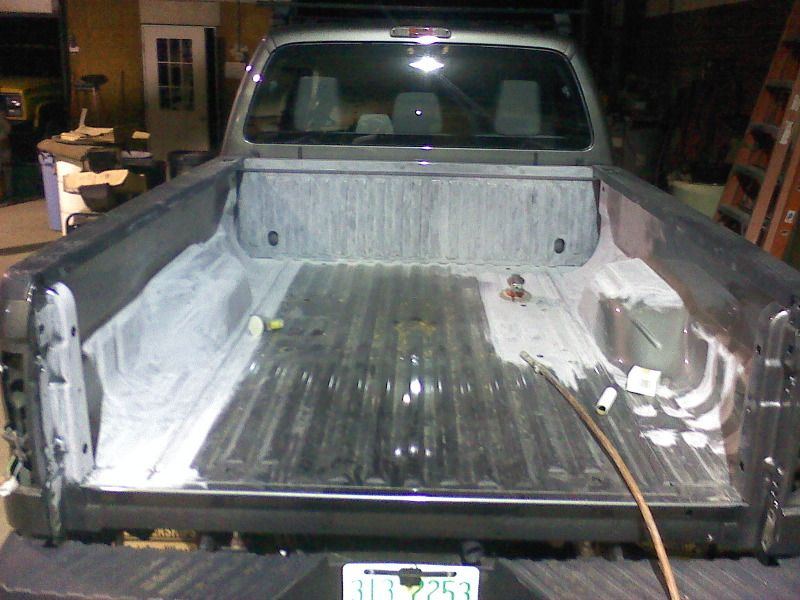

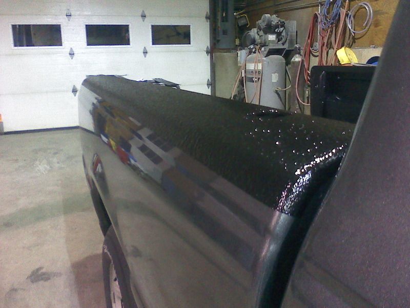

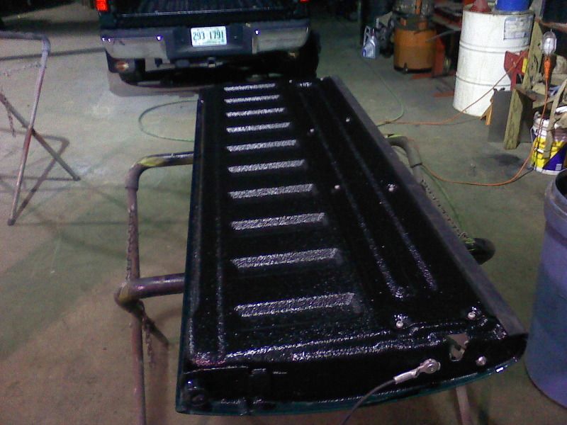

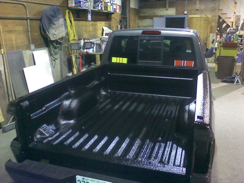

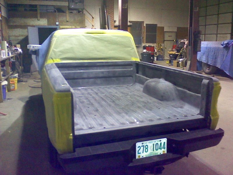

Ford Ranger with 1,200 miles on it I did this week. SEM Pro Tex bed liner.

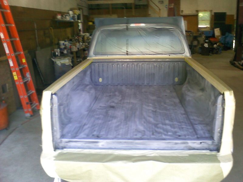

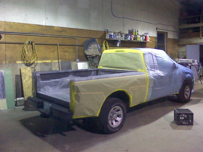

Sanded with 80 grit. Masked up, ready to spray.

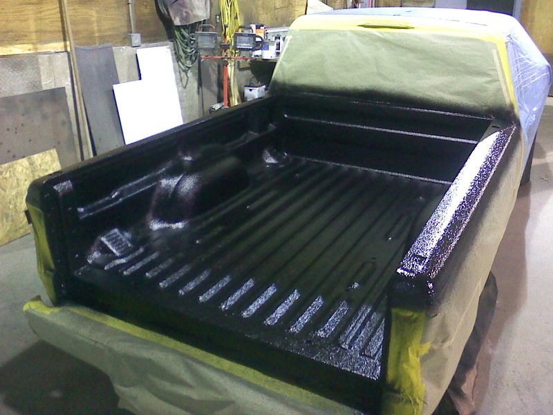

3 coats layed down.

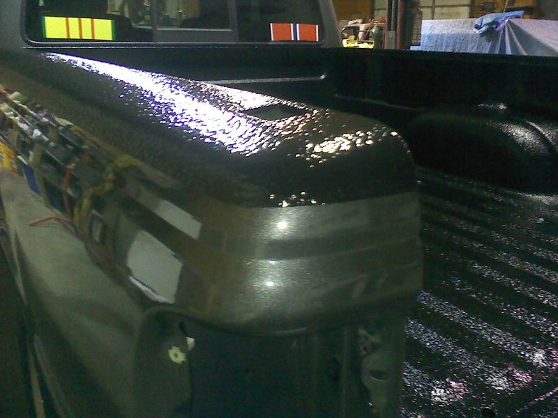

All un masked.

A gallon does a Ranger, or similar size bed very nicely. I had a little left over. Probably enough for a repair type job.
A full size 8' bed its a little skimpy.
I reduce it 5% to 10% with a urethane grade reducer. It makes it spray out alot nicer, and stretches the product a touch.
SEM bed liner products are very durable. Ive been using them for 7 or 8 years now. It has held up great on my truck. Only place it has chipped and or peeled on my truck is the very edge of the I beam, and the  D rings because of running chain through them, and dragging people out of the ditch, or being dragged out of a snow bank.
