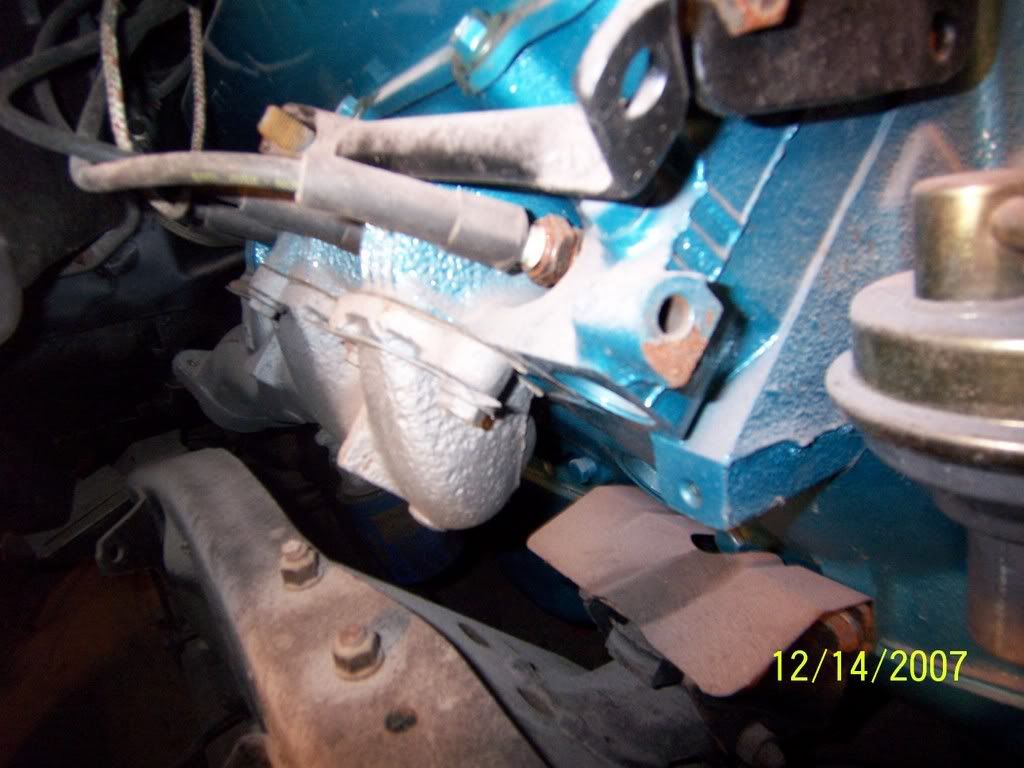

As far as the tranny...The 4L80 is really the only OD I'd use for a project like that, you'll need an adapter plate to mount it up to the Olds engine, no big deal at all. If you decide to pass on the cost of the OD, a BOPC bell housing TH350/400 could be used with the 4x4 output shaft installed.
As for the engine mounts...I've done them a couple different ways & are not hard to make, likely much easier/cheaper than finding the Diesel mounts. Here are a few pic's. Hope this helps, Do it! You'll love it. Any other questions, Just ask! Lorne

In your pic's, is that a Toronado exhaust manifold? What did you use on the driver's side? Thanks Ken

Ken, Welcome to the site! We really live quite close...I was in your town last night. We ate @ the Springfield Grille. I also recognize your name from some time ago on RealOldsPower.
Yes that is a '72 Toronado manifold on the Right (2 1/4" outlet) For the Left I used the original one from the '71 B-Body engine. The placement for both is about perfect compared to the SBC...I had about a foot of pipe still on from when I removed the manifold from the Toronado, just rotated it with a pipewrench, trimmed it up & cut off the existing (but newer) exhaust & welded the Two together. Same for the Left, I had the complete Y-pipe from the B-Body...cut it in the center under the oilpan, rotated it 90* with a pipewrench & cut the existing headpipe off & welded the two together. I did the whole swap in a weekend, but had planned out quite well in advance. Any other questions...Just Ask or PM me, Glad to help! Lorne
