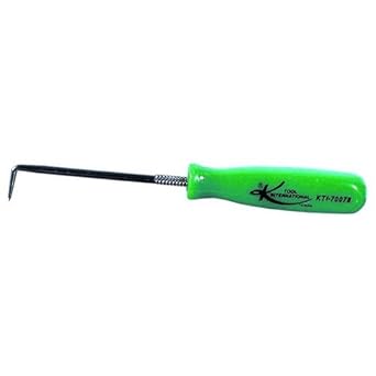

I use a 90 degree pick like this to pull the clip off
you can try pulling hard on the handle, it'll sometimes bend the clip out of the way, but if the plastic is brittle it could break
