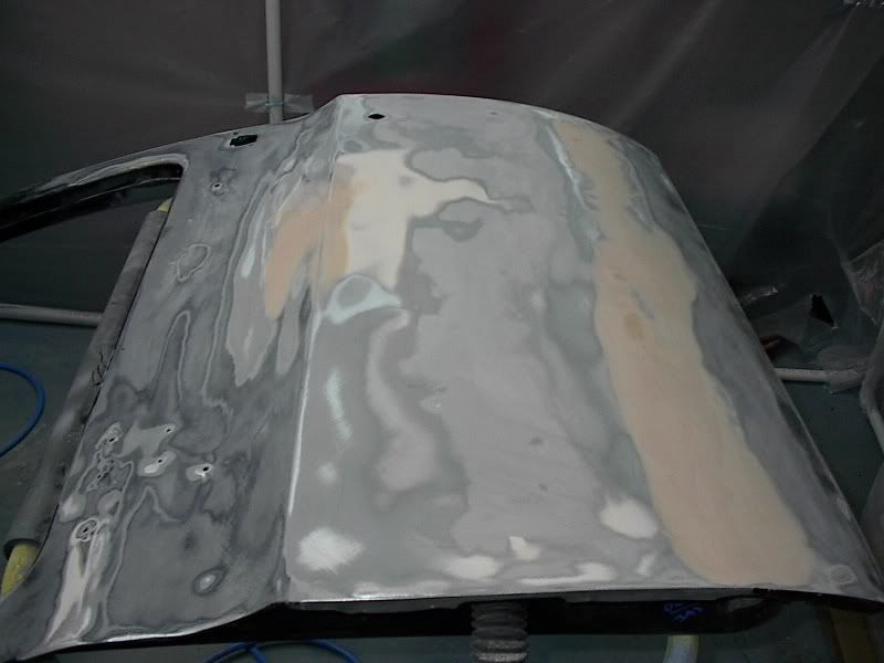

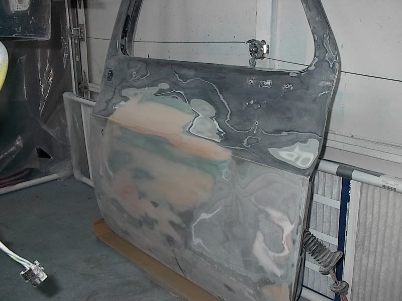

Offline JJSZABO
  • Posts: 1009
Re: Dent in the Doors
« Reply #8 on: January 25, 2008, 07:45:26 pm »
I could get to my dent through the big hole.  I suggest using studs (or weld on small steel nails to use as studs) and pull the dent out with the studs.  See this article to get the idea:  http://www.bodyshopzone.com/archives/collision/dent_pull_01/stud_welder.html
Then use body filler to finish her off.
Here are some pictures of my repaired doors:
« Reply #9 on: January 26, 2008, 06:53:11 am »
If you are just looking to pop the dent out and call it a day. I use a 2x4 and bash them out. If you are looking to repair it and eventually paint etc. I would use a combo of the 2x4 method but pushing not bashing, a stud weld dent puller, hammer, & dolly. In my experience with these doors, after straitening the metal I grind the whole door down to bare metal. It real easy to get into chasing a wave across these doors. I mud the straitened area to get it somewhat strait. Then I mud the whole door with a skim coat. Then air file and hand board the whole thing. You never want filler over paint. You always want some bare metal around any filler repair.
