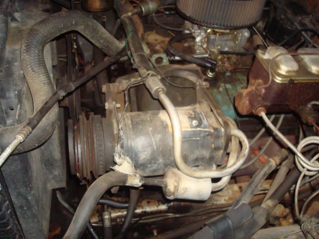

i have a 1980 c30 and i have the long style a/c compressor mounted on the driver side i really want to run the tall valve covers but after looking at my motor i realized that there is no room for them because of the a/c so i was wondering if i could switch it out for the smaller a/c compressor using different bracket or something like that  i tried to search but didn't really come up with anything and i don't really want to modify the brackets i have now... i need a new a/c compressor so if i could just switch them out that would work great

i have the 454 ill try and get a photo of what i am talking bout it seems like if i ran the tall valve cover i would have to trim off a lot of the bracket
Re: Tall Valve Cover
« Reply #4 on: October 19, 2009, 07:42:17 pm »
You won't be able to run tall covers on a 454.  You could swap the front setup to the later style compressor

what would be need to do the swap
woud the a/c lines be the same what about the a/c brackets?  same or differnt

im going to the junk yard this weekend so i fi need diff bracket i can pick them up there

it seems as though you should be able to fabricate something quite easily, even if you need to get a different (longer) fan belt.  Get some angle iron, then weld the original bracket on top of that and drill two holes in the bottom part for the intake bolts...I could have some fun with that designing something.
