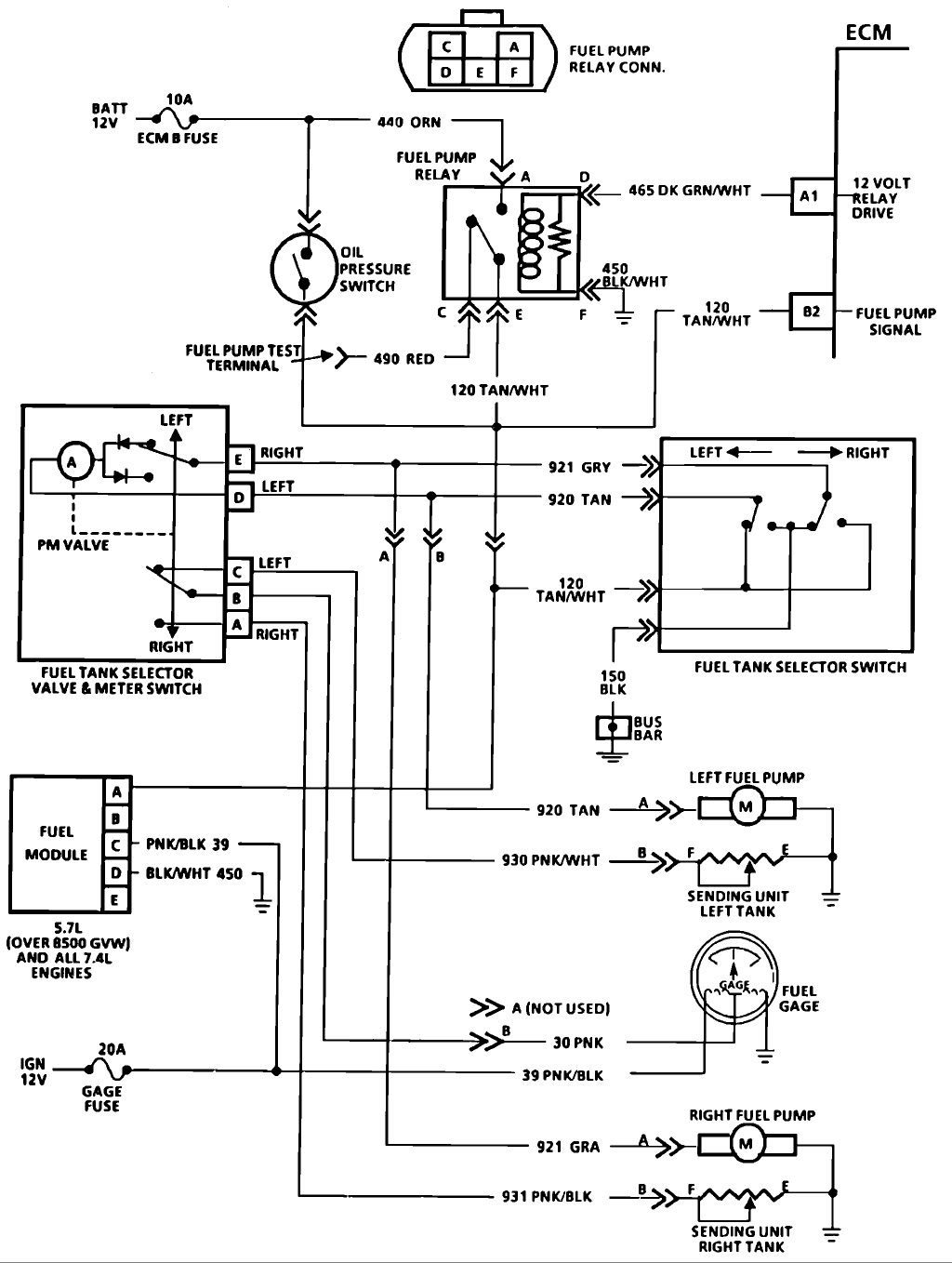

aight well according to the wiring diagram post by vile, and looking at a few other diagrams, It seems to me that the fuel selector valve is switching to the passenger tank (as far as the actual fuel valve goes), but the internal part of it that makes the switch for the fuel level sender must be stuck to the drivers side sender wire, therefore it isnt switching to the passenger side tank fuel sender. and that is why the gauge is still reading the drivers tank.
1986 K10 Short Bed 4x4 305
Posts: 19255
Re: fuel gauge/sender issues
November 23, 2009, 05:19:41 pm »
Here's another for you
Capt, can you ad this image to that link also? And you should edit out that last post. The oil pressure switch is a back up circuit not an inhibitor.

hey vile, Thanks for the last picture you posted. looks like that is for the tbi setup? because both sides have fuel pumps. am i correct? i will need that picture for when i do the 2 pump/sender setup for my tbi switch
Posts: 19255
November 23, 2009, 08:20:44 pm »
Yes that pic is for a dual tank TBI system.
