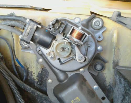

SgtDel,
I'm not sure what to adjust, can you see from this photo with the cover off.

« Reply #3 on: October 13, 2010, 04:35:21 pm »
that cam controls when the power turns off.  Something is off kilter.  That cam is telling the motor to turn off at the wrong time.  I would run the wipers while studying the rotation of the cam and try to figure out what it is doing wrong. perhaps a spring has slipped or something.  I can't tell you any more than that unfortunately.

Update:
Had the motor re-seated and now the wipers are the way they should be.
