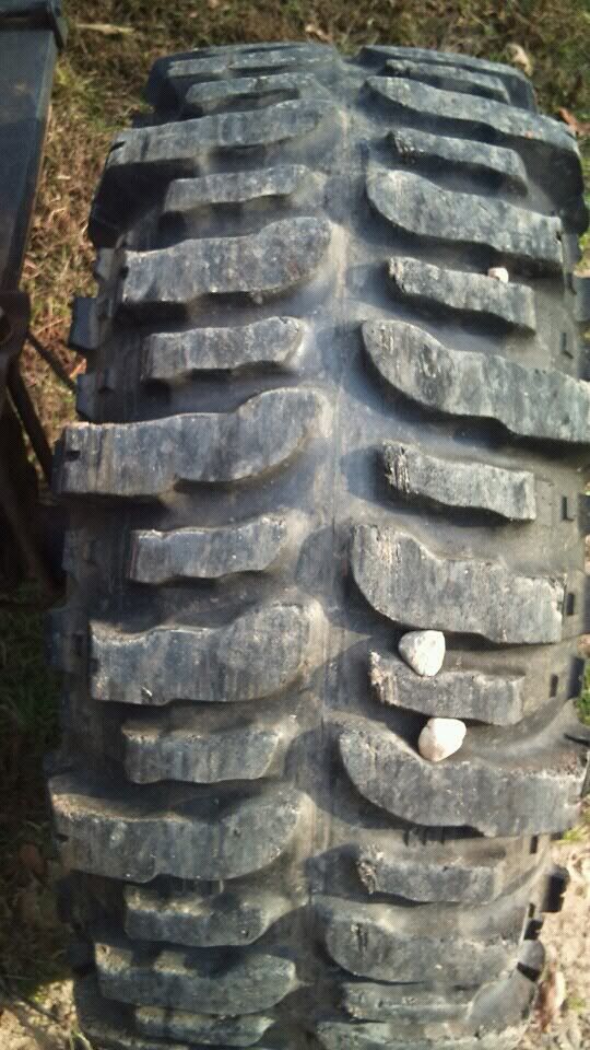

Ok so the guy said he was interested in trading. I have some 37" tsl boggers about 75-85% tread on 15" aluminum bullet holes would that be an even trade or what? Was wanting some input, what would y'all ask for if you were in my shoes

« Reply #6 on: October 30, 2012, 10:29:18 pm »
Try it and see.  I don't know what yours look like, so...
