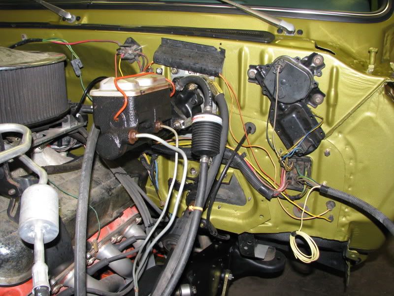

Hi,
I have a 1982 silverado with factory gauges and the large gas gauge to the right of the speedometer.  Recently I scored a factory gauge cluster with tachometer and wiring harness from a 1981 at my local pick a part.
Being a bonehead, I did not take a picture of the firewall where I removed the grommet that transitions the firewall to the interior.
Would any of you please post a photo of the under hood grommet location on your firewall?
I know it is plug and play and it has been mechanically refurbished at a local speedo shop.
Thanks,
acfixerco

The factory harness has a white lead with an affixed grommet that transitions the firewall, connects to a condenser mounted to the exterior of the firewall then proceeds to the tach terminal of the distributor.
This is not one or more wires, it is a factory dedicated single wire attached to the grommet.  Know anyone with a 73-87 w/ factory tach?

This is on my 1980. Its the white wire @ 4 o'clock from the bulkhead connection. There are dimples in the firewall for locations. The tac wire is a single wire with a gromet molded on.

Thank you so much!  I could not have received a more clean photo and instruction.  Appears you are doing a restoration, nice.
