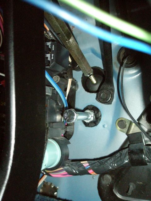

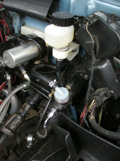

Here's pic of the finished master cylinder mount:

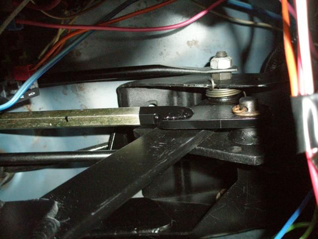

And the pedal-to-master linkage:

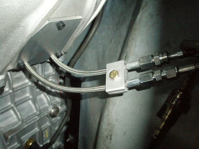

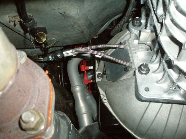

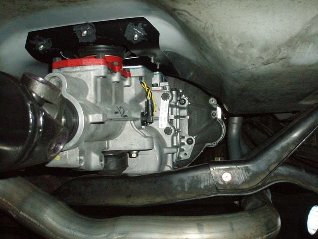

And here is the best I could do for an overall installed shot showing shifter hole and floorboard clearance:
Here is the bellhousing fork hole cover/hydraulic line holder:

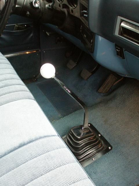

And of course the shift lever:
Huzzah!

That is a really nice looking install! Full of: "Attention to detail" that most will never see. Lorne

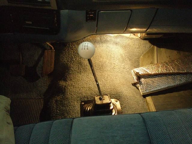

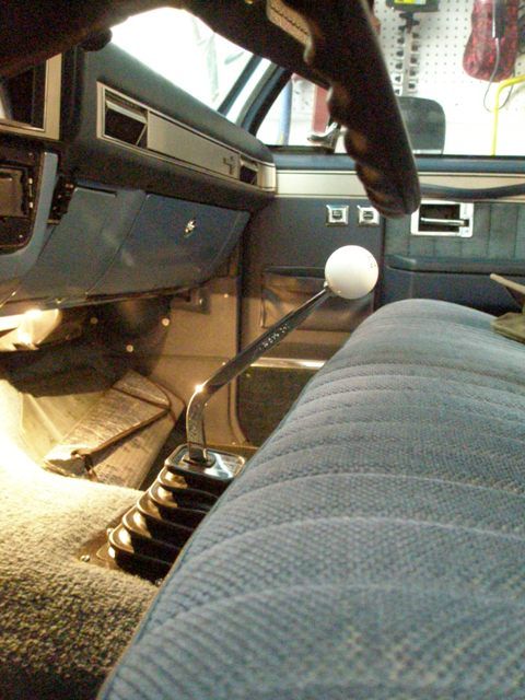

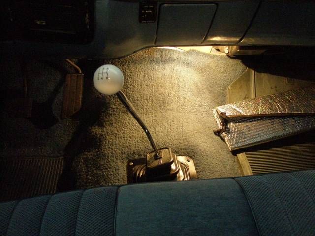

Steve: The project is finished and the trans now has about 1000 miles on it.  I did not use the mid-shift location as it would have added to the cost and limited me to one shift turret option.  I used the standard rear location with the shift turret rotated 180.
If you are intent on using that shifter handle you will have to make a robust extender to mount between the shift turret and the nitro stick.  The nitro stick alone would be too short.  I used the Hurst 8022 lever and made an adapter to angle it towards the firewall and bit more towards the driver.  The end result is a super comfortable shifter position in every gear.
Here is an idea of where my shifter is at various points:
First:
Fifth:
Fourth:
