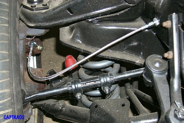

Are you saying the 90 bend is too close to the top of the spindle?
I get my braided lines from Inlinetube.com.  Tell them you need the caliper end to have a tight 90 degree bend.
thanks chris that looks perfect! hopefully i can get em to send em 2-day. hey check out my post in the wheels section btw... ned som help decidin on new ones

just ordered em! but the guy kept sayin "ARE you sure you want the tight 90 degree bend"

i emailed the tech with a link to this page so he could see the picture and he was like "yup thats our  tight 90 bend" just cant wait to get these in so i can go get the truck aligned
