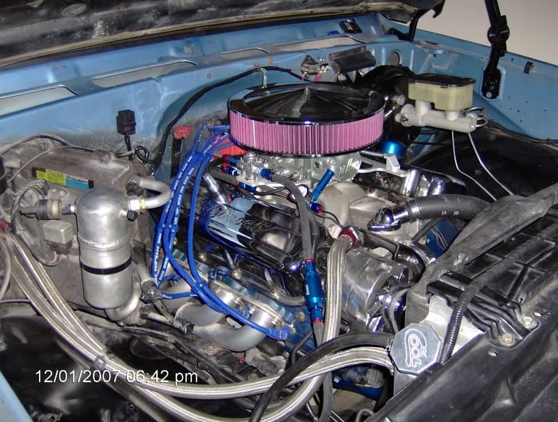

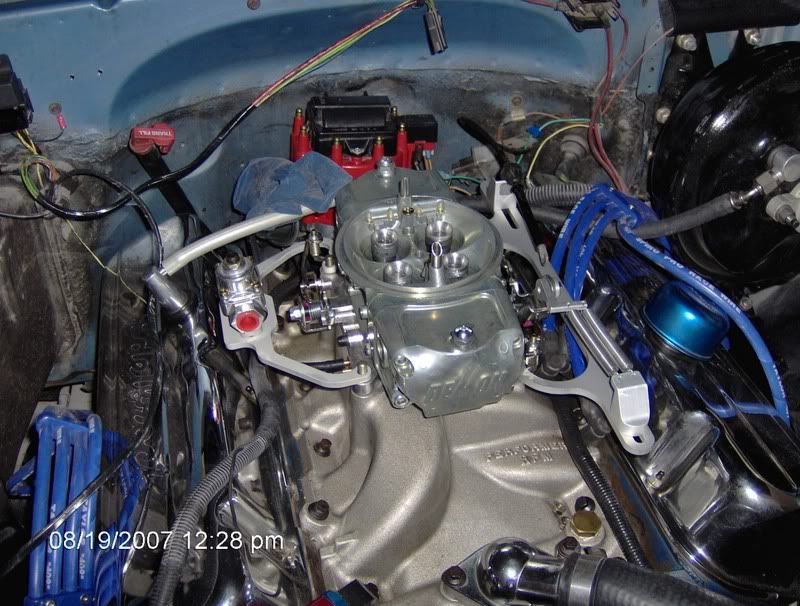

that looks awsome...i always have loved that pro-street look. those look like some very nice welds.. i have kinda a dumb question but what kind of fuel injection is on ur truck??
I had the older Holley 4Di Throttle Body Injection, but have since removed that system and installed a Demon 850 Carb.
