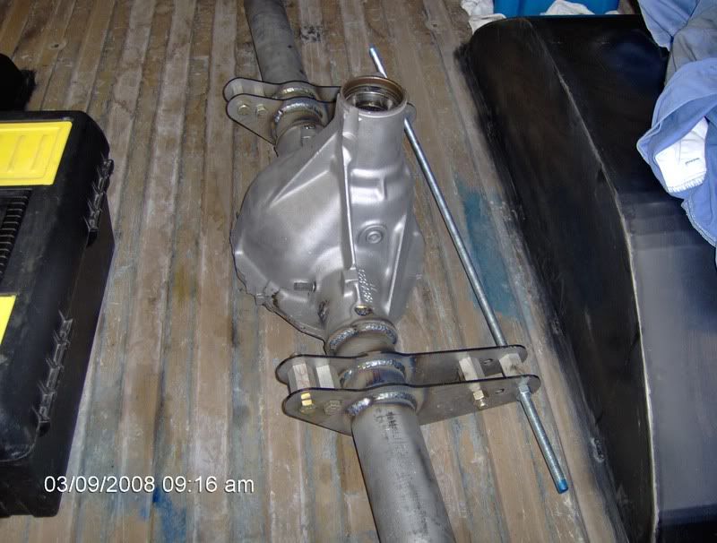

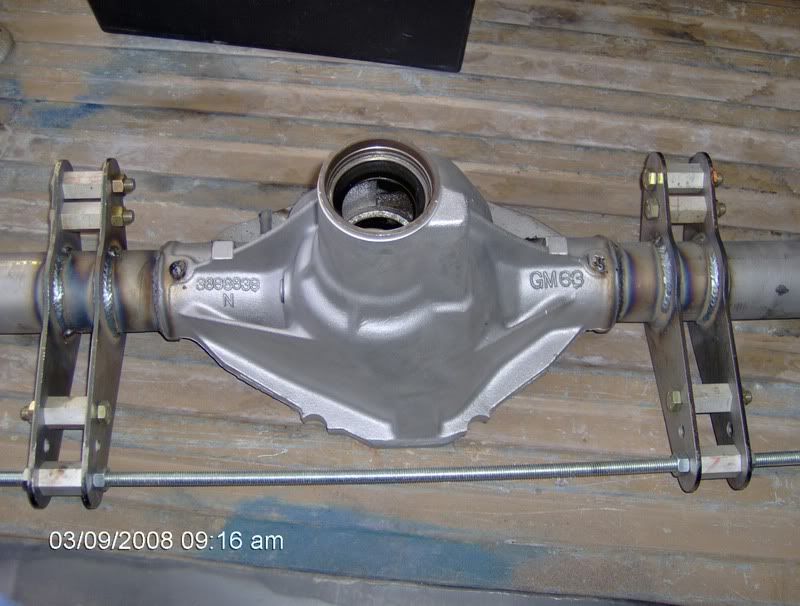

Here are a couple of pics of my 12 truck I got from Pick N Pull....I pressure washed it first, ground the stock leaf spring perches and shock mounts, bead blasted unit and cut housing ends off. I then got the measurments I needed to space my 4 link brackets out then had my friend lay some beads between tubes and center section and of course the 4 link brackets.

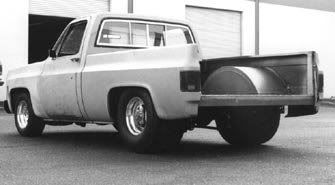

Here is a pic of a truck that alstons did years back, this is what I'm basing mine off of.

« Reply #13 on: March 13, 2008, 09:05:41 pm »
Rsbad, Looks like your friend has spent a little time practicing with that welder!  Very Nice. Are those the housing ends for the big Ford bearing w/ the GM truck backing plate pattern? I had gotten the Chassisworks catalog years ago with that truck in it, I personally think it sits a little high all the way around, to each his own. Looks like your well on your way to a really neat ride. Have Fun,Lorne

« Reply #14 on: March 13, 2008, 09:18:34 pm »
that looks awsome...i always have loved that pro-street look. those look like some very nice welds.. i have kinda a dumb question but what kind of fuel injection is on ur truck??
