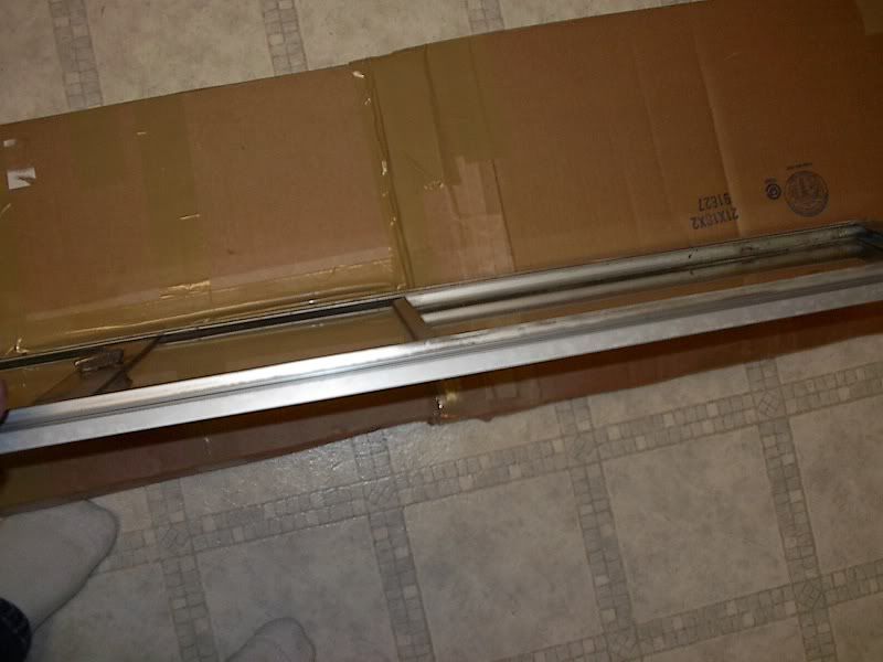

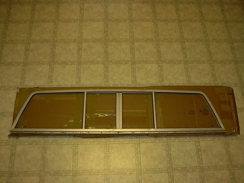

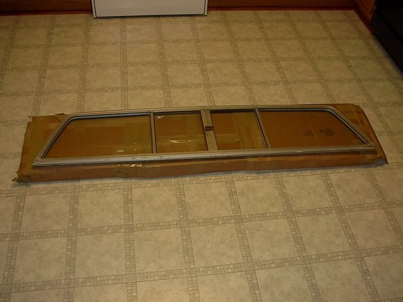

Yes. IF it is a GM supplied slider. I removed my Slider that came on my 87 and replaced it with the same gasket. If the current one has a small area that a glass will go into you are set to get just a regular glass gasket. Got a pic?
JJSZABO
Posts: 1009
Re: Rear slider Weatherstripping
March 13, 2008, 07:49:23 pm »
This is the inside - it says PRESTIGE on the lock:
This is the outside:
This is the flange:
Thanks for your help Chris
Jeff
86 Chevy C-10
350, TH400
Posts: 18512
March 14, 2008, 10:19:38 am »
It's thin like the glass that came out, just get a regular gasket.
