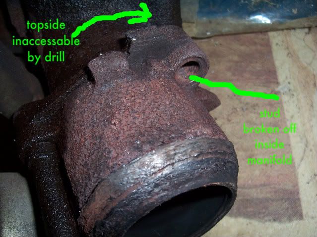

So anyways, next question, in taking off and getting ready to install the exhaust manifolds on to the next engine, when being removed from the exhaust pipes, the stud broke off in the manifold:
How, exactly, to remove this stud? Also, please note that i really don't think we can get a drill to the top of the stud---we probably have to go from the bottom.

April 20, 2009, 08:25:15 pm »
http://moodle.student.cnwl.ac.uk/moodledata_shared/CDX%20eTextbook/dswmedia/toolsEquip/hpt/nonpow/scrwextract.html

Reply #177 on:
April 23, 2009, 10:14:20 am »
Alright, thanks.
It turned out that i got the machine shop to do it(Autofab===Coleman Bros. successor). When you add up the time, effort, and the fact that i have no torches, ez-out bits, and no experience, this was actually the most cost-effective way. i hope to eventually be able to perform this task.
