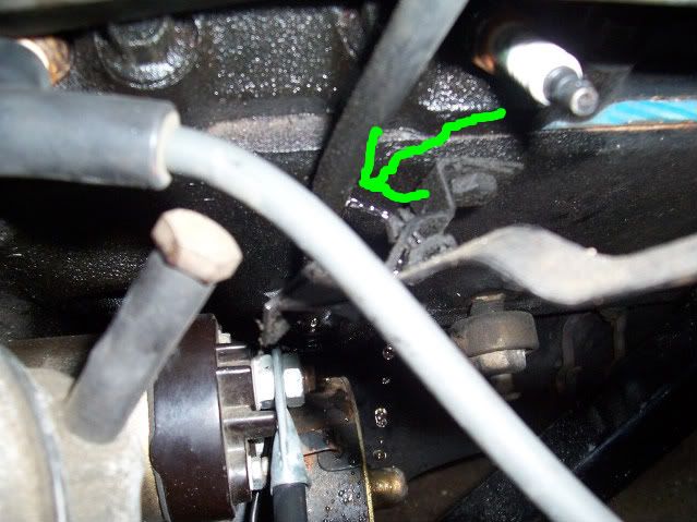

NEXT roadblock:
What happened was i did start the engine and it ran for a few secs. A little rough, but i thought the timing might have been retarded. i didn't further continue because the battery was getting run down, plus i had to go to work.
When i got back from work, i continued to fill the radiator---i'm assuming that the engine took some water in when it turned and the level in the radiator went down. No big deal? By the way, how much water does the system take? i already filled it with 4 prestone sized jugs before the engine ran. My reason for asking may become seriously apparent in a sec:

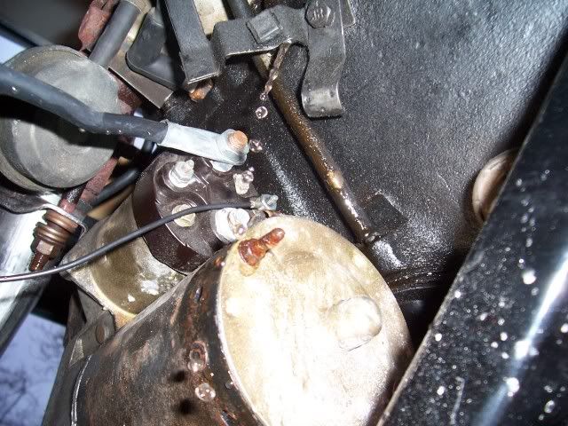

i continued filling with 2 1/2 more jugs and then water started coming out in a stream out of the dipstick! Apparently there is a hole(
?) in the dipstick tube and that's where the water was/is coming out from. These aren't the best pictures, but you get the idea?
Also, i noticed that the screw on the starter where the brace would go (my engine does not have this, but some do) is rusted indicating that this condition may have been happening for a while.
So, bascially, am i screwed at this point? The engine was hard to start earlier today.

Wow, something is seriously wrong here. The only way I can see you getting water out of the dipstick tube, is water is getting into the crankcase. 4 gallons of coolant doesnt sound bad, but 6 1/2 doesnt sound right at all. Check all your coolant lines and make sure a vacuum port didnt get connected to the coolant side. May be a head gasket, intake leak

Hate to say it Stewart, but if my engine had water pouring out of the dipstick, I'd be pulling it and tearing it down. Could be as minor as a failed intake gasket, could be as serious as a cracked block. Sorry to hear this, but at least you have that 305.

I don't think there's supposed to be a hole in the dipstick tube but I could be wrong. This happened to me a couple of decades ago. When I put the heads back on I somehow put a shorter headbolt in one of the boltholes(must've switched with another one) and antifreeze ended up in the oil pan. I think that one bolthole had a water jacket running through it(if that's possible). I hope you find your "gremlin". Good luck!

Stewart, You didn't have water running out there before you took the engine out? Maybe that "hook" part is rotated & that was spotwelded on as a support, now it's broken...taking a little spot of tube with it? By the looks of that bracket (the oily silt on it) I think the hole has been there a little while. Doesn't explain the water...but may explain the hole. That would take allot of water to FILL the engine to make water shoot out that high up the dipstick tube. This is one odd deal. Good Luck with that one! Lorne
