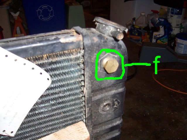

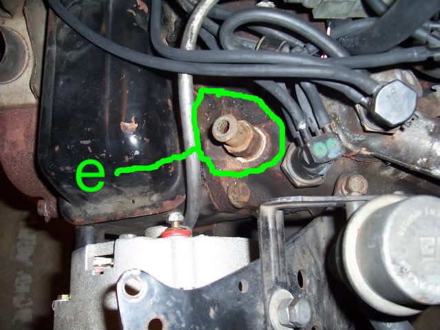

OK, perhaps i need to back up the train and be more specific:
This is for the test stand and thus i have no heater core. We can see that there is a water outlet(fig.e) on the intake manifold here:
And on the radiator there is an opening(which i've previously plugged, but could unplug if nessesary) here (fig.f)
What do you suggest i should do? Since the outlet "e" is already in the block, i would rather just leave it; Is there a way i could run a short length of hose and plug the hose somehow?

I wont run heater hoses on my test stand. You can just take a short peice of hose, and plug the end with a larger bolt and hose clamp, or get a hose nipple and cap from the local harware store and put it in the end of a short hose and use that as a plug for the one in the intake.

You have another outlet on the water pump.
Just loop a piece of 3/4" hose to the 2 outlets.

April 10, 2009, 10:09:51 am »
That's true.........Duh!
Thanks again.

April 10, 2009, 11:21:55 am »
Why not just plug the manifold too?

Re: NEW PROBLEM(S):
Reply #144 on:
April 10, 2009, 11:38:40 am »
Well because i figure it's already in there and not leaking and therefore i don't want to take it out and have to put it back in and possibly it might start to leak. i'm like that; i'm the type that likes to pretty much leave things as they are for fear that i might not get it back the way it was even if further adjustment could yield greater benefits.

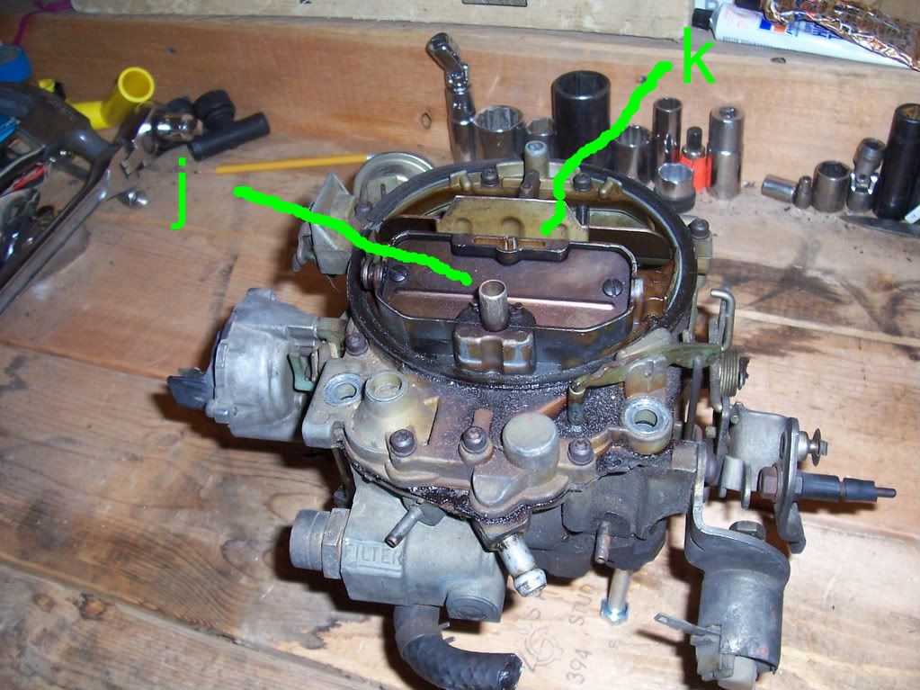

Next question, when we want to fill the bowl of the carb before starting, where should we do this at? J, K, or some other place?

April 12, 2009, 02:42:10 pm »
j
