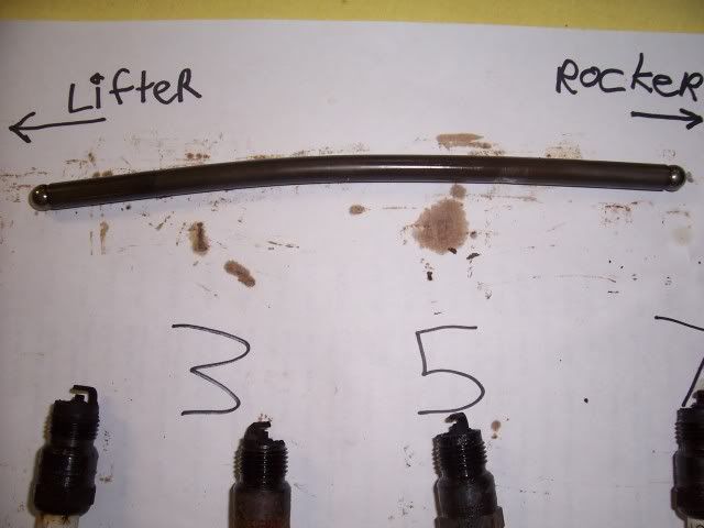

i went to try and find TDC#1 so could i re-install the distributor.  In order to do this, i took off both valve covers to see when #6 rockers were moving while #1's rockers weren't and vice versa in relation to when the mark on the harm balancer moved under the 0 setting on the timing tab.  i also took all the plugs out to make turning the engine easier and i'll show you the plugs in a sec because i think that may be important also.
What i found was #4's exhaust rocker was loose and not "square" on the "valve stem" as illustrated in the picture. If you pretend that the following picture is a road map, then i could move the pushrod N S E W and really any direction in the 360degree compass, but i could not move it towards or away from myself (up and down) (note: i am putting some words around quotes because i do not know the correct terms to use at this point.)
Later, i decided to tighten/adjust this rocker(rotating the crank clockwise about 45 degrees from #1's TDC---#7's rockers moving, #4's rockers not moving etc.)  As you probably know, you need to roll the pushrod in between your fingers while tightening down the nut.  i immediately knew something was wrong at this point.  Voila----we have a bent pushrod.
So.......do you think this could be the cause of all the problems?

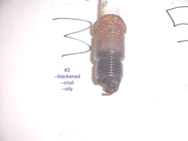

The other thing to add, i don't know if this has anything to do with it, is the condition of the spark plugs:
Plugs 2,4,6,8,7 were similar.
Plug 5 was similar, with a little bit of oil but with no crud.
Plugs are RS 45's (will check exactly soon) and basically all carbon blackened.

« Reply #125 on: April 04, 2009, 11:02:40 pm »
Bent pushrods definately cause trouble. I replied to your other post. The plugs being black is running rich, and oil deposits possibly from worn valve guides and/or piston rings. The plugs on all of my trucks run a tanish color.

« Reply #129 on: April 05, 2009, 07:55:03 pm »
1)The other reason why the EGR is removed is because i can't get the valve cover off without taking the egr off too.
2) i guess the next obvious questions are, what caused the bent pushrod(i have my theories, but i want to hear the common reasons why first) and where to get a pushrod---from what i've seen, jeg's only sells them in pairs of 16.

« Reply #131 on: April 05, 2009, 09:18:55 pm »
Do all SBC pretty much take the same pushrods more or less?   Are they interchangeable with 305's  etc.?
Offline HAULIN IT
  • Posts: 1542
Re: NEW PROBLEM(S):
« Reply #132 on: April 05, 2009, 09:43:46 pm »
Yes, Stock, pre Vortec SBC's take the same pushrods...you can steal one out of many.

« Reply #133 on: April 09, 2009, 07:32:26 pm »
Pushrod installed and rocker adjusted.  Hopefully this time properly.
