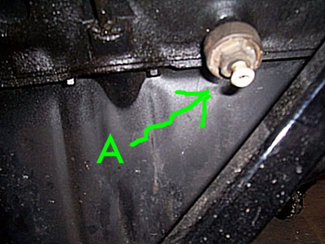

What is this?  What does it do?
i'm guessing something to do with oil.

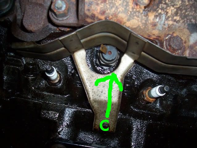

This was one the driver's side.

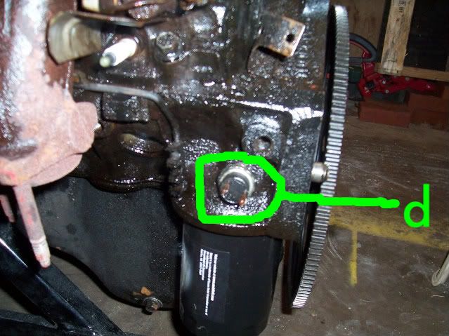

It would seem that we have both water and oil monitored, but alas there is yet another sensor located just above the oil filter;  What is this?  What does it do?

A- I believe this is a knock sensor that montitors detanation and retards or advances the timing accordingly. I think it is used on the Electronic Spark Control (ESC) systems

C= Water temperature sending unit used to send ground reference to water temperature gauge in dash. As with the oil pressure sending unit, if it is replaced with a sending unit that has a different operating range, the gauge will be inaccurate.
D= Appears to be an oil pressure switch. It is only for the oil pressure. I am not sure what this one is used for, it could have several uses, but I believe it may be the one that controls the power to the electric choke. I believe it is a normally open switch (no continuity between contacts) and when oil pressure builds, it send power to the choke coil to heat it up, causing the choke to open. I am not going to swear to that tho.

A)  is a knock sensor. When the engine starts pinging from preignition, the computer picks it up via this sensor and retards the timing saving you extensive engine damage.

C) is the sensor for the TEMP light/guage
D) I forgot this...something to do with oil for sure....

The fourth pic is an oil pressure switch and is used for the choke as choptop said earlier.  Although that is an odd location for it.  Mine is located on a tee at the same location as oil pressure sender in the second pic.

A) that's what i kind of figured.  i can leave this unplugged as i no longer use the ESC distributor.

c) i only have a light.  Let's say i want to add a gauge and keep the light, which, actually, is what i actually want to do.  Do you have some pointers as far as "t" fittings go?  Also, just out of curiousity i know there are other places to get temp readings from.  Why did the factory pick the head?
d) Yeah, i think you all are right because the wire for the choke, i think branches off from these wires that go into sensor d.

You can tee the oil pressure gauge, I prefer to do this at the one by the oil filter because its easier to get to, just use some good steel fittings, not the cast, black iron ones. As far as the temp, if you are removing the vacuum thermistor in the intake, I would put it there. Ther really isnt a good way to tee it in the head without having an odd looking contraption hanging out the side of the bolck that could break off due to vibration. I usually plug the oil passage at the back of the block when I have to change the sender or have the engine out because its such a pain to get to and I have had issues with them leaking.(bad sender) I dont know if this is a mistake or not, but I have never had any issues. I just hate oil leaks and this eleviates one of the hardest ones to fix.
