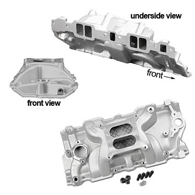

More decisions
not sure if there is a difference (besides the price)
between
http://store.summitracing.com/partdetail.asp?part=SUM%2D226014&view=1&N=700+150+
and
http://store.summitracing.com/partdetail.asp?part=EDL%2D7501&autoview=sku
Offline dumbucket1
  • Too Many Trucks
  • Posts: 597
  • Coal Hauler
Re: Decisions
« Reply #11 on: December 16, 2008, 12:35:12 pm »
I was looking at the vortec version of them manifolds, from what I understand those are just debadged edelbrock intakes.
