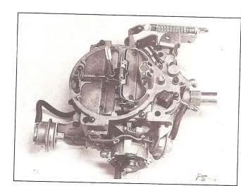

Does it look like this?
If so, the carb is a dual capacity pump.  The electronic connection is for the pump solenoid.  This is a NON-COMPUTER controlled carburetor.  When the engine is cold, more fuel is needed for transition from idle to part throttle.  When engine warms up. less fuel is required.  Dual capacity pump solenoid is activated by collant temperature sensor.  At 170 F pump solenoid energizes dual capacity pump valve opens and pump capacity reduces by about half.

Yes sir thats the one. Would be nice to know how to wire it so it would work. Anybody got any ideas? Truck is a 1984 k 20 4x4 350/400.

If you use that carburetor, you need to wire in the pump solenoid.  If not then too much fuel is dumped into the carburetor causing a rich condition and wasting fuel.  Ask me how I know? :D  It will run that way but use way too much fuel.
I couldn't figure out how to wire mine sooo.... I just scrapped it for an earlier 4 bbl Q-jet M4ME model that does not use a dual capacity pump.  I bought it from National Carburetor (http://www.nationalcarburetors.com/).  It came with a lifetime warrenty and the price was reasonable 230.00 dollars.
