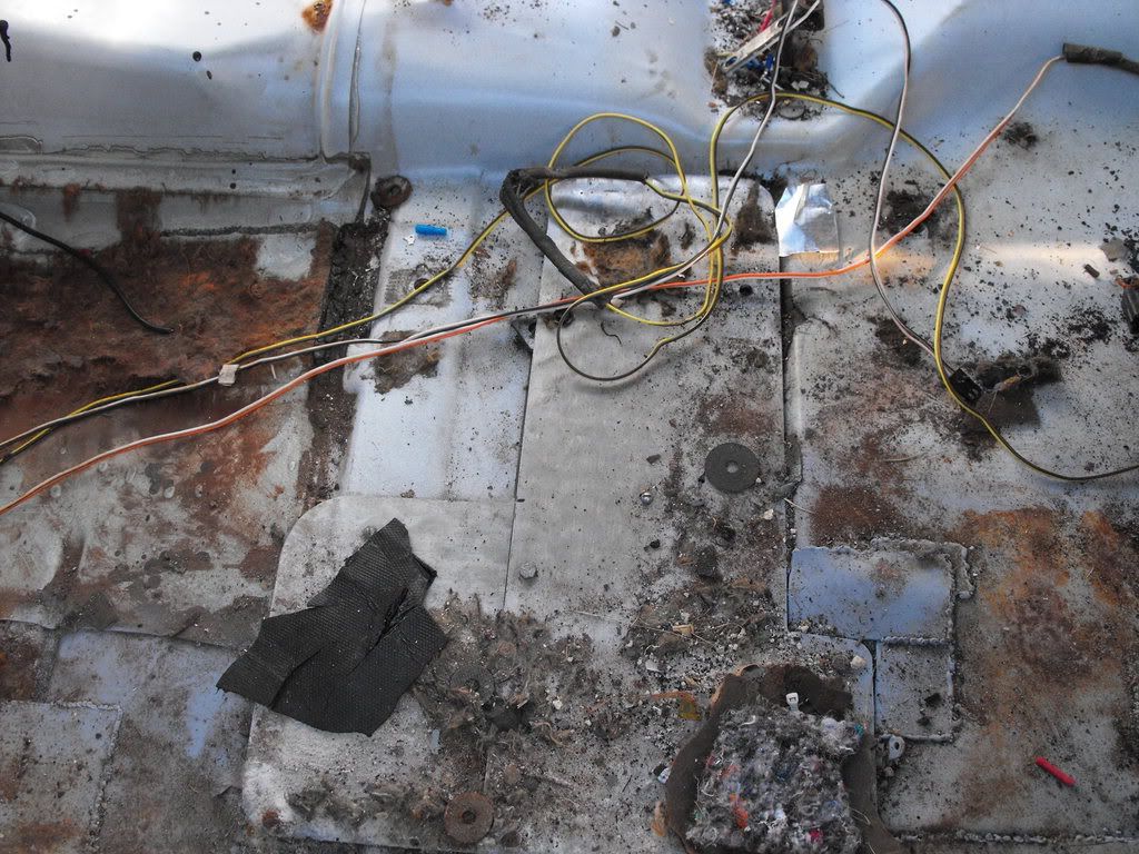

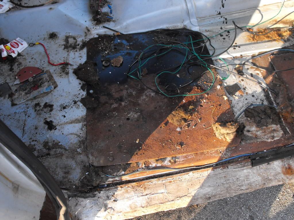

Took the seats out of the Blazer and the passenger side has a steel plate driver side has pieces of aluminum . are they suppose to be there ? or was this added for strength since the floor is bad ?

hey frog i have not messed with a blazer much but i am sure that is a peace of metal that someone put there i would unbuilt it and see what you got  ;)

thanks I know whats underneath :) Lots of ROT if it is suppose to be there I will put em back after I fix the rot

that is what i thought someone getting out the easy way and just covering up the rot >:(

Looks like someone bolted a speed limit sign to your floor for a cheesy rot repair.

Not a Stop Sign its like 1/8 maybe 3/16 plate steel on the passenger side I will say its not suppose to be there and not put it back :) thanks

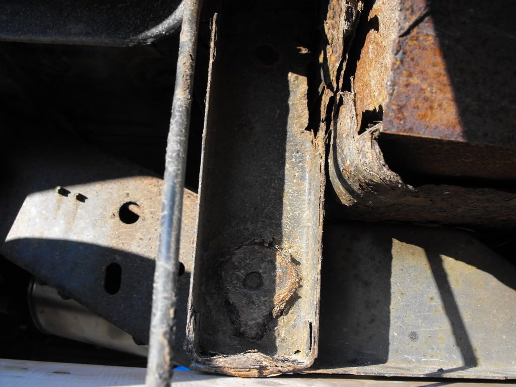

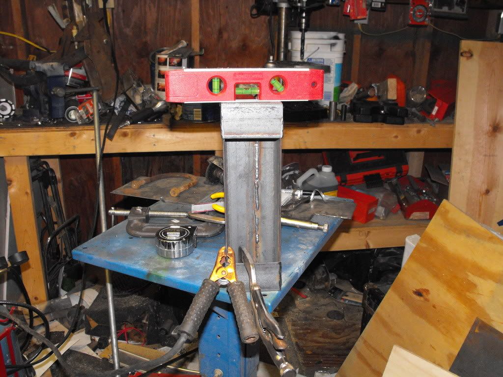

Everything is shot!!! This rust bucket needs (which I got today) from the (what) tailpan forward all gone floor supports which I will have to make other parts that I have no idea what they are called and arent made I will have to make. My biggest "problem" according to my wife is I over engineer the stuff I make :) here is a example.
Looked like it was made out of 16 ga steel but both sides are shot it goes up to the "bed"
I took some 2 inch (1/8 thick) angle iron and made a new and improved one :)

nice job. looks good. i did mine with a 2" sqare tube and cut one side off to make the channel . i want to upload some pics for you. might give you some ideas for making your pieces. i just have to find my usb cord for my camera ???
