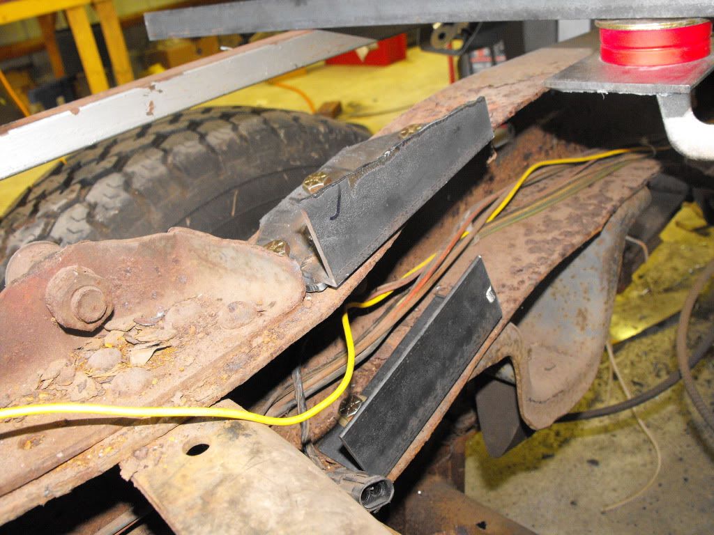

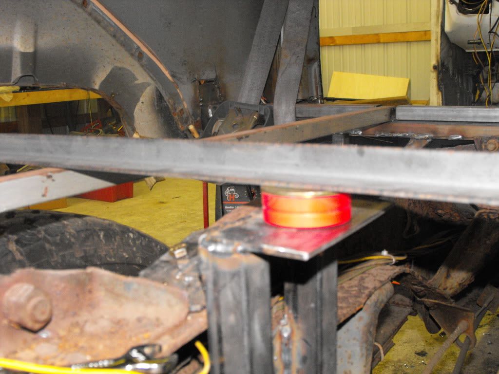

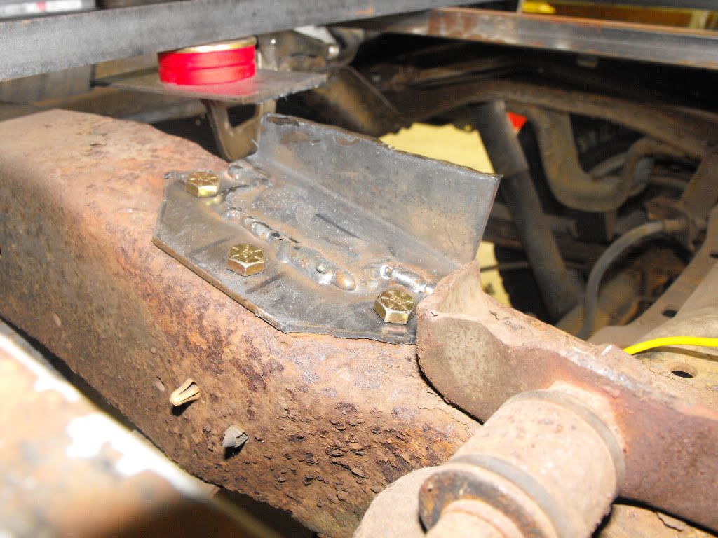

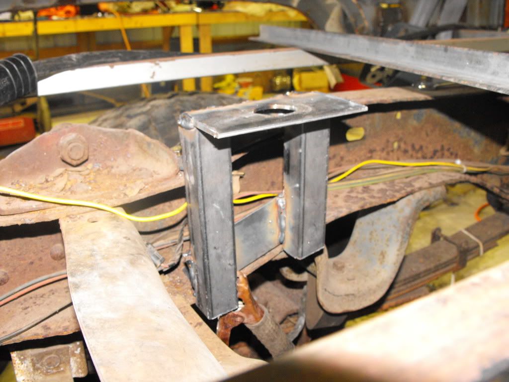

The frame to body mount in the middle of the bed were rotted , checked with Chris and he could not get em :( so I made some .
I think they will be ok (only made 1 so far) what do you think
That is a piece of 1/8 plate drilled to the specs of the old mount then I welded a piece of 1/8 X 2 angle iron then cut that to the correct angle
I cut and drilled another piece of the 1/8 X 2 angle and drilled a hole in the bottom frame rail
cut some 1/8 X 1 square tubing and ran it between the 2 pieces on the frame then put another piece of the 1/8 plate with the proper hole for the bushing cut out
all welded and bolted in the bushing is in with the washer (the angle iron is representing the floor)

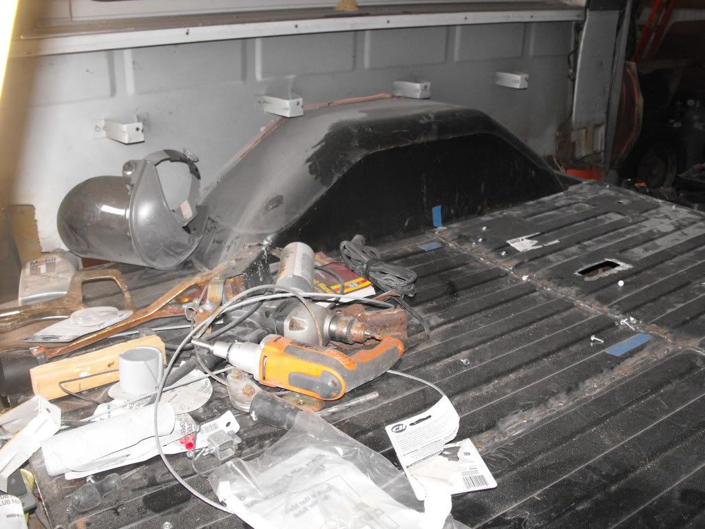

Thanks you taught me most of this :) The rear floor is in if I find the camera I can finally take pics :)
Had some issues with the wheel wells meeting the floor and body. So I just welded them in instead of bolting :).
Last piece of the body (major anyway) is the DS rear quarter. Then she will be ready for some primer.

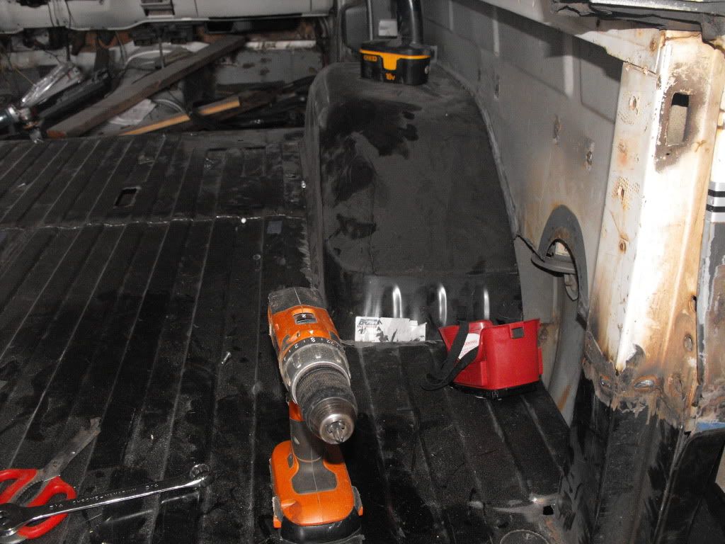

Here is the floor in will get better pics thru my back out and cant clean it out lol
