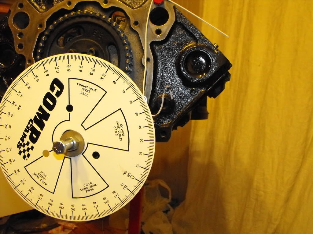

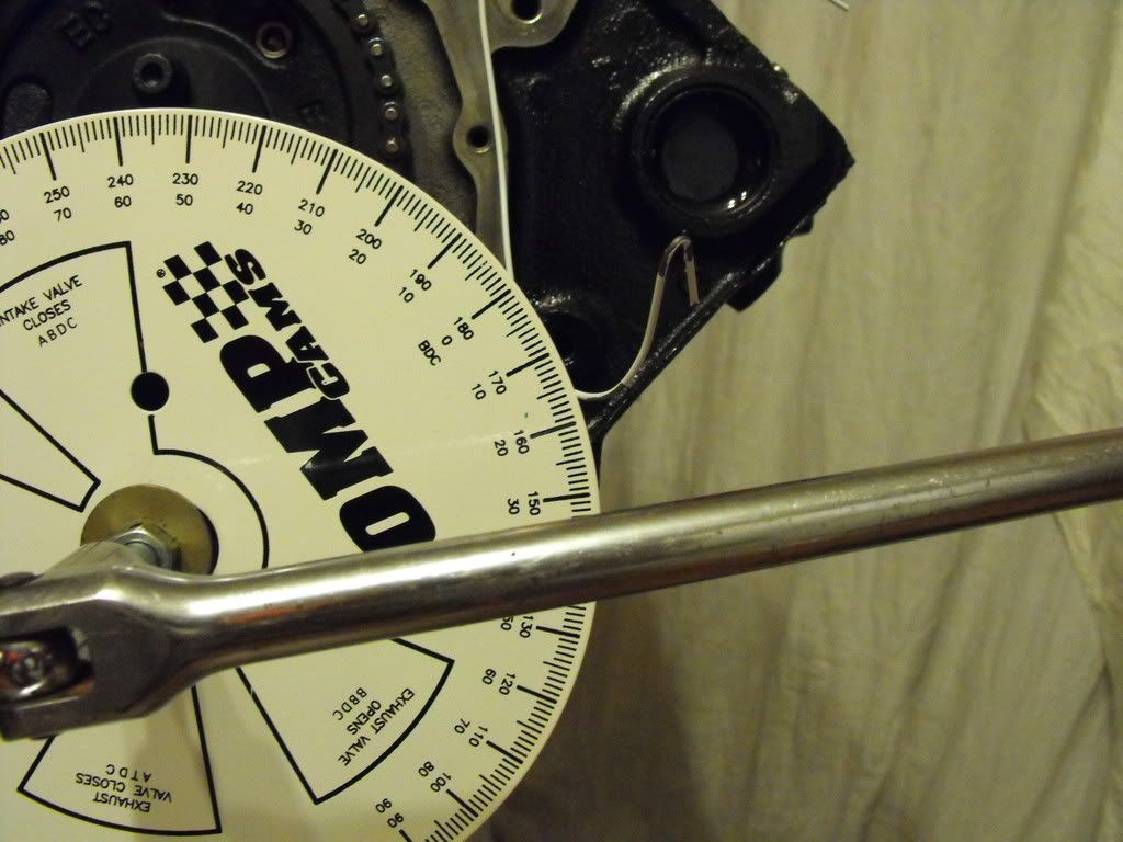

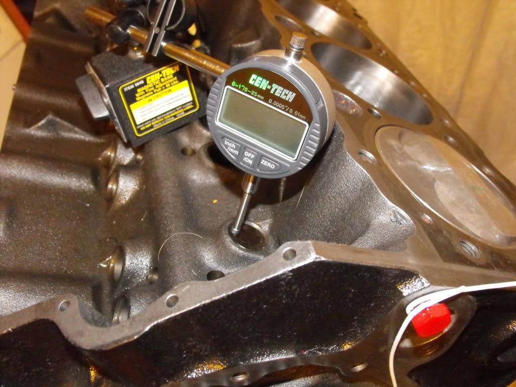

Didnt get much done, degree'd in the cam was going to put the heads on but found one rocker stud was bent so that is in the machine shop for a day or two :(
Since I dont have the heads on I rotated the engine clockwise with the dial indicator on the deck till I got the highest number before going down once I came back on that number I set the degree wheel to 0
I didnt have a solid lifter so I used a old one flipped upside down. I placed the dial indicator on the edge (it was a bear to get the angle just right)
I did the degreeing at least 4 times to be sure it was right
After finding the highest point and zeroing the degree wheel and rotating the engine backwards .100 this is what I got at .50 going forward (clockwise) 48 degree's
Going forward past zero than to .50 I got 164 degree's
Total is 212 divided that by 2 and got 106 just where it was suppose to be :)
One thing that took forever (since I was trying to use my old memory :) ) was putting the chain on I did it the way I always did the two dots line up on the bottom. Well since I am teaching my son the "correct" way of doing this I pulled the Haynes book out to show him and it shows the cam one should be on top. That had me stumped but after messing with it and a square for about 20 minutes to get it perfect I rotated the engine and the two dots lined up on the bottom. Not sure why Haynes doesnt do it that way it is so much easier.
