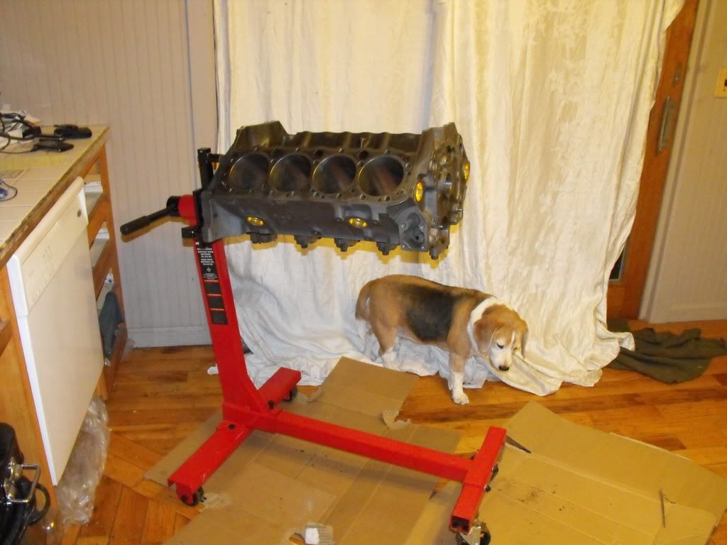

Got the block back from the machine shop today  ;D
Dogs think I am nuts :) didnt get much down to it except one coat of paint our heater (which was installed in June) went out and its about as cold inside as it is outside unless your near the pellet stove

So what are you building? Is that a beagle?

you are the man doing that in the kitchen lol very nice. what did you have done to it?
Yeah you want two beagle ?? :)
Kitchen/ dining room , I am embarrassed to say I had to watch http://www.imdb.com/title/tt0410297/synopsis
But the temps have been in the teens/single digits so my shed was not a option

Your project manager is cute, block looks good.

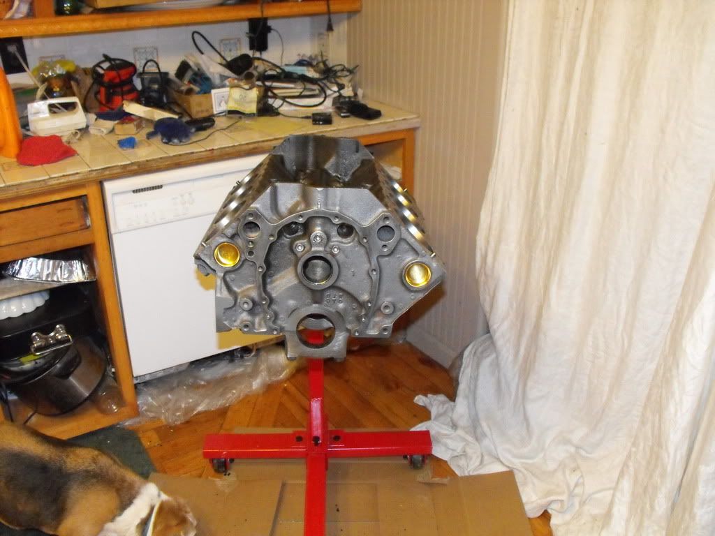

Here is what is going in/on the engine .
pistons and rings
heads
cam
distributor
intake
crank
Had the block hot tanked , bored .030 new freeze plugs and cam bearings, had the new pistons pressed on along with new connecting rod bolts
I might be old school but dont think much will get done today Advanced Auto doesnt carry Plastigage (as the kid put it , its not in the kit you dont need it) and NAPA is closed on Sundays. I will retap on the threads though

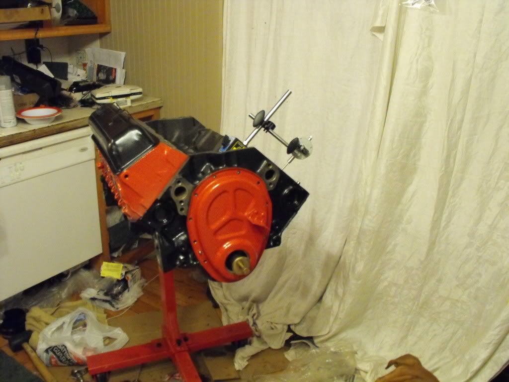

Got the bottom end done  ;D
Not sure if I did the piston deck check right though. Took a speed square across the bore brought the piston up to it then put the dial indicator onto the piston zero'd it out then brought the piston up. My numbers dont look right .
1 +.097 2 .092 3 .089 4 .094 5 .078 6 .084 7 .086 8 .084
1 2 and 4 are concerning me
I am thinking of doing the clay test just not sure if that is really accurate.

This will be the Color Scheme.
Since my son is really building it and I am just guiding him he got to choose the color, he chose his school colors

Looks good. Our kids school colors are orange and black too
Actually thats Red :)  I forgot the flash so it probably didnt take right it was dark out and the wife likes 40 watt bulbs..
