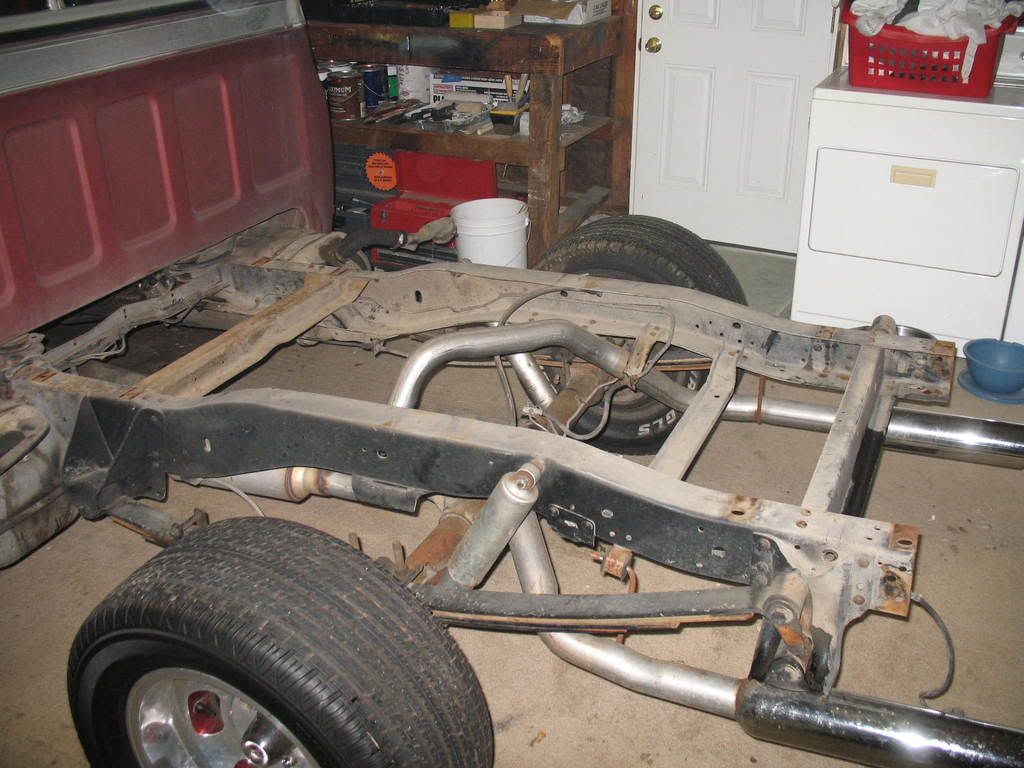

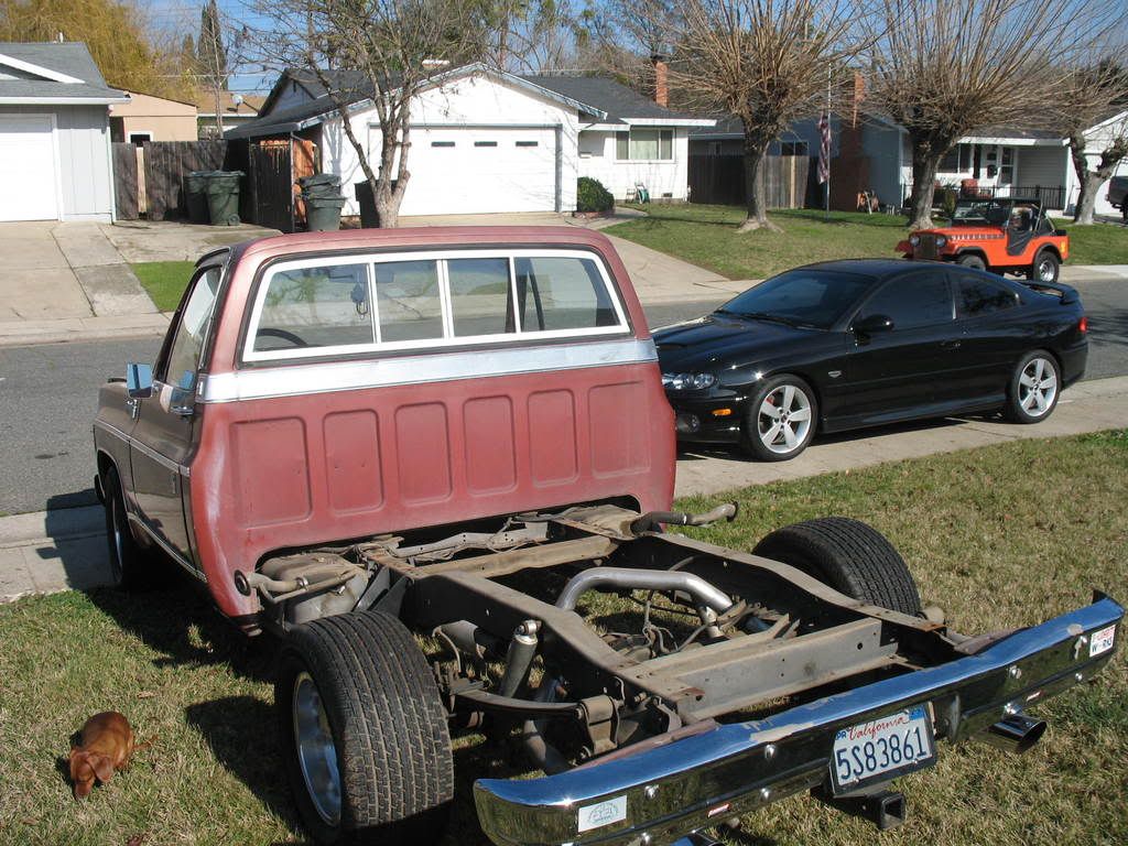

thanks for the input guys! i started on her today... got the bed off, rear bumper, hitch, seat, and carpet out. the frame is really clean. my neighbor helped me lift the bed off and he couldnt believe how clean it was under there and wondered why i'm even doing this. i have been questioning that myself. lol! next to come off is the hood, front clip, and cab. then it's almost blasting time!

Offline menace1978
  • Posts: 33

« Reply #5 on: January 26, 2009, 07:50:19 pm »

Looks real clean man,Welcome from florida.
Wow, that is really clean under the bed!  Especially for that old a truck.  Might be an easy job.

wish mine looked that clean under the bed. whats with the fire extinguisher? was this truck ever raced?
