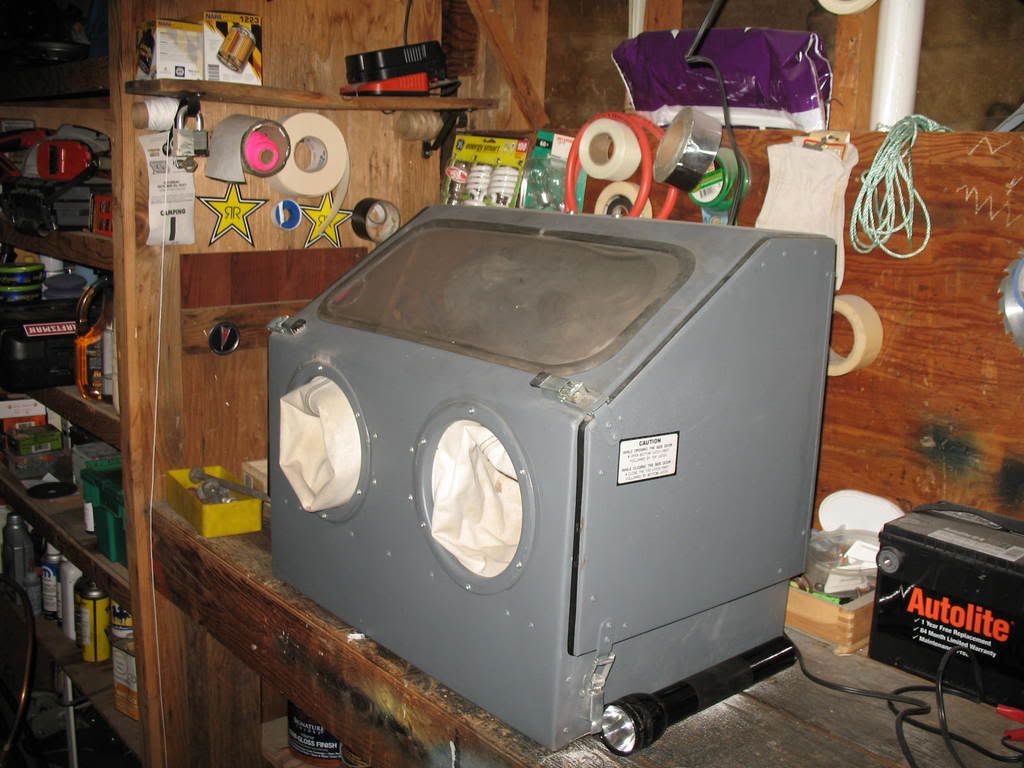

sweet! thank you... yesterday i picked a cabinet sand blaster off craigslist for $80 and played with that cleaning bolts and stuff. did get the driver door off. kind of a pain w/ all the wiring. i'll get the pass. door off today and start cleaning up/removing the mess around the motor... wiring, vaccum lines, brake master, and whatever else i threw on top of there to get the clip and cab off.

Nice progress. Good find on the cabinet also I've been looking for one but I want the bigger one. Does it work pretty good?

thanks buddy, i wanted a bigger one also but i figure i'll save anything that wont fit for last and use some cheap home depot sand and do them outside the box and i'm kinda short on room especially when i get the cab, motor and trans out.
it actually works really good. gives my compressor a heck of a work out but i used it on the drivers gas filler tube and the bed bolts and stuff turns out really good. like new!
