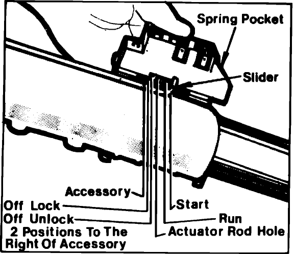

alright, just messed with it agian and here's my current situation.
there seems to be the acc. on or something as the radio has is on constantly while the batt. is connected.  i have the ignition lock out.  i press on the ignition switch and nothing happens.
what do i need to do?
notes:
if i temporarily purchased a new switched and hooked the harness up to it, would it crank the truck.  i imagine it would need grounded?  i also see where there are diff. positions on the switch in my book.  don't see any on mine?  i just need a way to be able to crank it and shut it off to move and eventually it will get fixed.

well, it looks like the switch and rod i've been messing with is for the dimmer located towards the bottom of the cloumn, the floor and duct.  where is the actual ignition switch located then?

« Reply #8 on: January 31, 2009, 07:30:47 pm »
It too should be on the column it is longer than the dimmer one and also has a rod going to it

« Reply #9 on: January 31, 2009, 10:53:14 pm »
i haven't had the pleasure of taking mine out yet but on my 79 its on the top left side of the steering column. if i can remember right on my 89 the dimmer switch was more on the left side

« Reply #10 on: February 01, 2009, 05:17:50 pm »
i have an 85 by the way.  not sure if that makes a difference, however i just looked down towards the bottom again and on the other side of the column right across the dimmer switch, there is a black rectangular plastic piece with a harness, but it doesn't look like the switch to me?

« Reply #11 on: February 01, 2009, 06:24:11 pm »
The swith is on top of the column. Just lower the column and it's right there.

« Reply #12 on: February 03, 2009, 12:26:44 am »
you have to take the black plug off first if your going to remove it. but it will only take a min or two to run the hot wire to the dis and jump the starter solenoid
