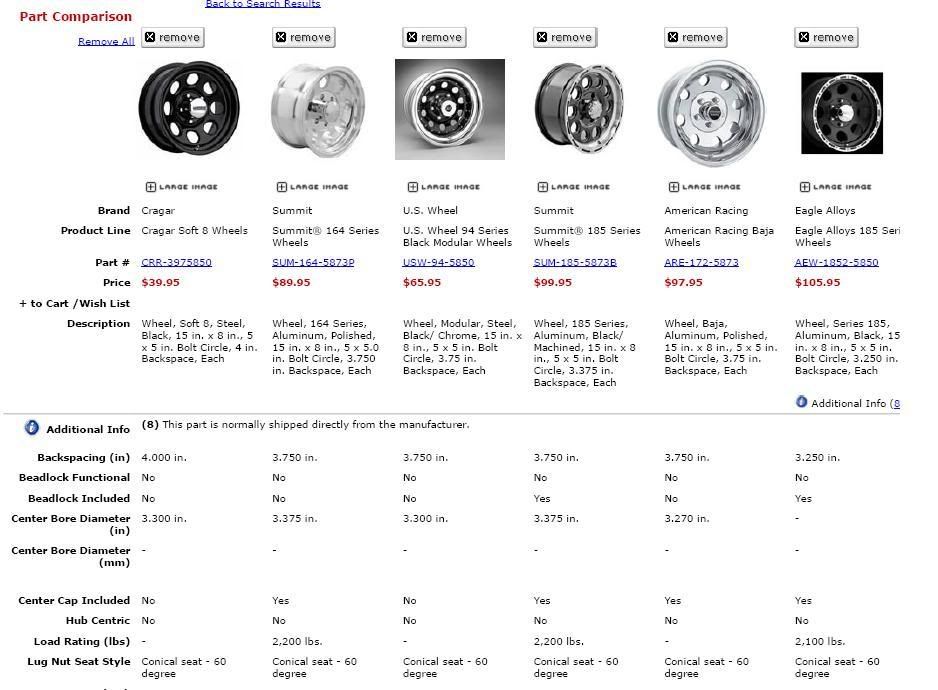

I have read that the oem back spacing for 15 x 8 is 4" but not sure how some of these will change the stance.
aslo which do you like?

The second one 164. Is this for a 2wd? The backspacing will be different front and rear if you want it to have a wider track in the rear. The facory tucked the wheels WAY in on the back.

so the eagle alloys should work?
Re: Tire fit / opinion
« Reply #7 on: February 02, 2009, 01:48:46 pm »
The ones above are going to push the wheels out.  Depending on the size of the tire, it may put the tread at the fender lip.
