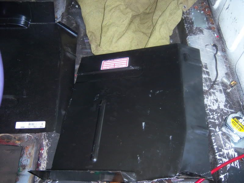

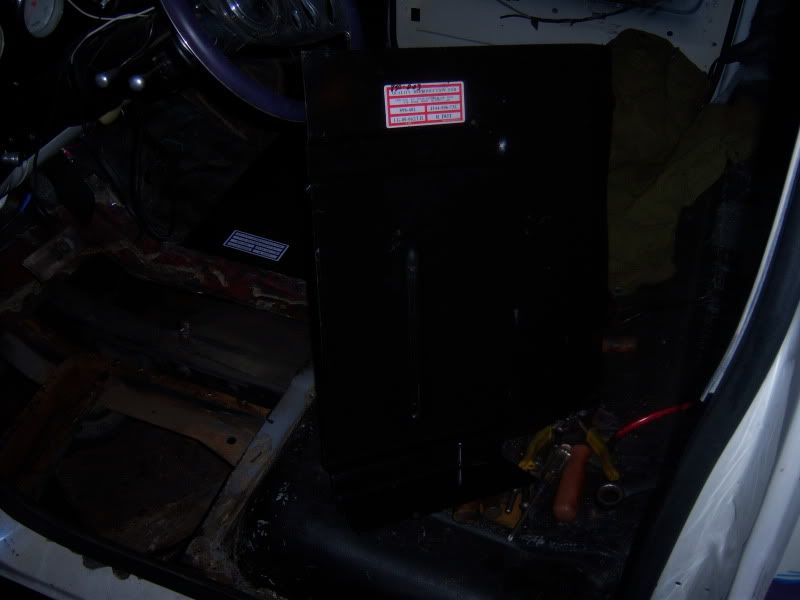

didn't get much done today because of this
I left the three inch drop springs in for a simple install
and for some reason the floor pans are really short where they start to angle up so it looks like have to cut some metal off the old patch panels

you should have ordered the extended floor not the standard floor.

oh I was going by picture in your store
mine stops at the red line

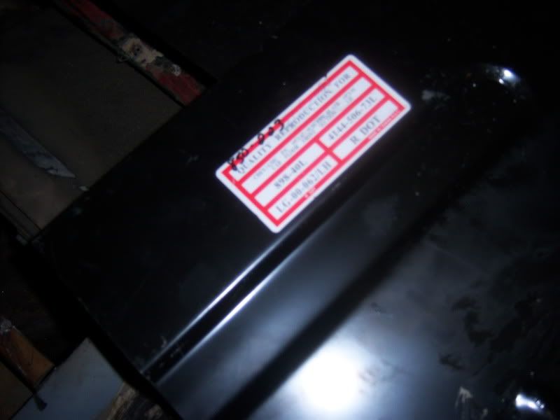

Really!  Was it labeled 0850-223?  Did it have the backing plate?
This one would have laid in the hole:

it has 850-223 wrote in black marker
and got the driver side floor pan cut out and will have to make a new channel for the weather stripping it was rotted out

I will check on that pan, but it wouldn't have covered as much as you need.
