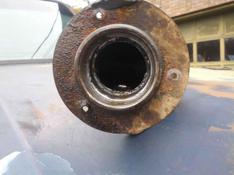

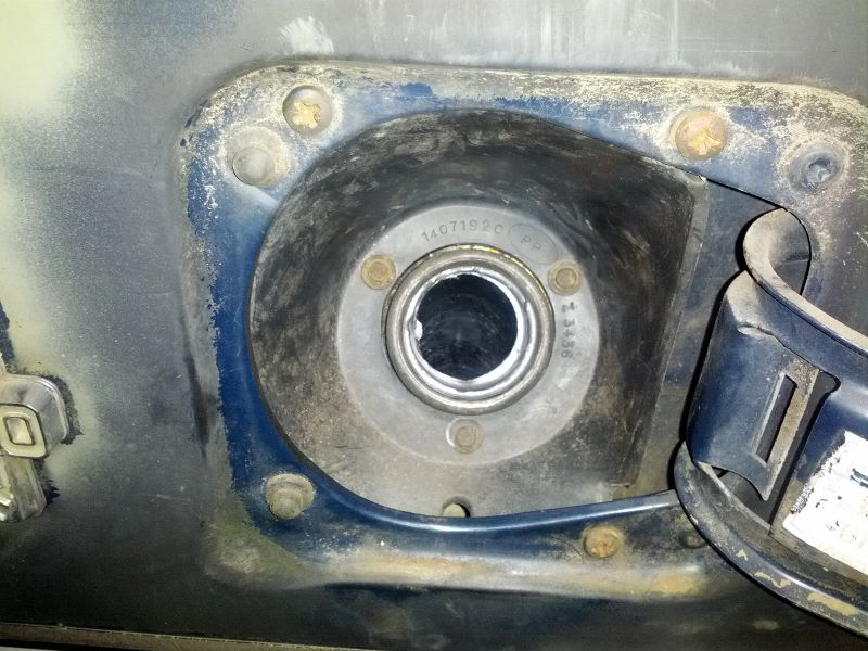

Wednesday, December 24th, 2014:
While I had it off I slightly modified the fuel filler opening for the diesel nozzle.

Friday, December 26th, 2014:
Connected the fuse bulk head back together.
Reinstalled the tank:
Reinstalled the full filler neck.

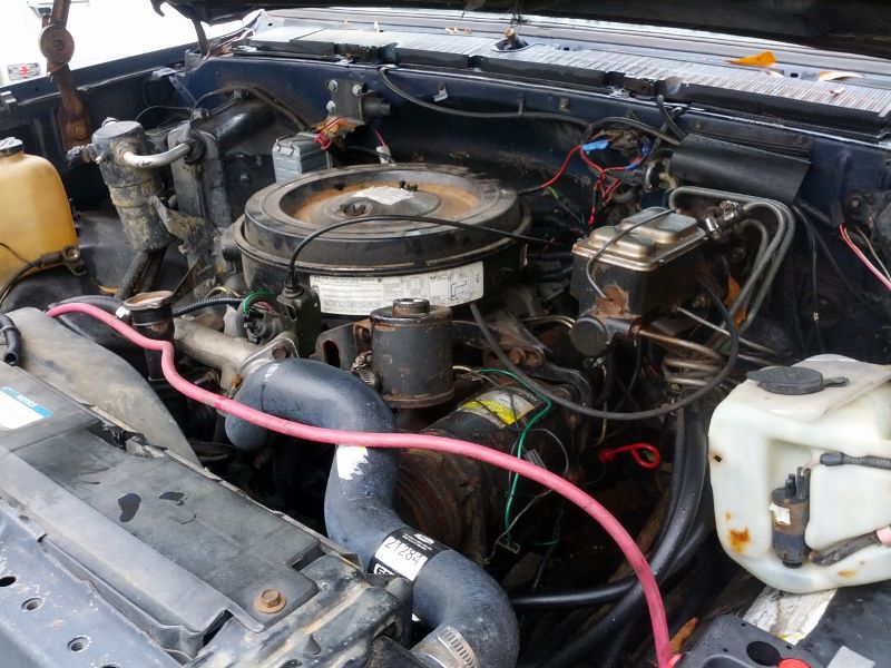

Monday, December 29th, 2014:
Installed the new batteries and cables. Was only going to validate the wiring so I only hooked up one battery. When I touched it to the positive post it tried to crank the truck.

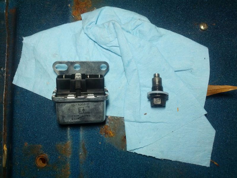

Thursday, January 1st, 2015:
Found that the prong on the positive cable was touching the S terminal of the solenoid. Moved it around and reconnected the battery. With everything hooked up the Water in fuel bulb came on and went of. However the Wait light stays on permanently. In addition, the truck won't start. Checked on the starting circuit and apparenty the starter relay isn't getting voltage. After playing with it I decided to bypass the relay and see if it would crank. While all of this was going on I drained the old oil out and found that the gasket was broken which is why it was constantly leaking.
With the relay bypassed the truck turned over. So I set out to pick up a replacement relay and a new drain gasket. I also bought 3 gallons of diesel.

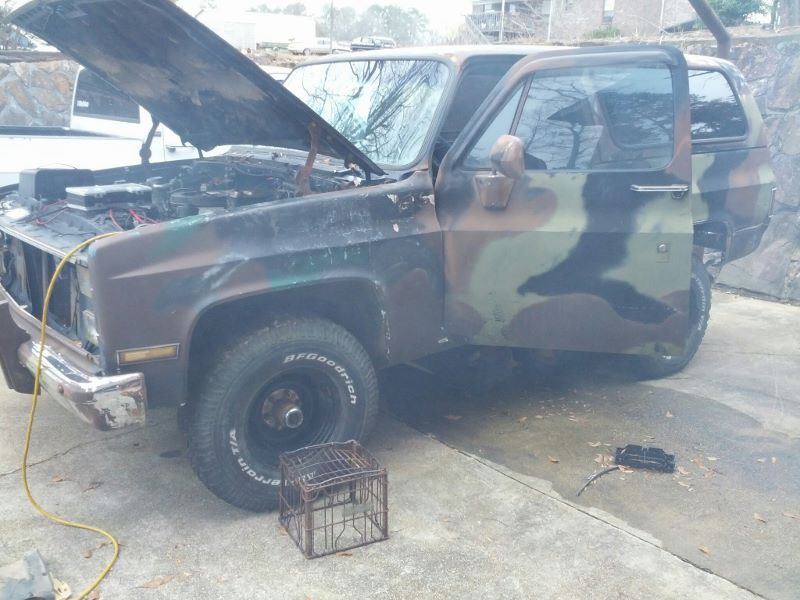

Saturday, January 10th, 2015:
with charged batteries checked the fuel getting to the injectors, check. Pulled glows for mist, check. Turned it over and won't fire. Did a quick check. Don't thin the glows are getting power. When I had one pulled I tested it and it heated.

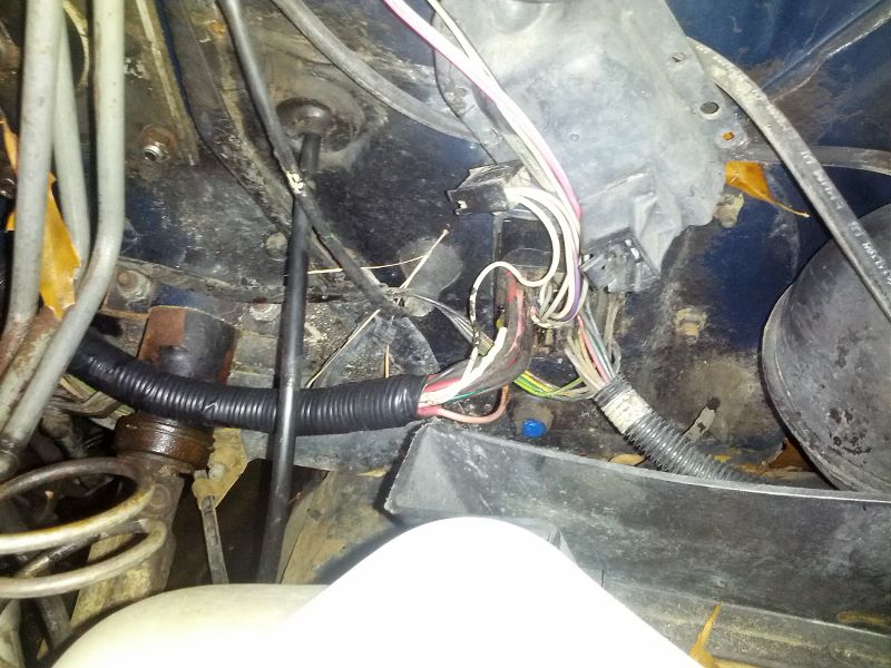

Sunday, January 11th 2015:
Found the wire going to the glow controller wasn't getting any voltage. Ran a new wire from the junction to the controller and it now runs.
