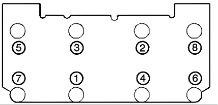

First off you're not using the correct cylinder head torque procedure. #1 torque the NEW head bolts (you can not re-use the old head bolts) to 44 lb ft in sequence. Then tighten all cylinder head bolts an additional 95 degrees in sequence.
