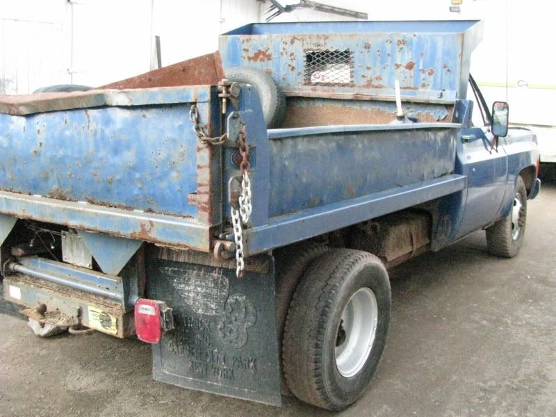

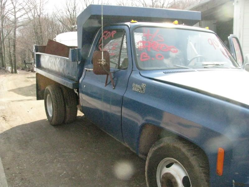

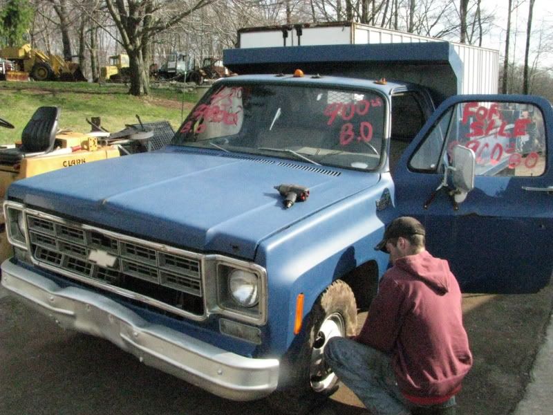

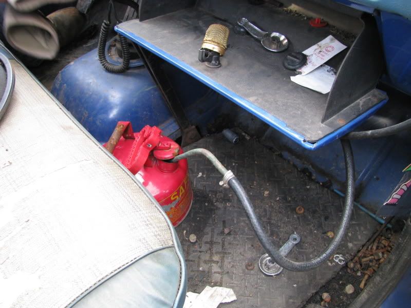

Here are pics of the 78 parts truck.Yes that is a gas can on the passenger seat. and yes that is how the gas gets to the engine.
 I don't know how many pics each post can hold so I'll just make a few more posts.

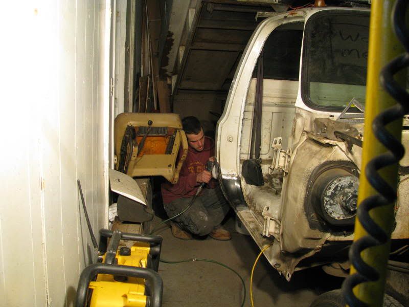

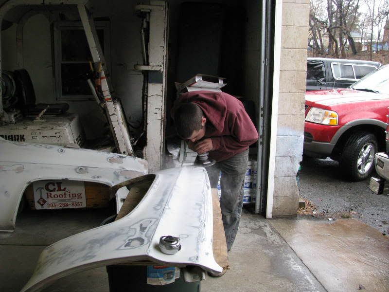

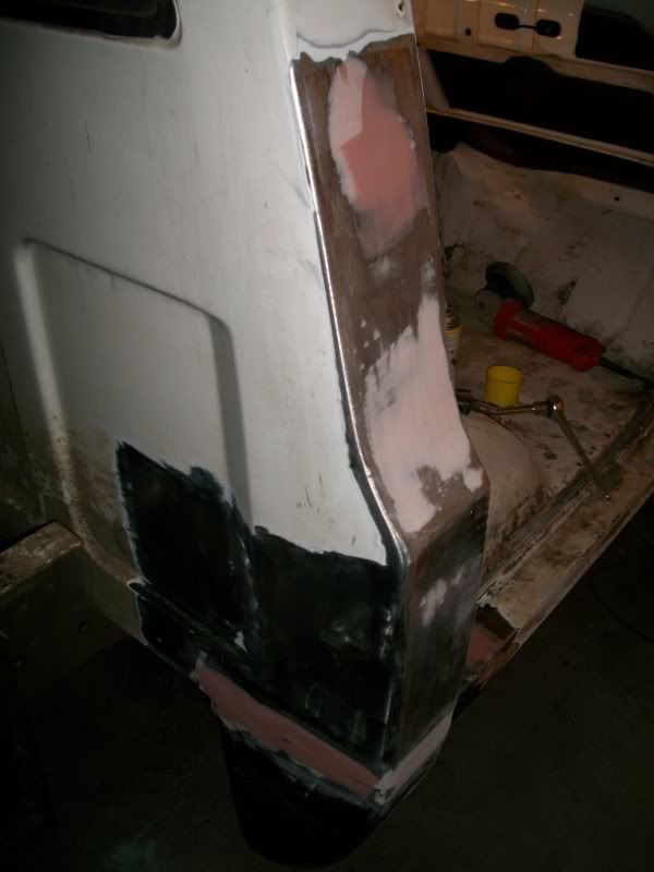

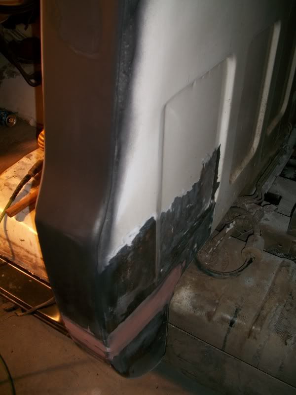

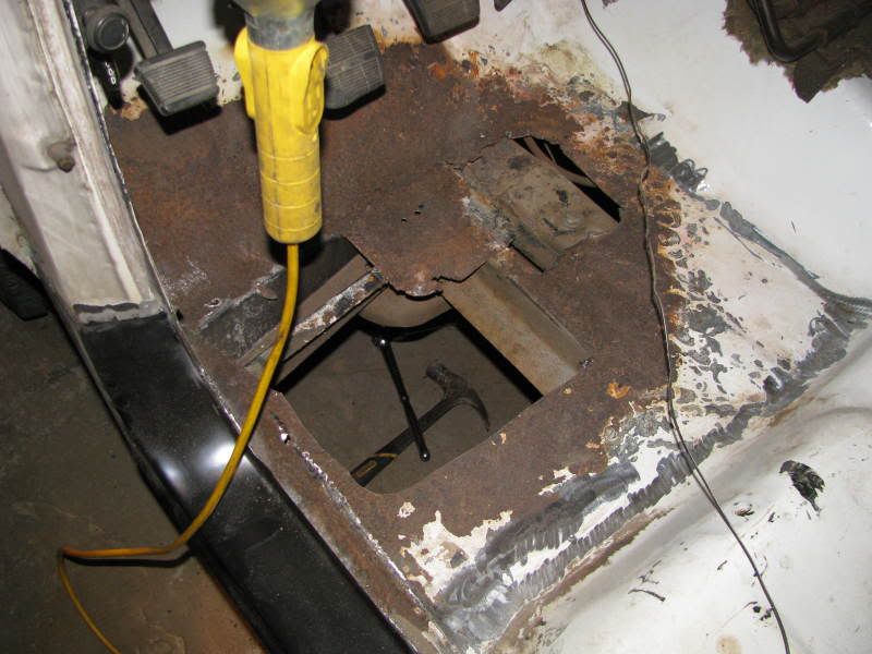

Me doing some final sanding after I finished welding up the cab corner. That is one of the bucket seats before I modified it and installed it into the truck.

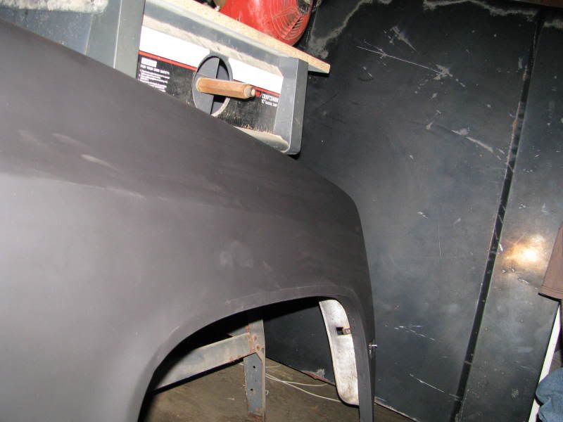

Me doin the last sand on the fenders before I prime them

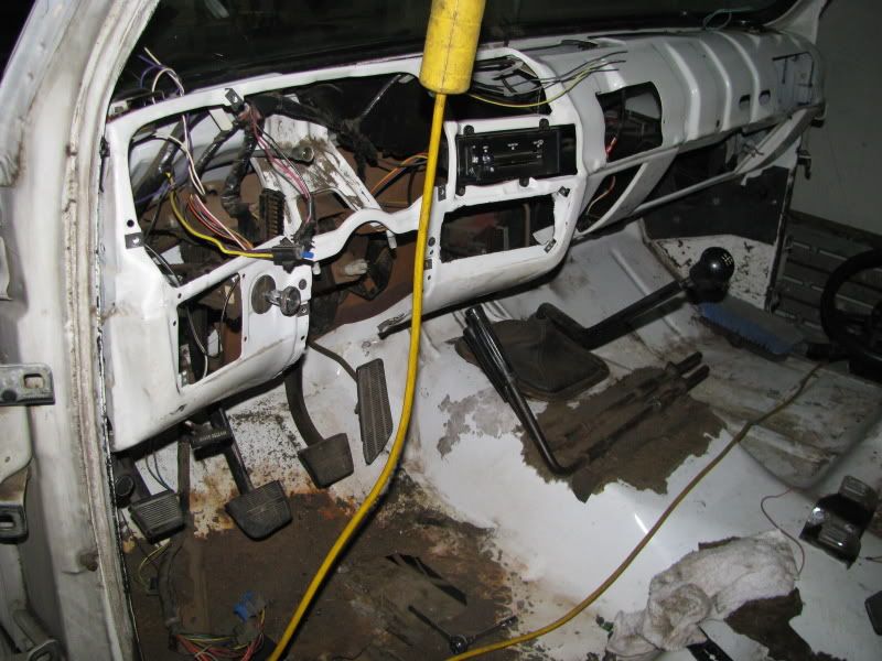

Thats the hole on the driver side floor. not too bad thats after I cut it out of course.

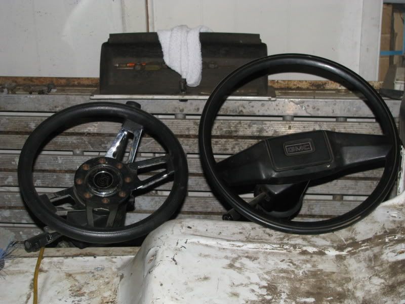

Stock straight column on the right. Tilt column on the left...i already did the swap and I gave that grant steering wheel away i put the GMC one back on.
Empty dash very dirty.

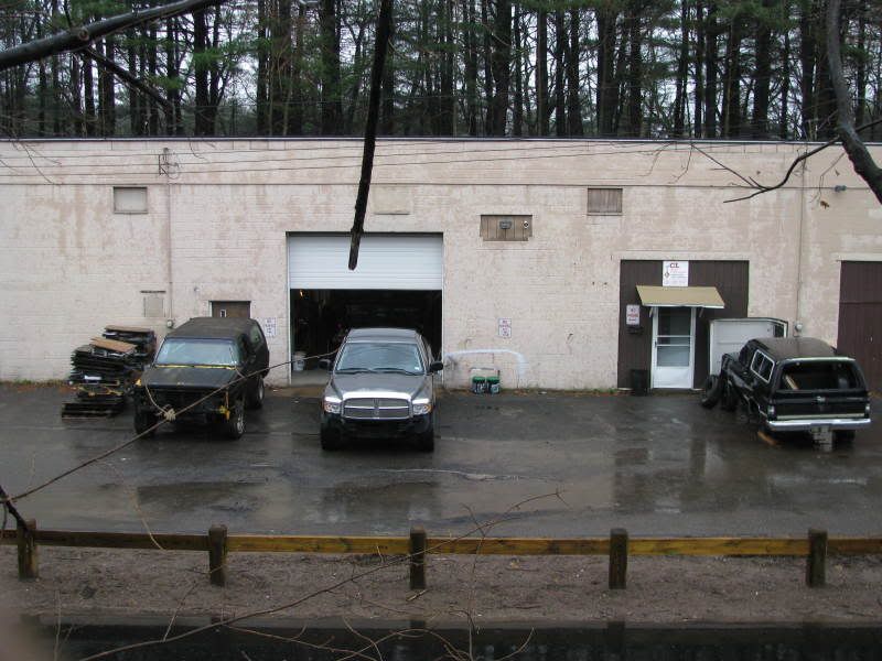

Armadillo to the left of my dodge silverado to the right of my dodge.

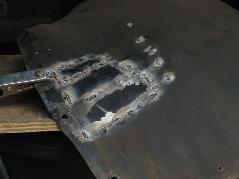

That is the better of the two patch panels I made on the wheel wells That one spot up against the firewall that always rots out. I used 4 pieces to repair it. I cut all the metal out of one of the glove boxes from one of the blazers. I waste nothing here...haha.
Ok To the left you can see a pallet sitting on top of a garbage can with tools on it...thats workbench #1 Workbench #2 also known as my body work table is a small piece of plywood ontop of a garbage can as well...Sometimes I use the tailgate of my pickup too.

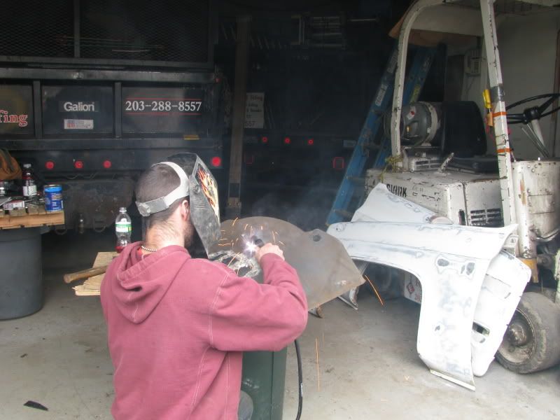

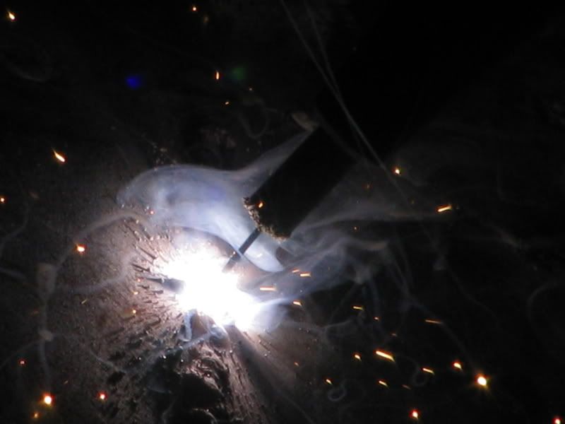

My buddy is a photographer and takes really cool pics. This one came out especially good. Back when I first started welding last week using flux core wire. I have recently upgraded my welder to use 75%argon25%Co2...I'm a learning.
Ok so thats a bunch of pics for now I need to buy a camera instead of using my buddies everytime i need it. Today I finished up bth bucket seats and got the headliner nearly complete hopefully I'll get to the store tomorrow and get meself a digital camera and take a whole ton of pics and post them up. hope you guys enjoy I will keep you all posted as I make progress.

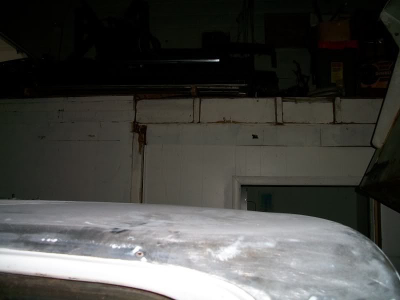

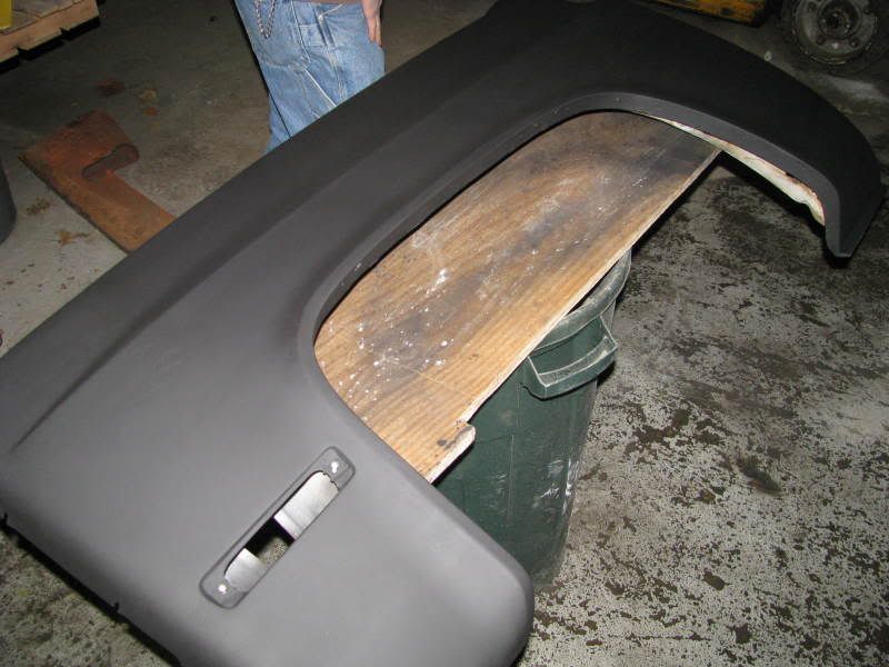

Found some pics of the fenders when i finished the exterior of them...i still have to do the engine compartment side of them... I did 1 coat of primer wet sanded with 400 grit did a second coat of primer wet sanded again with 400 then i did a 3rd coat of primer and didnt wet sand it again but i plan on 1000 grit sanding the 3rd coat
i'll get some pics taken of the interior that i made tomorrow. i finally bought myself a camera. so i can take tons of pics...haha

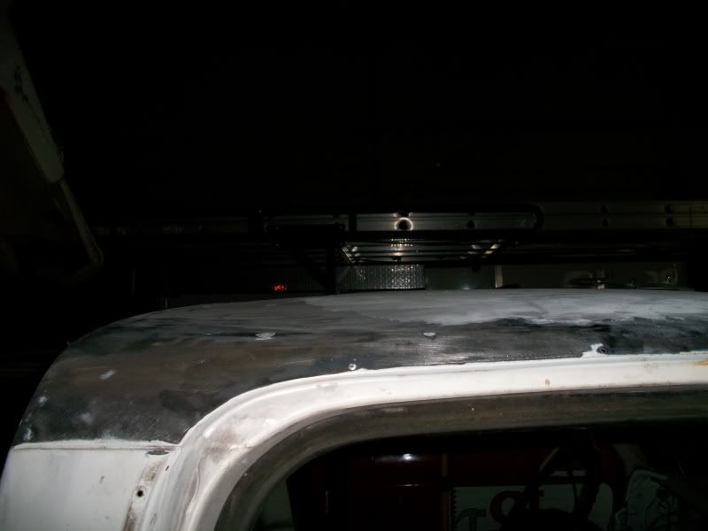

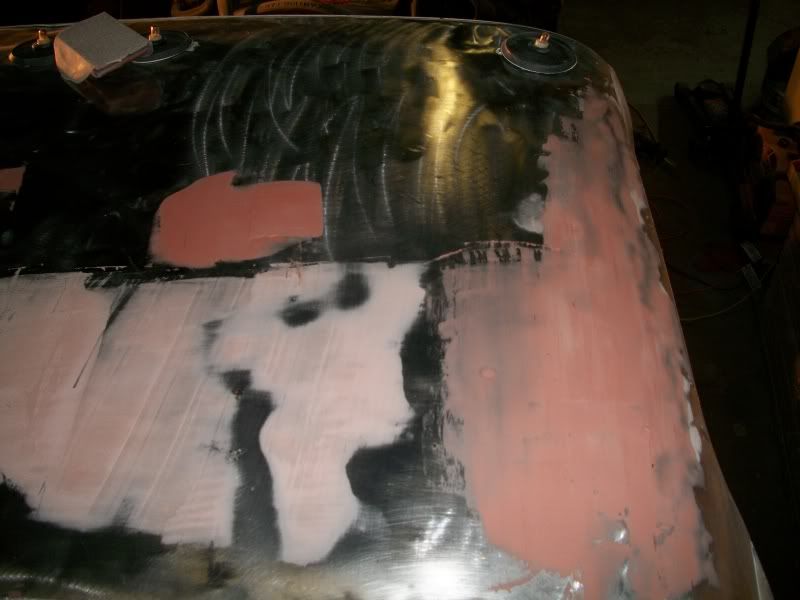

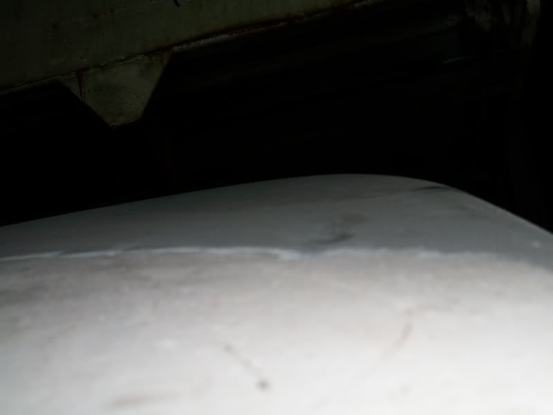

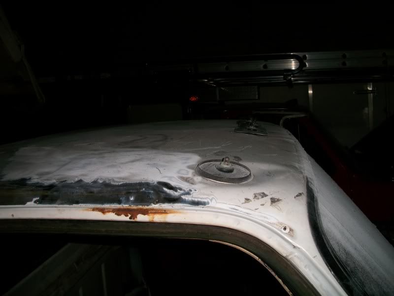

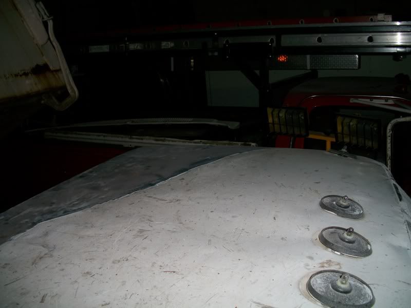

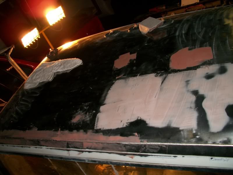

Ok well i'm up in massachusetts for the weekend with my girlfriend on her laptop to make a quick reply so i can't post aby of the pics but I spent hours banging and pulling yesterday and spent a few hours today doing some finishing touches and i got the roof its shape back. I looked through a couple auto body books i had and a few my dad had and got a few ideas. I heated it up with my blue paint stripping pad on my grinder and pulled a  little tapped a buunch and just kept repeating. then to get the big dents out of the center I "carried" a bunch of the metal from the seam above the back window and pushed it towards the center. Then carried more metal from directly above the doors towards the center. And I watched the center slowly pop itself out. Although now the roof is littered with tons of small dents its much improved over what it was. Its to the point where I can bondo it and call it done. I had the body guy I know come to look at it and he said I did a really good job for something that difficult. So that made my day. Can't wait to get it bondoed and primered then i can really see what "shape" the roof really has. Other than that I bondoed up all the seams for the rockers and cab corners today and left it to harden till sunday when i get home. So Sunday I will have a ton of finish shots of the roof.

Ok I came back i sanded down the roof and all the cab corners and rockers, I did another coat on the cabs adn rockers gonna get those sanded tomorrow hopefully then those will be all set and finished for bondo. i recoated the passenger side of the roof and started on the driver side. I sanded down the second coat on the pass side and it was close to good. i 3rd coated it and let it sit. i did the 1st coat on the drivers side and let that sit.im not gonna get crazy with the roof because id go through just too much bondo and i'm not horribly worried about it. so long as it looks good where the edges are that people see more often and the drip rails sit fit i will be happy other than that...here are a few pics of the roof before the 3rd coat went on.i havent even gotten to the middle of the roof yet...hahah.
