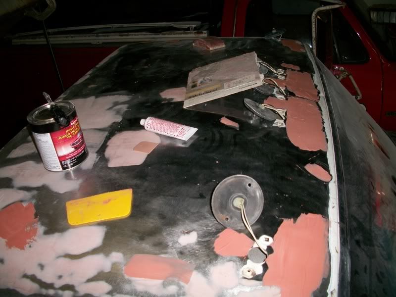

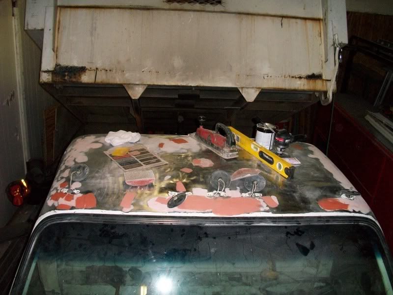

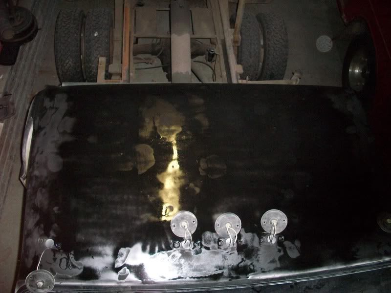

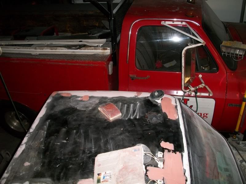

Ok I forgot to post this up earlier...i really didnt get much accomplished today well i did and i didnt. I got 3/4s of the back of the cab roughly sanded ready for primer and I resanded bondoed again and sanded the roof. Now Ive made it almost full circle around the perimeter of the cab. Passenger side is dang close to done i did a few touch up spots I need to sand tomorrow and that should be case closed the back of the roof is done I did the 3rd coat of bondo on the driver side and it looks real good need to sand that tomorrow. and I made my way to the front. Hopefully I can get away with sanding the front tomorrow and just doing some touch up. I mixed the front bondo a little softer so it would take plenty of time to dry because I put it on a shade thicker than I should have. So hopefully just touchups on that and I'll be good to go. Im not even going to bother with the middle cause its not too bad. Hopefully you guys will get some pics tomorrow with the roof and the back of the cab in primer...that would be delightful. Somehow I don't think that will be happening though because I still need to buy a gun air dryer and all the other necessities to paint so...who knows. Here's a few more pics.

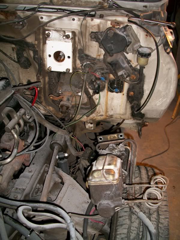

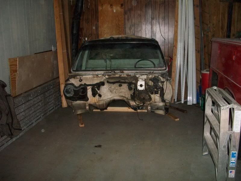

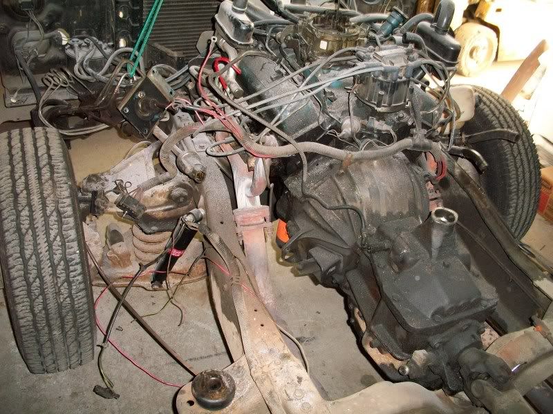

Lets see...where to start for today. I got a ton done. First thing I sanded the bondo down i put on last night and decided to primer it up. cause staring at shiny sheet metal makes it hard to see all the bumps and ridges. I primered it and it looked decent a few small spots that need some work but I'm not going to go crazy with it. Then I set to work disconnecting everything from the cab so I can take the cab off.Hardest things to take apart were the linkages for the PTO and the emergency brake cable those 3 little prongs are a $#*(). Oh and I finally figured out why my speedo stopped working a handful of years ago. When I uncoupled it from the trans i looked in it and I couldnt see anything...the little squar end got twisted off and was in the speedo gear end. I took it out and forgot to take a pic of it. I will get that and show it up here for you guys. Other than that everything went well. I didnt have anybody available so the cab stayed on. I would have prefered to have someone lend some eyes if i missed disconnecting something. We will see if i can get someone for tomorrow. So I called it an early day from the shop I left at 4. I went home and fired up the drivetrain donor truck the old 78 C30. pulled that up to the barn and set to work disconnecting the engine and trans. I got everything disconnected I just gotta take the PTO off and pull her out and get the engine on a stand so i can freshen it up. Has some valve noise well not some its actually pretty loud. Im gonna see what I can do with that do the timing chain oil pan and valve cover gaskets rear main seal maybe a camshaft depends on what kind of can of worms I open when I start looking into the engine. Here are a few pics.

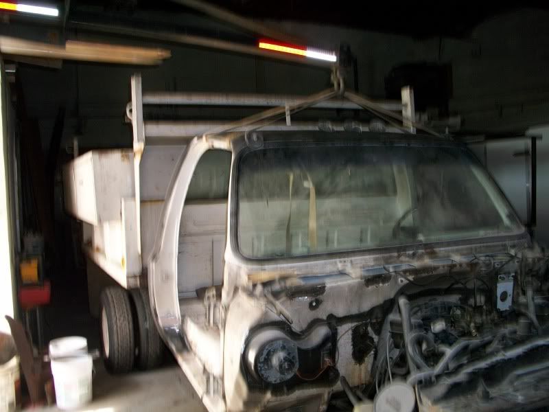

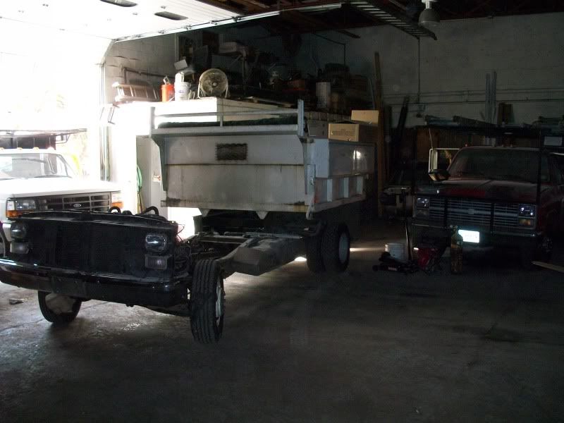

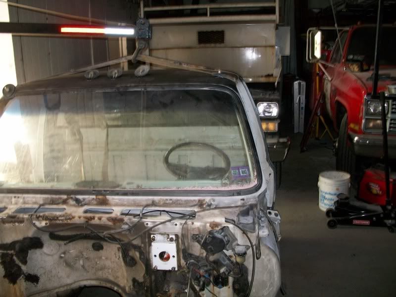

alright everyone. I got much accomplished today.I posted about my critical engine dillemma on the engine thread. Check it out some pics are over there. To sum it up i moved the engine today and i grabbed the crank and went to push it into the shop and the crank moved...moved about an 1/8 of an inch so i may be getting in much deeper than i wanted to with this engine. either way it has to be done right? So after I screwed around with that till lunchtime i left went to my shop and pushed my c30 around got the cab off pushed it around some more figured out i didnt have enough room to move the forklift around the truck so i had to move the truck again. That freaking truck is really heavy when you gotta push it around...Nonetheless I got everythign moved situated and happy. So i got plenty done today...here are some pics of the move.

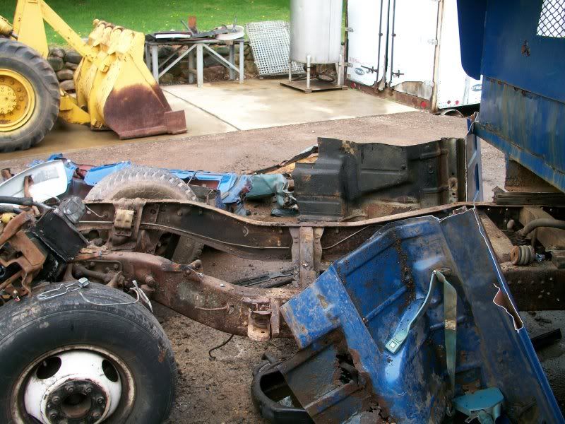

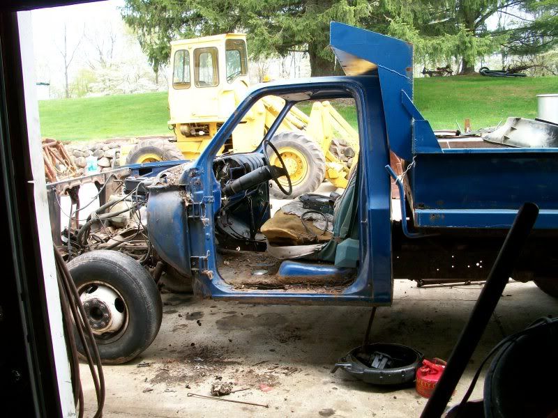

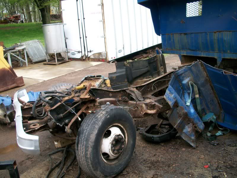

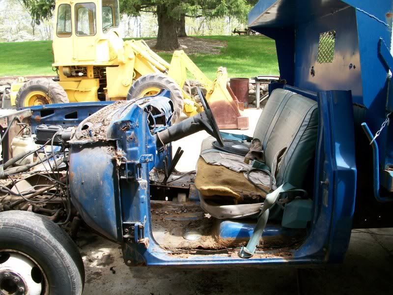

Ok over the last two days I havent even gone to my shop to work on this. My parents are away for a week so i brought the 78 donor dump up from the woods and chopped it up. slavaging whatever I could scrapping everything else. Here are some pics.
Ya i lit the seat on fire so i could scrap it. haha.
