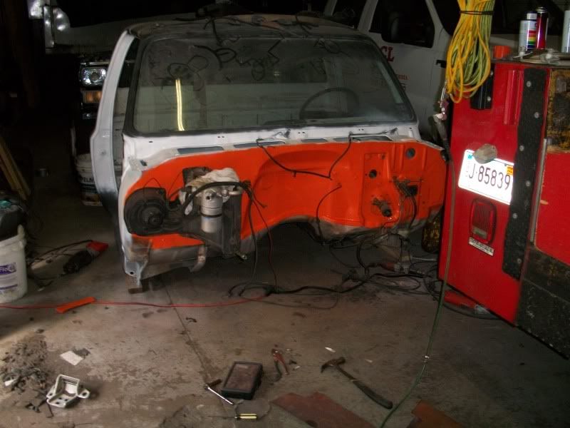

I already started haha, doors are gone passenger fender and wheel well already went to the scrap yard the dash has been gutted and the cap was chopped up yesterday. So its already begun. The only thing that really sucks is the fenders are in really good shape but the interiors where all the bolt holes are are all rusted out or broken I was kinda upset when I started taking it all apart. I woul dhave liked to save the fenders but no big deal.

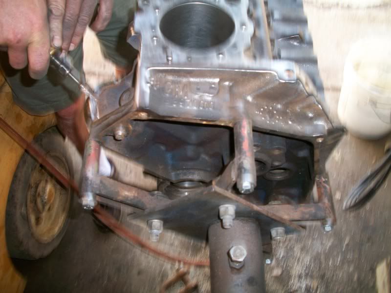

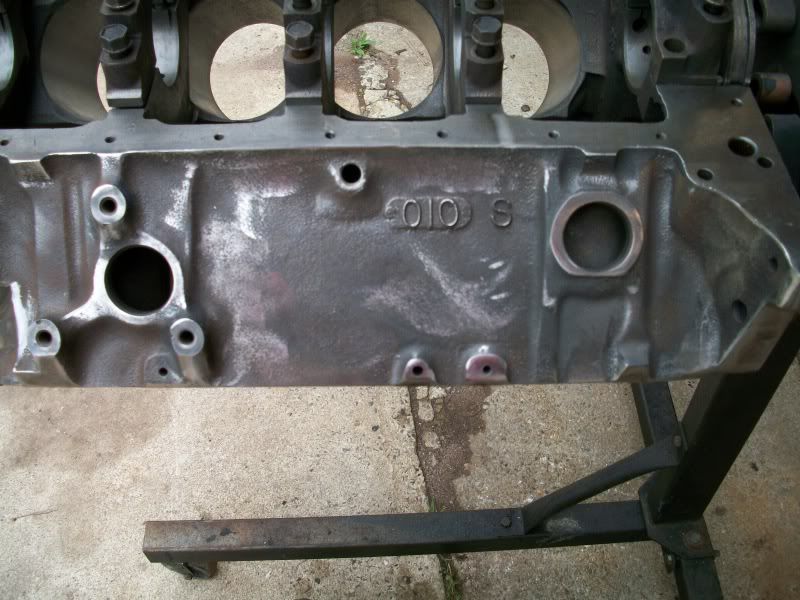

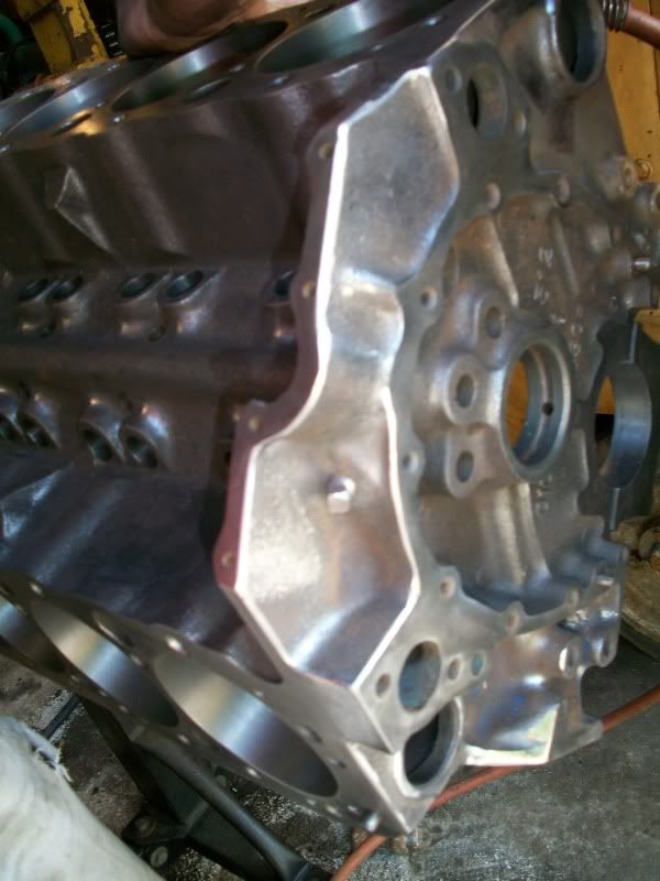

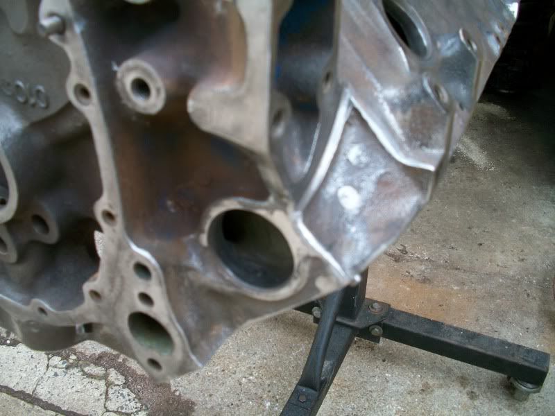

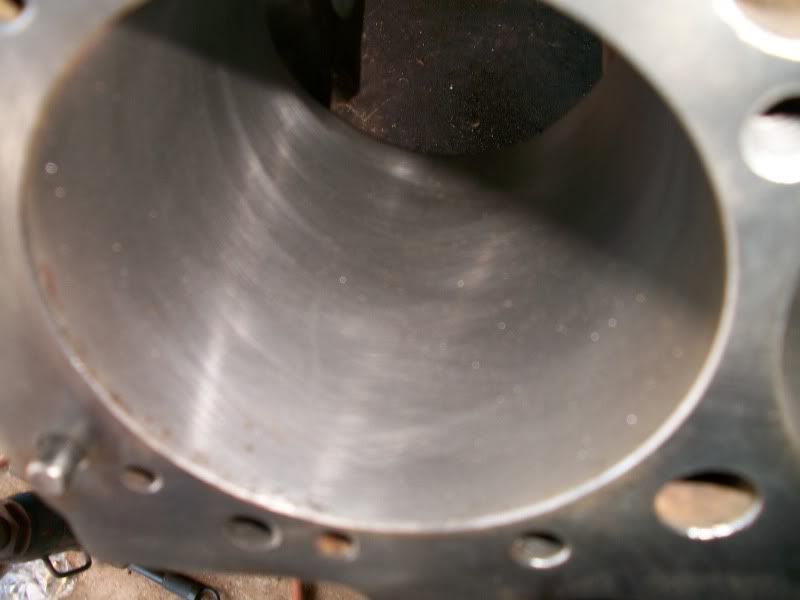

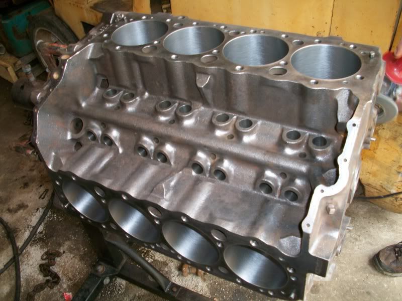

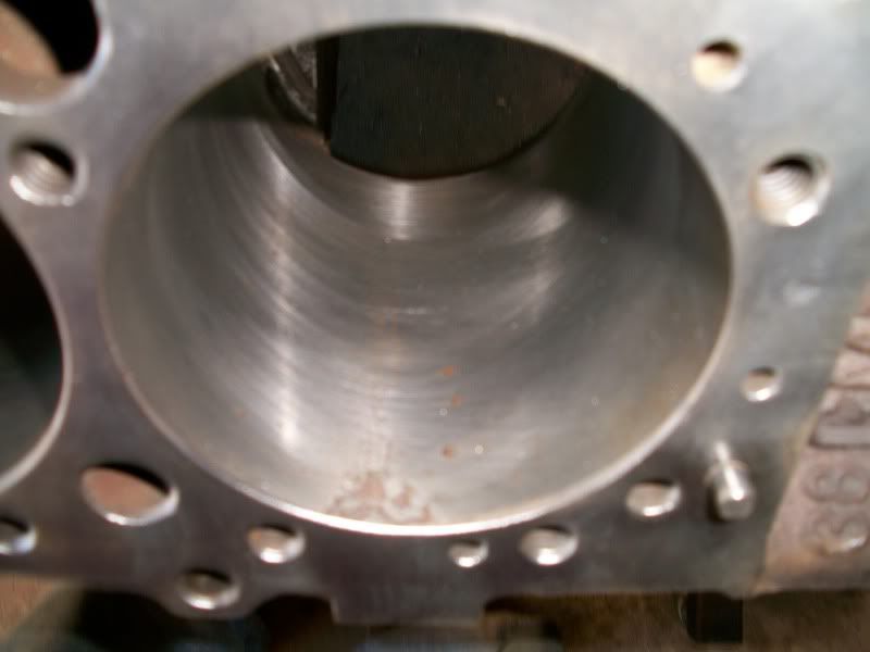

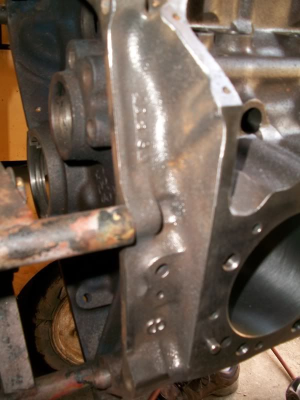

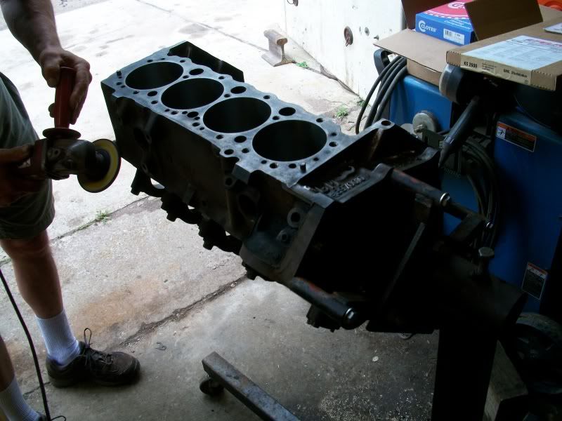

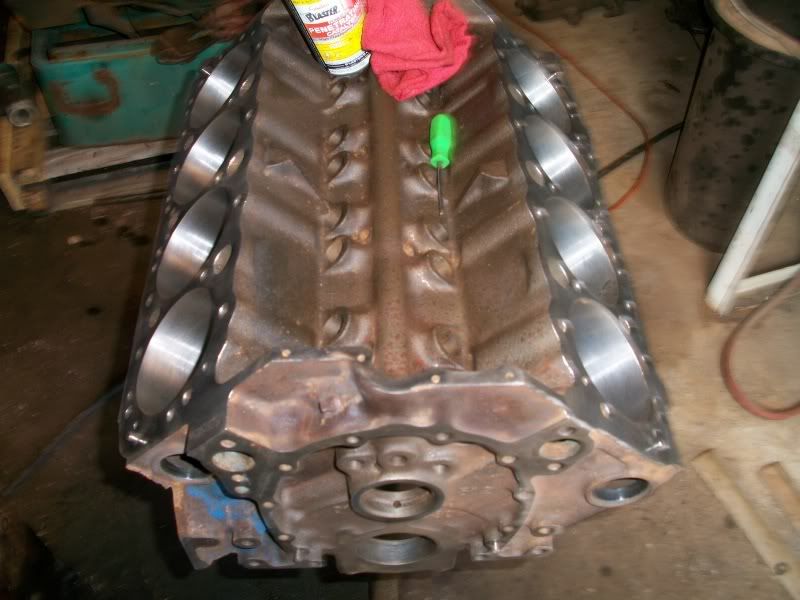

Wow another connecticut guy, haha well I should have every part I need I bought 3 blazers and a 78 c30 for parts so I should ahve everything. Either way todays update. The engine build has begun!!!!  :) ;) :D ;D :o 8) Ya. Well we put the engine on the stand and due to me leaving it my truck for a day while it was raining and driving around the bag ripped and the enigne got a bit rusty...my fault my dad was pretty mad about that. But nonethe less I cleaned the whole thing wire wheeled it and today me and my dad relieved it i guess was the term he used. We ground down all the slag and nasty crap on all the edges and rounded everything over opened up all the holes that were rough and nasty smoothed it out nice. Rehoned  it and then washed it. Washed it up we put in the new cam bearings then the plugs and the main bearings and got the crank in. So tomorrow I should be getting the piston rings installed, pistons in timing gear on the crank and then I think I'm going to get the heads cleaned and relapped or whatever they need while I wait for my camshaft to come in. I should be getting it from Summit on the 25th or 26th so that will give me plenty of time to get the rest of the engine assembled. I'm waitin to find a good deal on a edelbrock performer 2101 on ebay cause I really dont want to spend the $127 on a new one. Used ones are going between $60 and $95 shipped so I would rather go that route. Here is a link to the cam i bought, should do the engine good, I was thinking about a Lunati Voodoo cam but the magazine showed that is was used for idle to 5500 RPMs and when I went to order it the specs said 1000-5500 so I didnt get it, maybe something was messed up I don't know. either wayt I will cut to the chase and here are some pics.
http://www.summitracing.com/parts/CCA-CL12-231-2/
Rusty
Got the radiator support mounts in so i just had to install them...haha
freshly cleaned wire wheeled and re-honed
grinding and reliefing
There ya go guys, as I get more pics I will post them up. shoudl have more install stuff tomorrow. when i get the pistons and the lower end in.

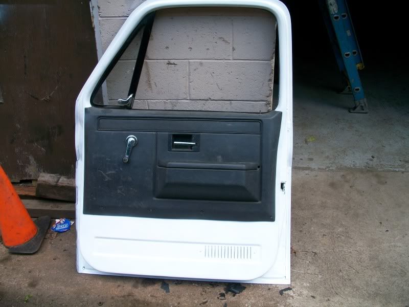

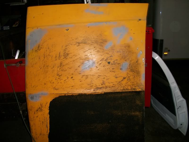

Got more done today and yesterday. Been busy as heck lately. Got the crank in the other day I installed all the rings yesterday. I got the cam in today so I should have that installed tomorrow. Today I got the pistons all in. I didnt torque them down yet. I just finished putting them in about 15 minutes ago. Also I got the doors off the blazer that someone had rhino lined...ya i said rhino lined. I finally got those stripped down i fixed the dents did a bunch of bondo work to them sanded them down primered, wet sanded primered again and thats as far as I got on those. Tomorrow I want to get the interior side of the doors scuffed and painted white cause they are black right now. then I should be able to reinstall all the guts for the doors and put them in storage untill they are ready to get put onto the cab. And if all goes well I should get the whole interior of the cab cleaned and scuffed and repainted. So its gonna be another busy day. I will get plenty of pics uploaded tomorrow for you guys.

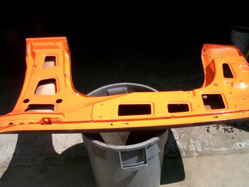

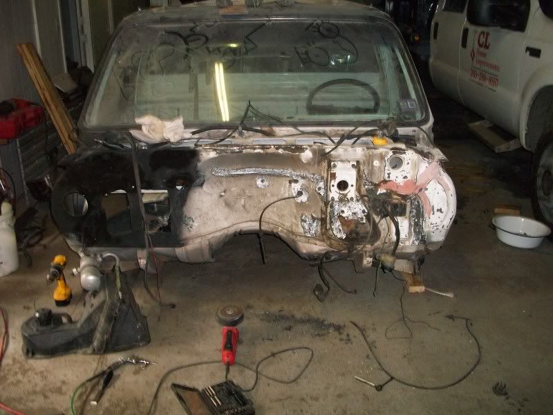

Wow, well its been a long time since I've posted here. Sttill laid off so I'm still working like crazy at the shop trying to get the ttruck done. Since my last post I will just sum everythign up real quick and get a ton of pics up. I had the brand new doors that were rhino lined off one of the blazers I scraped them both down sanded them did the body work welded the window mount holes and cleaned everythign and reassembled the whole door. just gotta wet sand them and prime them again. Took the fenders down from upstairs and sanded the inside of the fenders and painted them orange. So the fenders are all complete now just gotta wait for assembly and there is nothing left to do on those. I rolled the truck  frame out grabbed the cab and brought it out front cause I'm pretty much done with the frame untill the engien is ready to go in. And sadly I pretty much gave up. I am tired of working on this darn thing and it is starting to show. I'm starting to get sloppy. The firewall especially mad me real mad all the welding and cutting and bondo work and i kept finding more rot. Finally I gave it i scuffed it and painted it. There were a lot of spots that I put patches in that needed to be ground down and bondoed that I just didnt do cause I didnt want to. Sad to say it. I will regret it later on. I know I will. When I started painting the cowl and firewall I didnt even tape anything off thats how bad it got. It was a bad day I think. But either way I got the A/c box on everything bad and attatched to the firewall and that part is starting to look like a truck once more. I got a set of those fender silencer things. That mount to the side of the cab. I got them off the 85 Silverado blazer so I decided to stick them on my truck. Lets see, I cleaned and sanded the whole inside of the cab floor and whatever would be visible when the headliner and everything else was on and painted that. I oredered up some dynamat got that installed put the insulation stuff down then that crappy floor mat I got from  . it ahs cracks all over where the back of the trans tunnel is. But whatever. I cleaned up the dashpad put the AC stuf in it got that installed. Sent the seats out to get reupholstered got them back in 2 days cost me $500 for both.  And man they are comfy. When I got them back I immediatly mounted one up and sat in it for a few hours it was great. I got all the plastic and metal headliner piecess cleaned and painted black ready to roll. So much that I did I can't remember it all. I can't install the door weatherstripping or the headliner yet cause when I make the pick with the straps I'm afraid I will crush it so I am holding off on that part. All thats left for me to really do is figure out what I am doing for a stereo system, cut holes for the seat bolts and install those. Paint the plastic pieces on the doors. And finish the hood...oh the hood has rhino lining all over it too. So I gotta strip that. Lets see other than that all that the cab needs is the gauge cluster I have to finish sanding and primering the back of the cab, then roll it over and clean and rhino line the underside of the cab then that is finished.

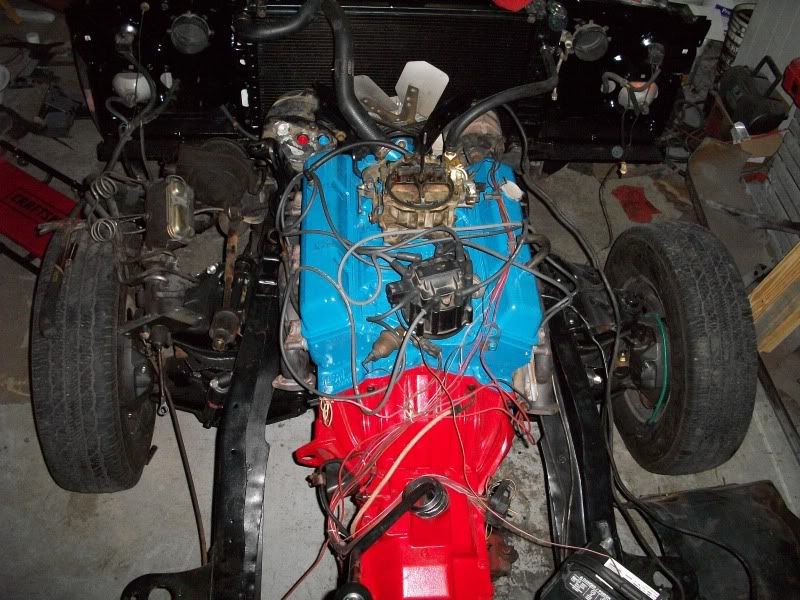

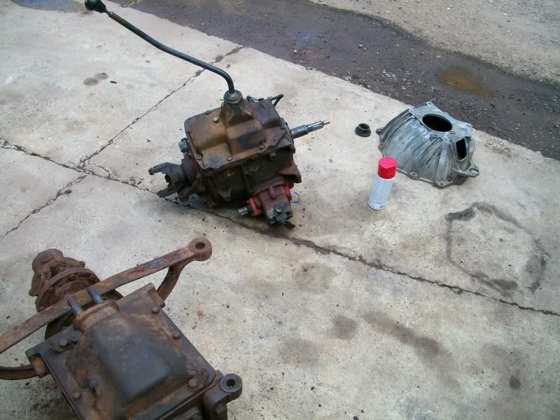

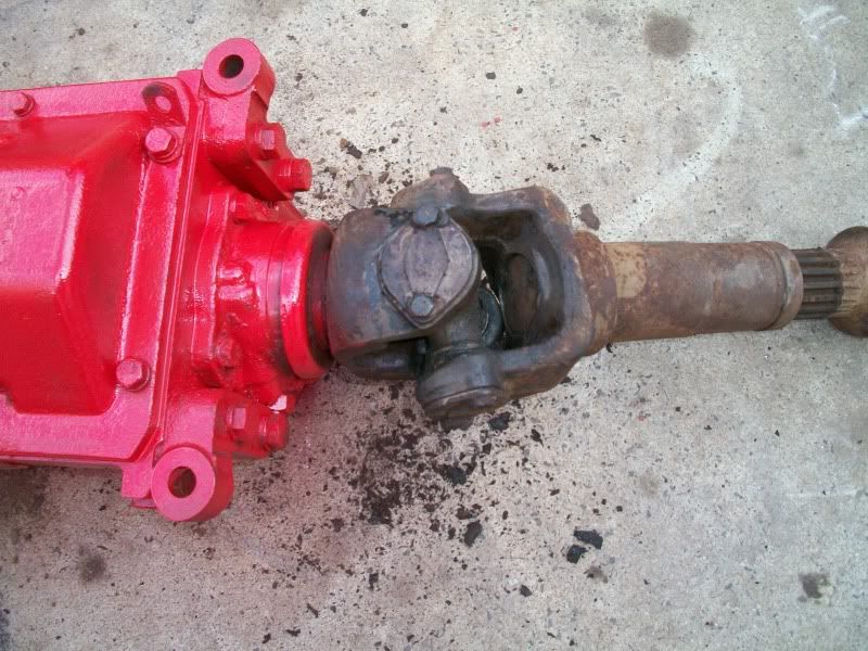

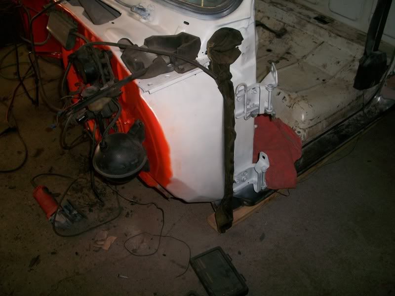

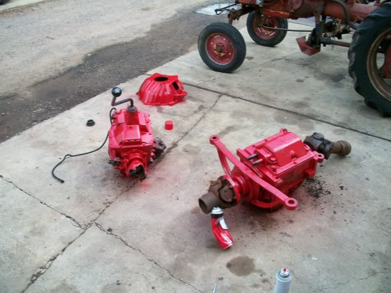

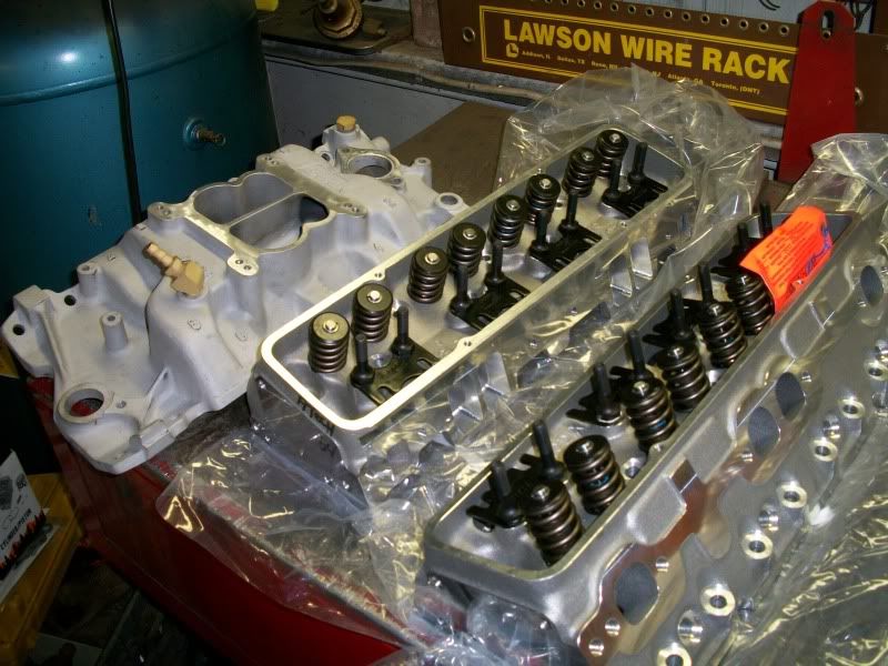

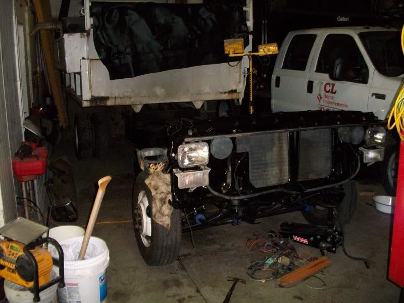

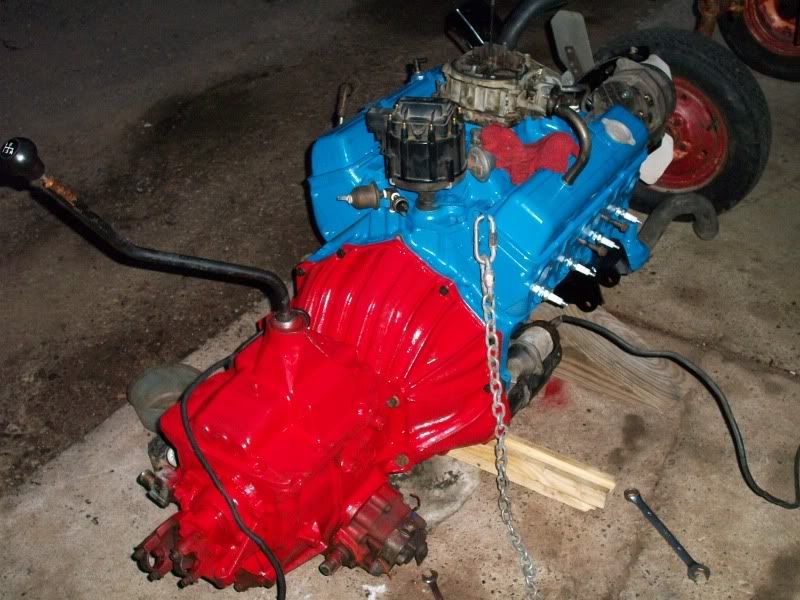

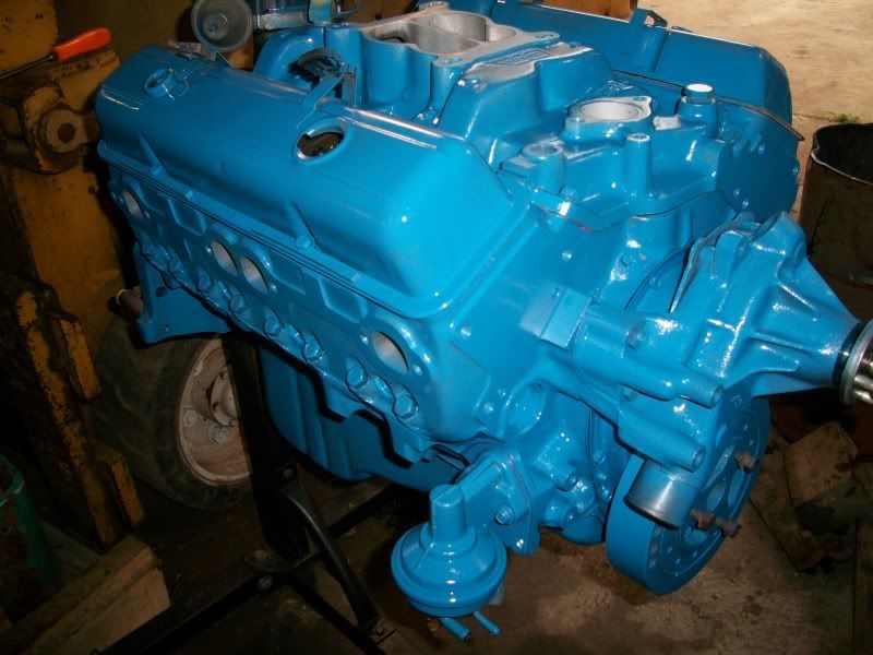

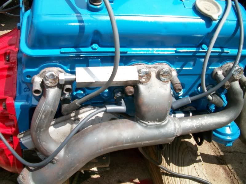

I can't believe its been almost 2 weeks since my last post in here. Got tons done. Engine is finished did the test run and oh my gosh what a wonderful sounding engine. I went with the GM corporate blue for the 78 engine, and since the transmission never had a color I took the original color from the auxilliary trans and made both red. I sand blasted the exhaust manifolds and welded up the AIR holes and luckily I had 0 leaks anywhere until yesterday from my oil pan but my bolts loosened up on my. I explained it in the engine thread. Lets see what else did I do.   .   . I got the hood scraped bondoed and primered. I painted the underside and the wheel wells orange so pretty much all the sheet metal is completely finished. I moved the cab and rolled it onto its back I scraped the whole underside and rhino lined it. then i finished sanding the back of the cab primed what I couldI only had half a can left. So tomorrow I just need to finish primering the back of the cab I have to sand the driver side of the cab and paint that white and then the cab is nearly complete. I think I'm going to wet sand the roof and lay another coat of primer on it. So the only things that are holding me up with the project as it stands now, is I need to repair the original driver side tank brackets sand them and the tank paint them and install. I have to remove the passenger tank brackets from the 78 mason dump parts truck, repair those sand them paint them and sand the passenger tank mount those up. I have to order a couple fuel valves then run the new fuel lines. Then I gotta get my dad to come down to the shop at some point so I can have him help me mock up the auxiliary transmission. Oh for those of you that havent heard about it I am putting a 3 speed auxilliary transmission in right behind my regular transmission. I measured it up and it will fit under the cab before the rear crossmember. It is shorter in length than the driveshaft that goes to the carrier bearing so it should fit perfectly. Just got to figure out some hangers for it so that it doesnt hang too low. Other than that, lets cut to the chase and get some pics to you all.
The brand new top end. Brodix aluminum heads and a slightly used Weiand 8004 dual plane intake.
A very blue engine
The transmissions once i cleaned them like 3 times. Even then they still werent clean.
The transmission painted
The big U joints the auxilliary has. HAHA I will never wear those things out.
Once everythign was assembled
Couldnt find a port-a-power so I made due with a steel block and a bolt. Worked real well.
The engine on the test pallet we made, in my dodge going to my shop to get installed into the C30. Finally 3 months in the making and it will have an engien in it again.
Engine is in, aerial shot and before I put all the wire looms on and zip tied everything...it is still a horrible mess. But who cares I can straighten that stuff later it runs though.
Ok I will get some more pics soon when more major stuff gets done. I am getting close fellas. Very close. I can really see the end.

Cool.  I think that's the color I'll paint my next engine (provided I go with a Gen 1).  What heads do you have there?  IK180s?
I've been meaning to chime in on this thread to compliment your work.  As far as the engine goes, I especially like how you took the time to detail the block. 8)

Ya those are the IK180's, They seem to be pretty good on the block revving it up I can't wait to be in the seat driving it to feel the difference from one stock engine to this performance engine. I really hope it is everything i could ever want. We shall see...hopefully a few more weeks and everything will be back together so I can at least drive it to my house, my buyddies shop then the paint place.
