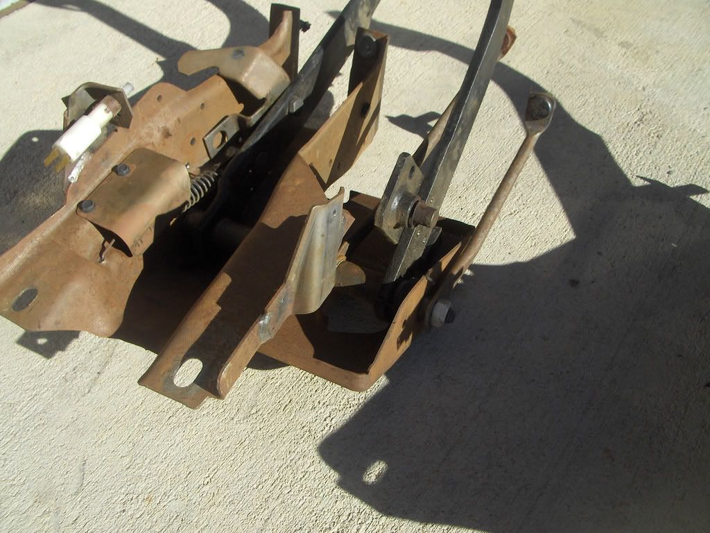

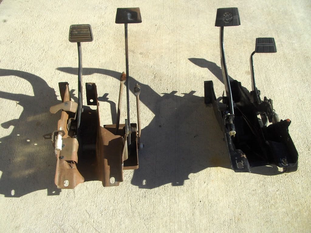

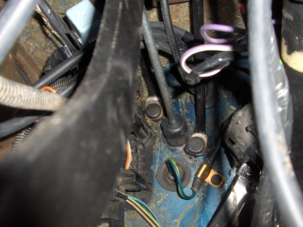

It looks as though the clutch/brake pedal assembly is identical as far as bolting into the truck. If I am right I will just have to drill the mounting holes for the clutch cylinder.
The one on the left is the hydraulic linkage assembly..on the right is the manual linkage assembly
Not my truck but this the mounting location from the inside of the cab

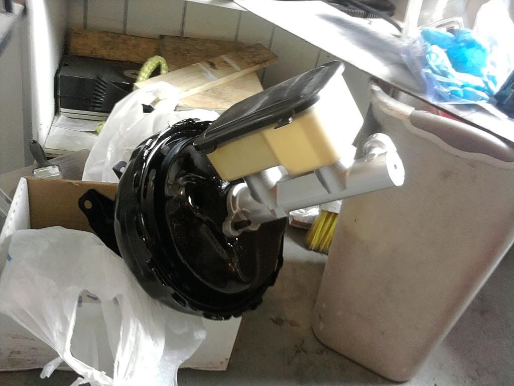

I also grabbed the brake booster and master cylinder from the 85 as it is a better looking set up than my own.
I will buy a new clutch cylinder, slave cylinder and just build a line to connect the two.

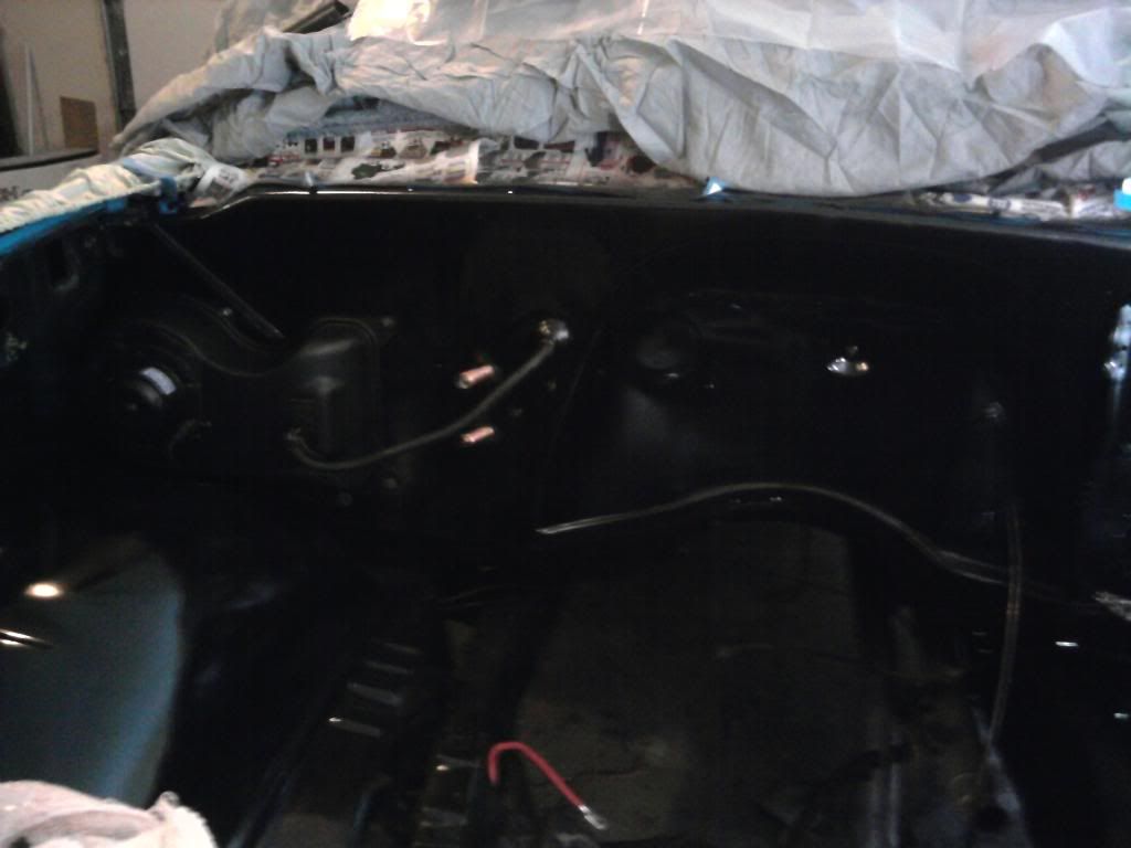

update:

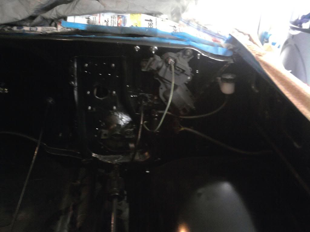

clutch pedals were a direct bolt in from the 85, had to remove the steering column to do this.
drilled three holes for the clutch cylinder and installed along with the reservoir and line.

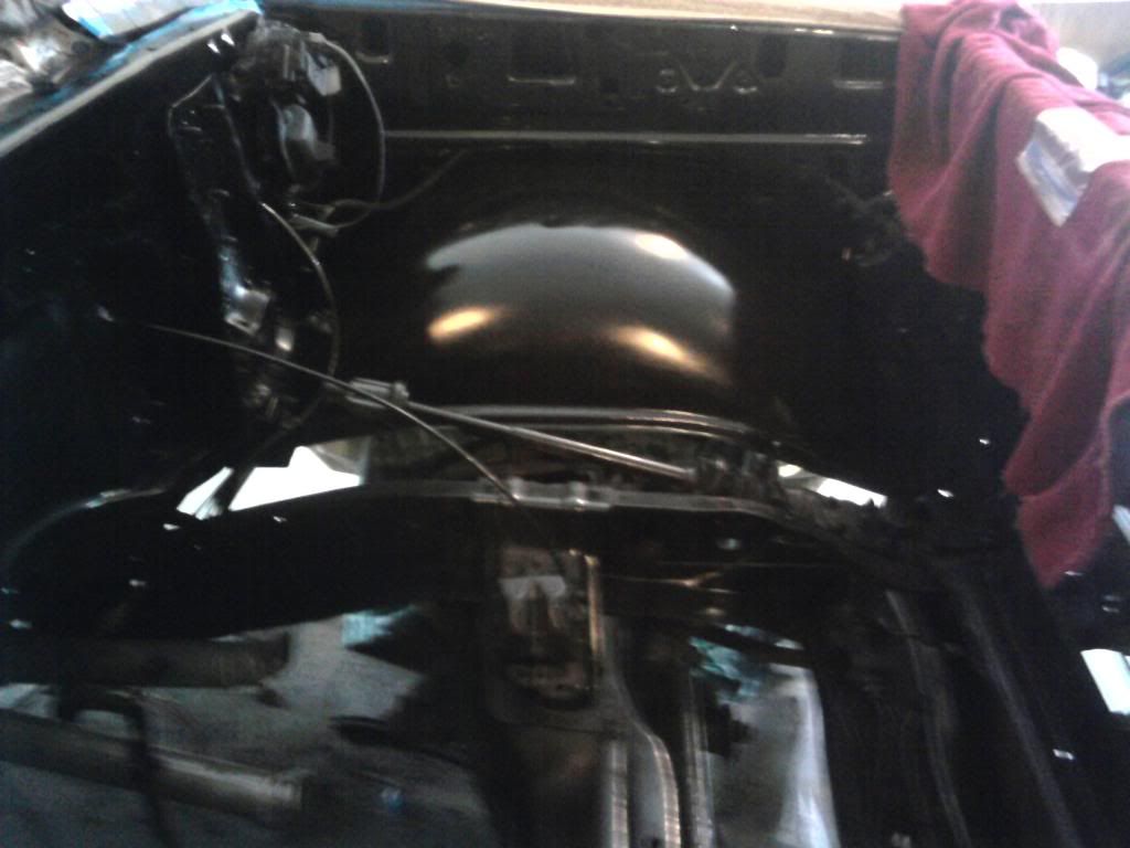

everything under the hood is painted and going back together.
With the battery installed-post toward front of vehicle. I have run my battery cables through the header panel and inside of the frame
(hidden from sight) I used a 78" pos cable and a 36" neg cable for those who may want to do this
I installed the heater box with the '94 blower motor with slight modification and the fan blade from the '80.
tomorrow I will install the steering column, brake booster, master cylinder and lines from the master cylinder.

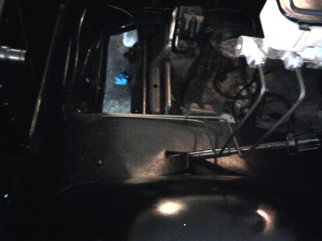

Here are some updated pics as of last weekend.
this the master cylinder and booster out of the '85

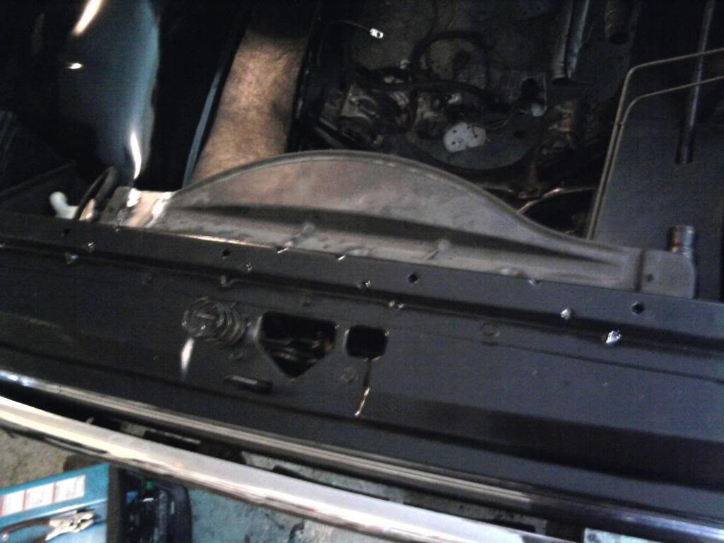

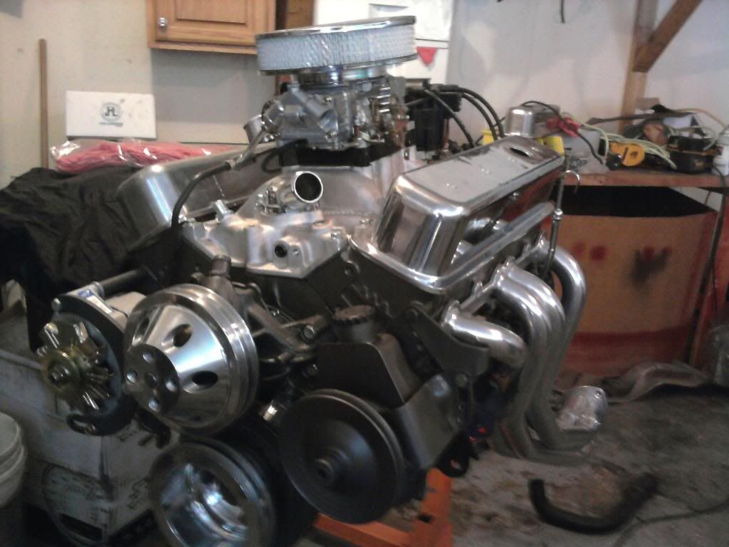

I decided today to go with an electric fan, I will install it between the radiator and grill.
I had a snow day from work today and have gotten a few things done.

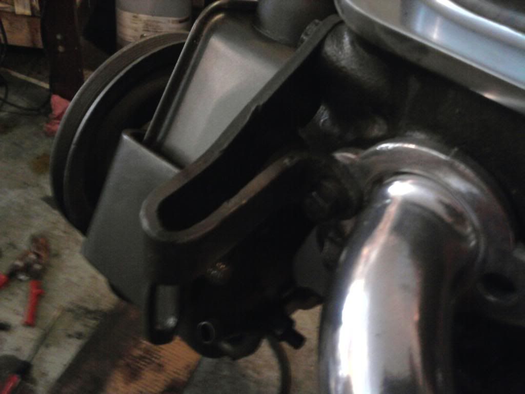

I modified power steering bracket to work with the headers. Had a ton of trouble with this; someone had broken bolt on the brackets on the pump from my parts truck and had drill and hammer them off.
here is a pic after I painted it and modified the bracket that bolts to the header.
replaced the brake lines from the master cylinder

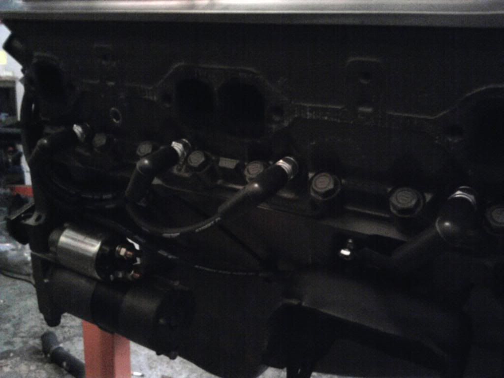

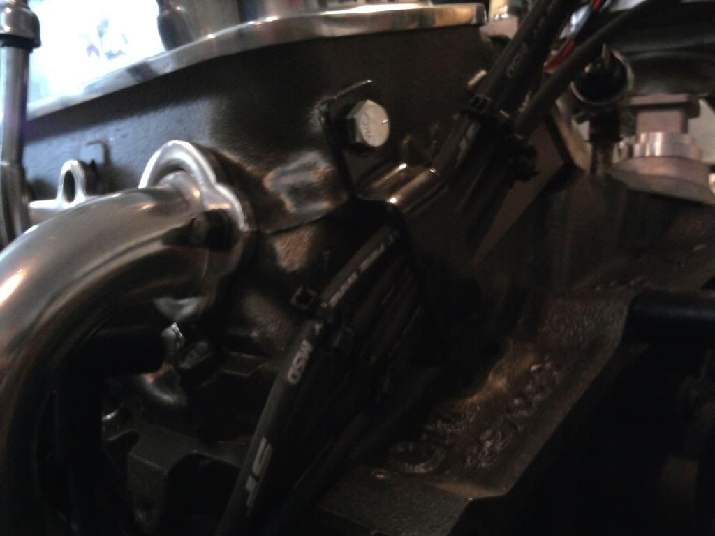

gear reduction starter and spark plug wires routing
homemade bracket for the wires
looking for opinions on this; it is the inline 6 radiator shroud stretched for the bigger radiator. Should i finish this or make something else?

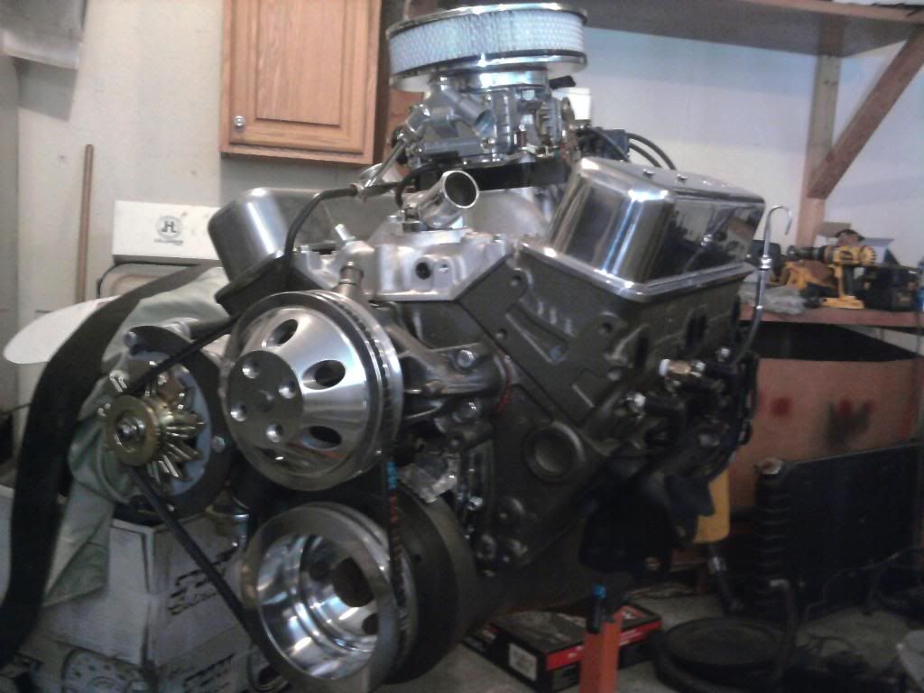

here is another pic of the engine, I will order a new power steering pully and the cone for the water pump

Excellent work on the plug wires!
Offline 1980c10
  • Posts: 1205
Re: My 1980 SWB Project Truck
« Reply #74 on: March 24, 2011, 03:34:20 pm »
Thanks, It was actually cheaper and easier than running them over the valve covers and making them look good.
My next dist cap will be a "corrected firing order" cap, that way I will be able to bring the wires to each side cleanly.
Also I decided not to run a hood cable at all, I will show that set up when I take pics of my electric fan/cooling set up.
The fan will be a "puller"
My headlight wiring is done and so are the battery cables
I am still looking for opinions on the radiator shroud
