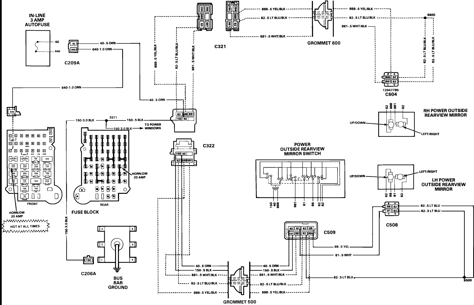

Can someone provide me a wire schematic for the power mirrors on a 1990 Suburban. My mirrors stopped working and I tried another switch and that didn't work. All the fuses are good. Thanks in advance.

May 30, 2009, 08:47:41 am »
Direct Link

Thank you sir!!!!
